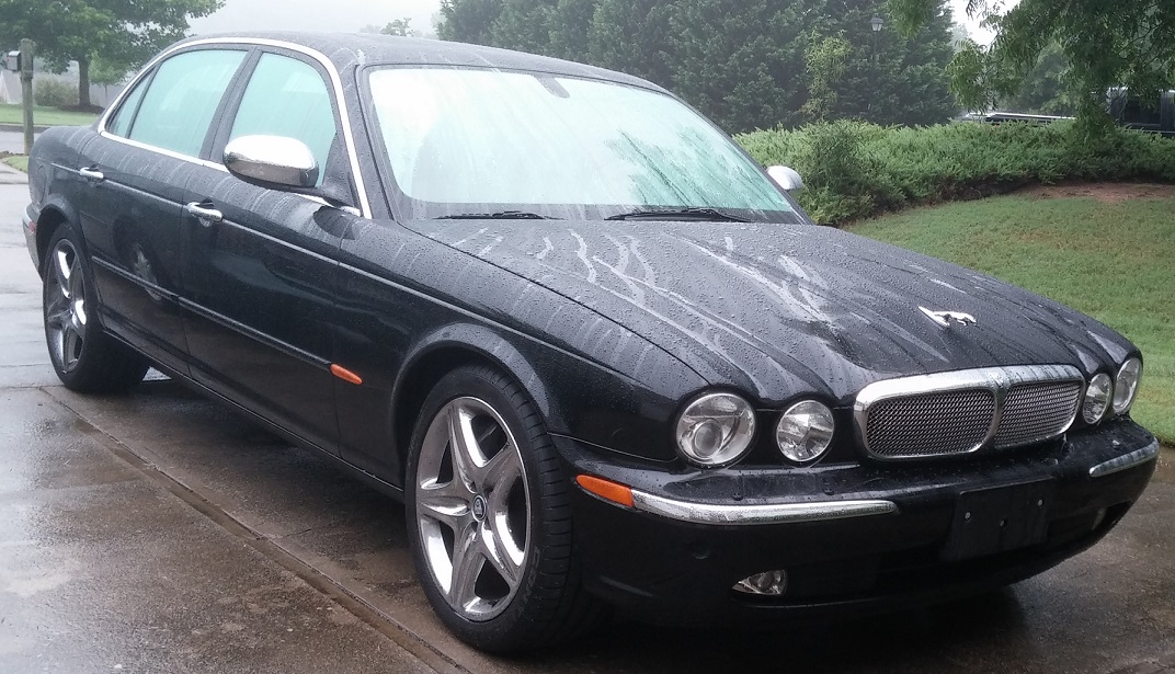

We made the 600 mile drive home without incident. I didn't trust the radar assisted cruise for the first 90 minutes, but eventually I found it to work very well and just let it do its thing. I would prefer more sportier suspension, but this car is for the wife anyway. The front felt very soft. Otherwise, it's a good driving car.
I won't post the average speed from the trip computer on this public forum, but the average economy was 27 mpg. Not bad for a big, heavy blower car with huge tires.
Went to 3 different stores yesterday, got complimented in each parking lot. That's never happened with the German cars I've owned in the past.

Hi Ben,
Congratulations on your beautiful new Cat! I know the roads between St. Louis and Atlanta quite well, and I'm confident that your average speed was well within the posted limits.
Regarding the front feeling soft, I imagine your Super V8 has the Comfort suspension, so I don't know if that soft feeling is normal and correct or not, but on our XJR with the Sport suspension, the dampers are switched to Firm when driving at speed to prevent a sense of wallowing. It might be worth starting a thread to ask other Super V8 owners if their suspensions also feel soft.
