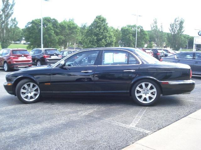

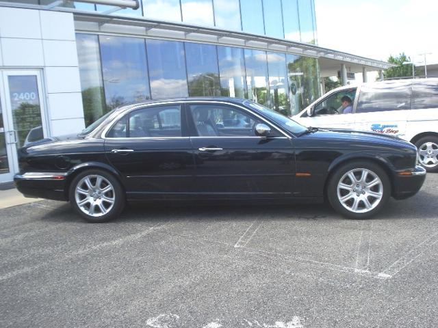

Next question. This is a pic of the car I'm looking at. Does the current height it's sitting at lead anyone to believe there is an immediate problem with the suspension?
Ride height looks ok. Maybe a little high, but that could be the tires. Yes, you are nuts for considering this if you dont like spending $$$ on inevitable repairs. Its a really nice car to commute in, though. If the price is right, pull that trigger. Good luck.
