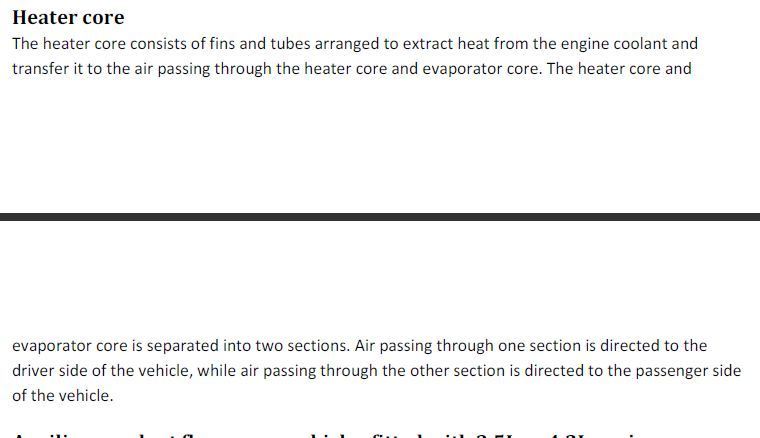

Originally Posted by benwillcox
I don’t believe this is correct, there is a single inlet and single outlet, it’s not like the SType system as there is no DCCV. The airflow is divided into two and passes through either side of the matrix.
My understanding is that the issue affects one side as the matrix is quite long and thin with the inlet/outlet on the short side, meaning that the flow at the far end of the matrix is not as good and that’s where any crud and silt ends up accumulating.
Ben
Ben, you are correct. The core is a single plane and air blend doors are used to vary the temp. If rear air system is installed, then it is broken off into two separate cores, one in the front, and one in the rear.
Ben
Yes, from another thread, I'm also reading it wrong:
And from Tech "Brutal": ok again I answer same issue. did he blow it out first? I have cut many cores open(theres only one) and the drivers side portion is on the end loop and gets plugged with sediment from the cooling system(never found sand). If its been flushed and blown out, you need to replace the core..This issue comes up EVERY yr when it starts to get cold and people use the heater again after a summer of non use.
https://www.jaguarforums.com/forum/x...er-core-85672/
Sorry gentlemen, for the misleading info.
