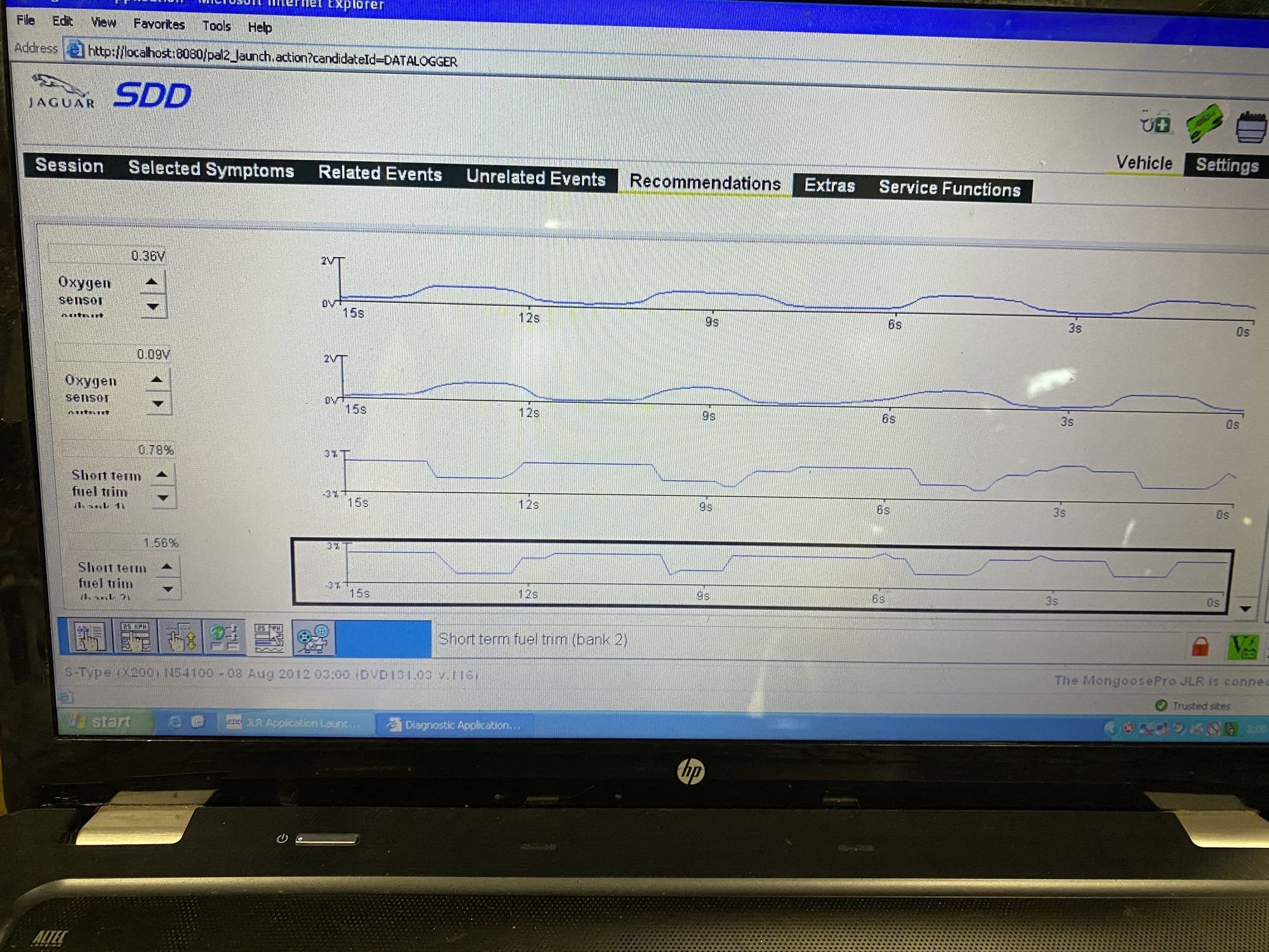

Here's my car at 2500RPM.
Nothing moves at all. Bizarre.

I never looked at mine at anything other than idle so I can’t tell you what they should look like but I would imagine they shouldn’t look like that.

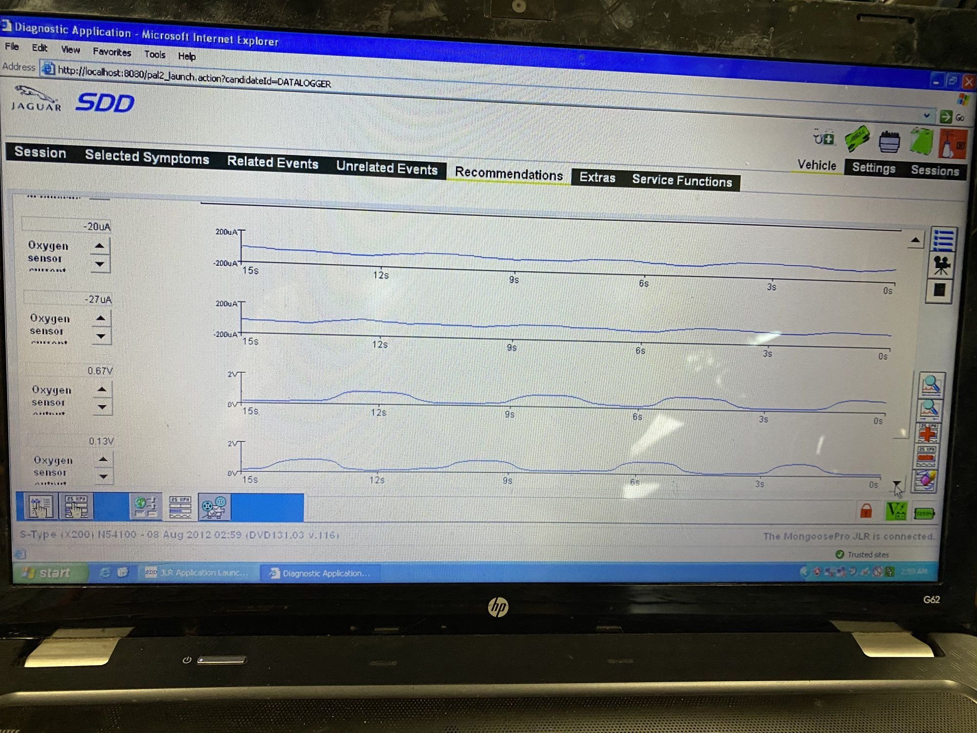

Heres mine at idle

Cheers. Mine are definitely screwed then. Ordered all 4 genuine Denso units so hopefully they solve the issue.
Wonder why I wasn't getting any codes for failed sensors though. Very strange.

Did you go into 'Unrelated Events' to look at the codes there? If you did not put in the symptoms relating to those failures it will not show up in 'Related Events'.
You definitely have problems with the upstream O2's. They show current draw in the Amps range when there should only be MA. Looks like the connectors are wrong and it is trying to adjust the heaters!

Yeah it peaks at 9.1A which is just crazy.
It's not the heaters though - they're wired up correctly.
