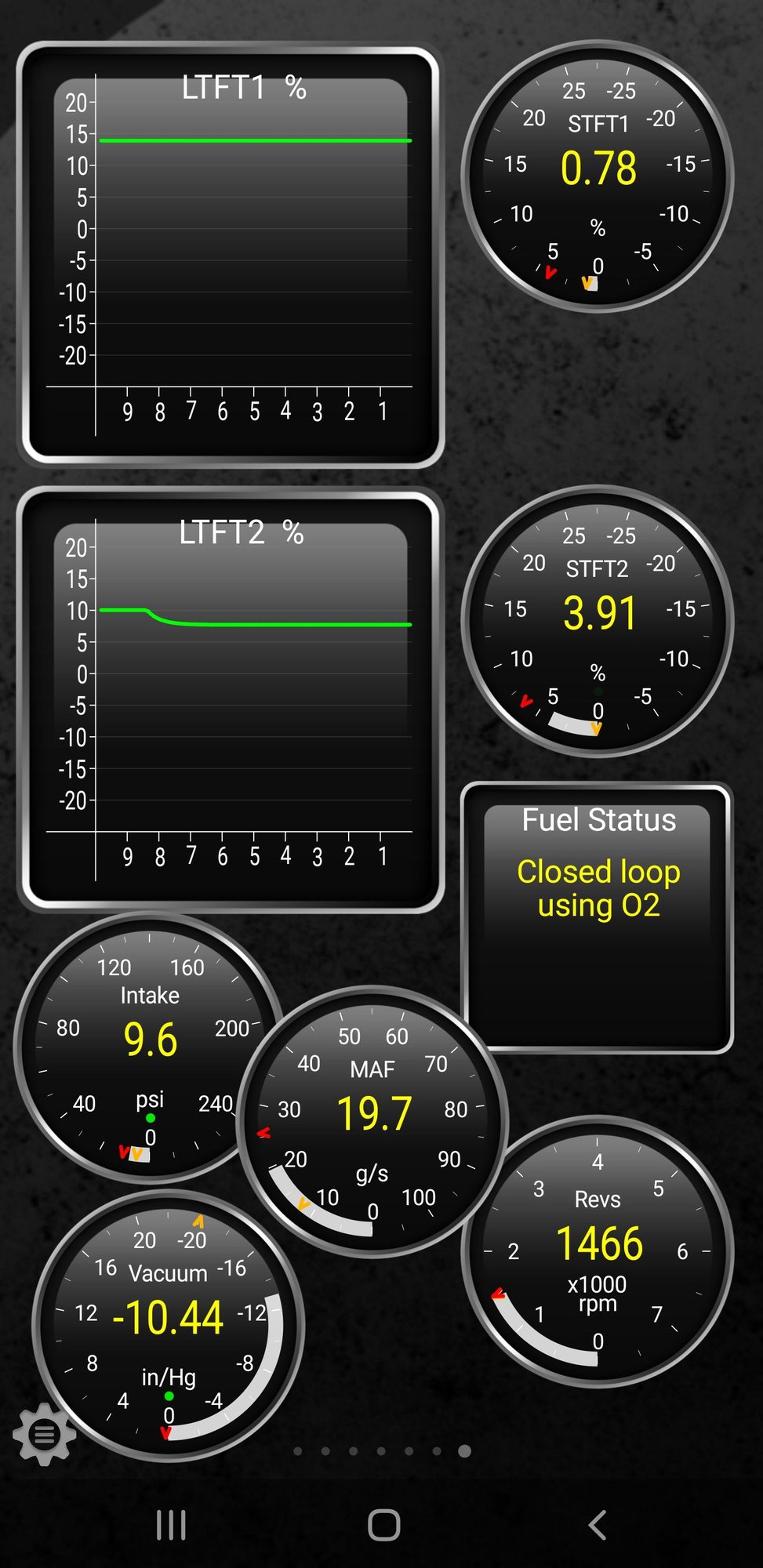

2005 XJR. Check out the below reading of the O2 sensors whilst cruising at 60MPH. It's like they're reading nothing. Surely that looks wrong?
Here's other readings cruising at 60MPH: (no vacuum leak)

Does anyone know if these O2 sensor readings look normal?
Old Mar 12, 2022 | 05:05 PM
Aarcuda's Avatar
Joined: Jun 2019
Posts: 1,710
Likes: 497
absolutely not. They should not be flat lines. They should switch up and down
That's what I thought. It may explain why my fuel trims are very high then.

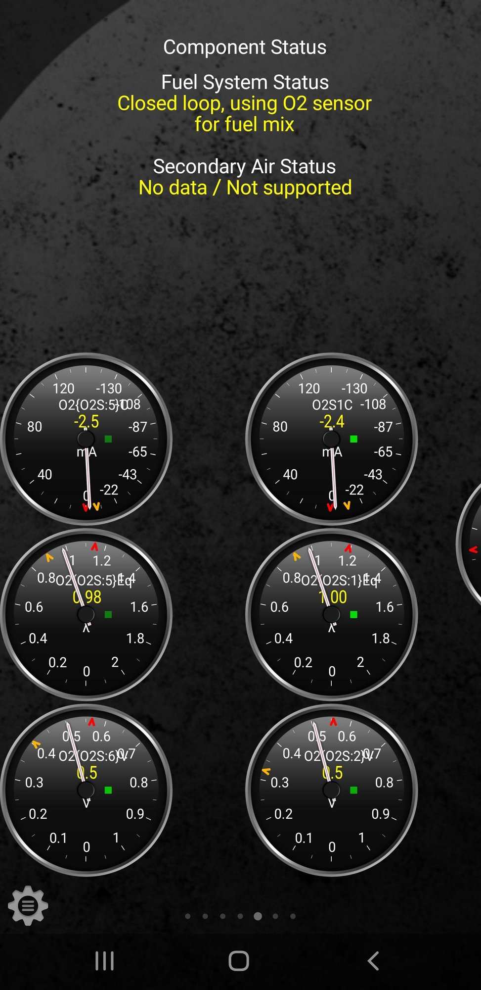

Slight update. I changed the displays from graphs to dials and I can see a bit of movement now, so went for another run, including driving round town and WOT at 70mph up a dual carriageway. The O2 sensors never show a positive current at any stage! You can see the max/min figures on the dials too.
Screenshot taken at idle after the above run.

Are you sure your reader is giving the correct results? Why is there an O2 S2 5? etc.
Yes, it's just the Torque App being its usual buggy self.
