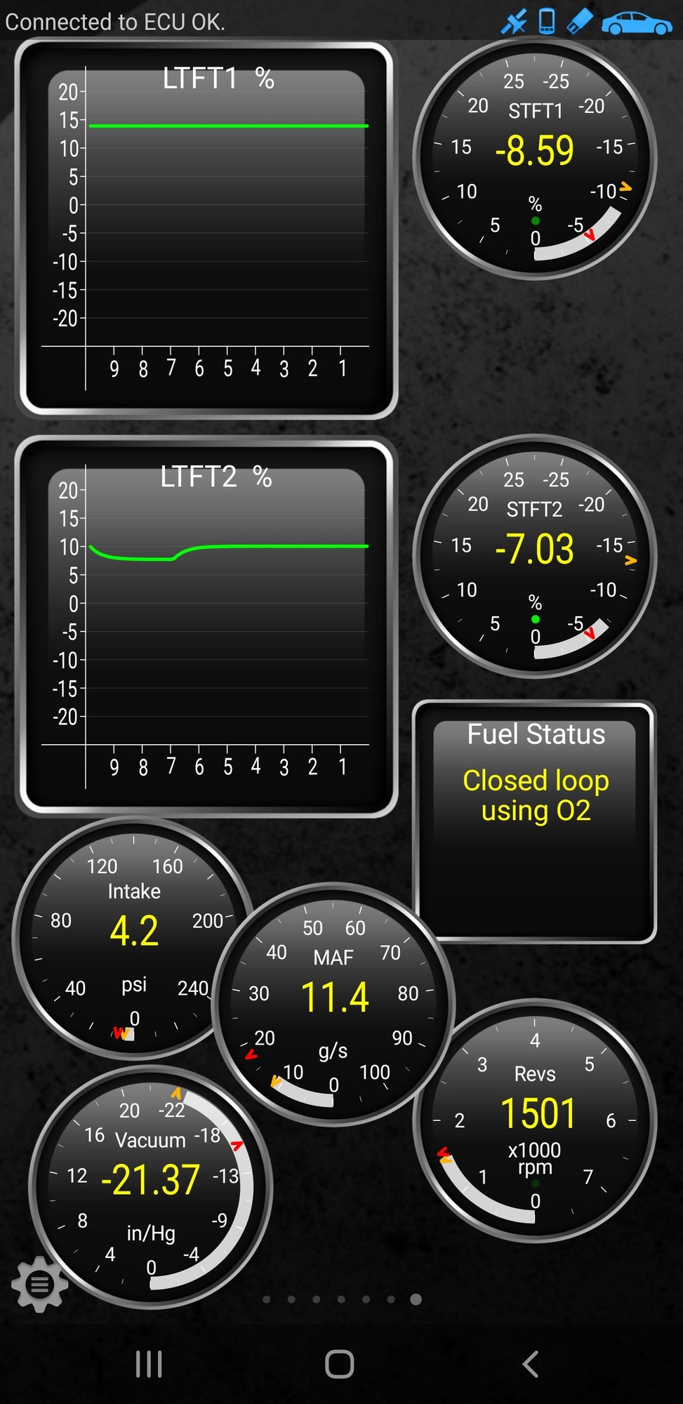

Getting back to the matter at hand, do those upstream sensor results look right to you? They go down to minus 10mA at lowest, and only very briefly, but they NEVER go positive, not even once, not even at WOT or after lifting off the throttle or anything. That makes me think the sensors are failing. What's your thoughts? Can you check what yours do please?

Played a bit. I have a problem with my bank one. LTFT and STFT are maxed out adding fuel with a +1.43 ma on B1S1. Sharp throttle movement will drive the ma as much as 10 ma each way.
In Torque go into the Test Results screen and see what the problems are that it shows you. Mine shows slow response and out of range values for O2's.
Then go into Graphing screen and select B1S1 and B2S1 ma. It will show a much finer swing so you can see if the values are changing in an expected way. You can do it for any you want to see. However if you piggyback wide value readings the small swing will not show up well - you are better to see most readings, of the same type, on their own.

That's really strange, my B1S1 is always reading negative mA and the LTFT is up near 20%, yours is doing the opposite.

I think you may be correct with the -ve ma driving high fuel trim. I put mine back on and as I was watching it the LTFT for my bank 1 dropped from the +20 down to virtually zero. The LTFTs and STFTs then were very low above/below or zero. Don't know why! Does not help you.
Instead of graphing or using the dial output in Torque just go to digital. Exact figures come up and are much easier to interpret.
I still think I have a lazy O2 sensor since the Test Results in Torque show too much time to go from rich to lean and too high a voltage output. I think I will put SDD on and get complete results. I was/ am not getting any EML type codes however SDD may show problems not shown by the basic OBD reader.

I've done that before, and the readings go from 0mA to around -10mA, but only briefly, they usually sit between -1mA and -3mA.

+20% Bank1, +18% Bank2.
Reduced performance mode all the time.
It's already been remapped and was working fine for months.
All work was done by previous owner which is a bit of a nightmare, but the car has had thousands and thousands spent on replacing everything it ever needed under his watch, with receipts for everything.

One other thing: I noticed tonight that for the first 15 minutes of driving, the LTFTs were approx +12%, but the STFTs were approx -8%, then for the journey back home, the STFTs were sitting at nearly 0% and the LTFTs were higher too. The engine comes up to temperature after only a few mins, so I don't think its temp related, but does something change after about 15 mins driving? Does a valve open or something? Just a thought...

Here are my results. I reckon those O2 sensors are screwed. Genuine replacements ordered. Previous owner has fitted eBay ones that cost 23 quid :/
