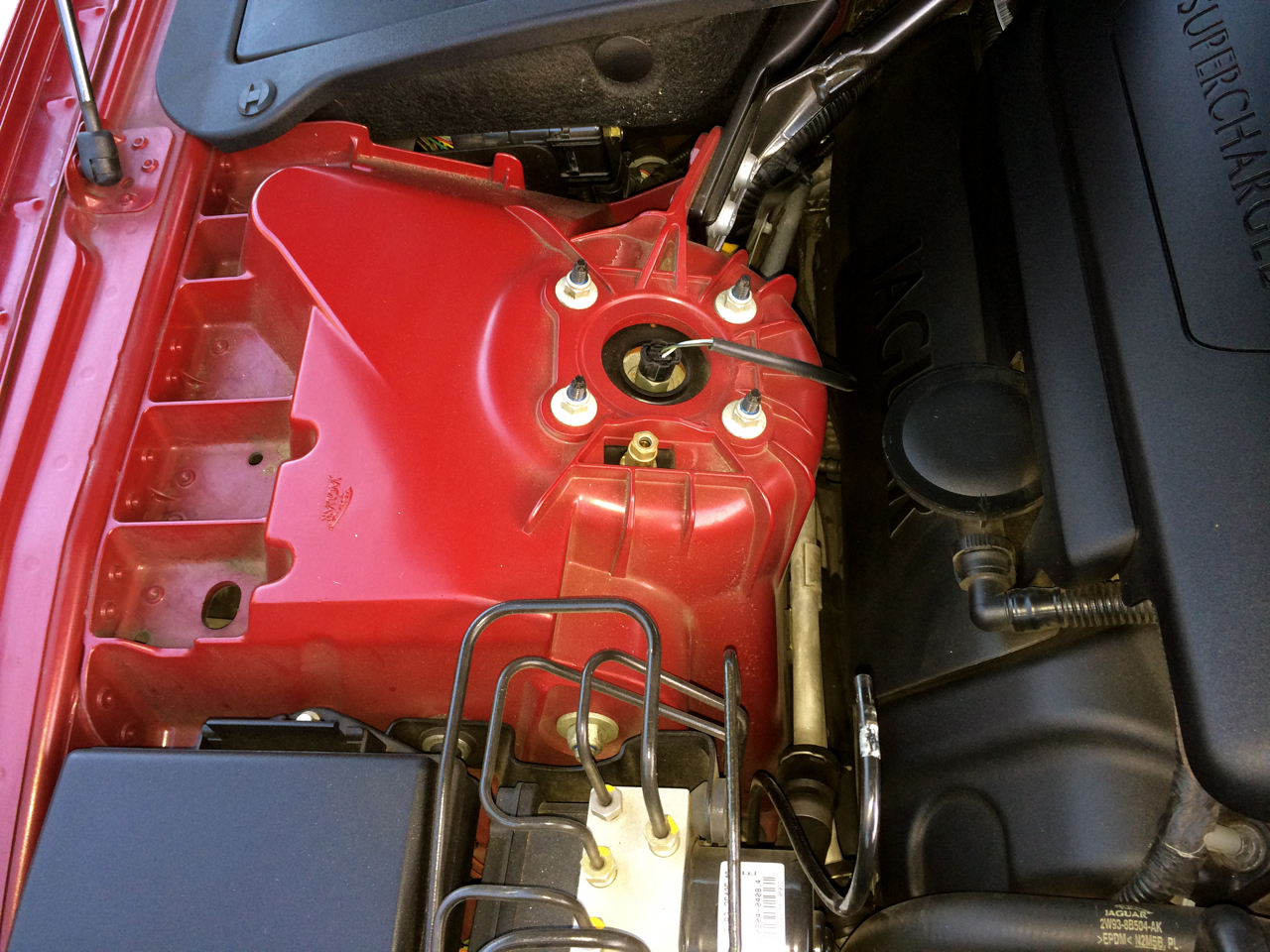

My air suspension failed last Sunday morning. We walked out of Church and as I was approaching the Jaguar, it appeared really low. There was no warning or a indication that there was an issue on the drive. It was resting on the bump stops and the it wouldn't rise after starting it up. Oh well, it has a little over 70k miles so it's about time I had this problem. Bummer - no donuts or cupcakes after Mass.
I got it home that morning and left it parked at home so I could deal with it sometime.
This morning while my truck was warming up, the sun was up so I finally had the opportunity to check for leaks. I started up the engine, popped the hood and was about to walk over and grab a bottle of soapy water. But, I saw the problem and had it fixed a few minutes later. I figure I saved at least $10,000-$15,000 by not bringing it to the local dealer.
Now that I know that the line blew off, I'm glad it happened while it was parked. Lucky me, huh? Plus, it was early morning on Sunday so getting it home was easy and uneventful.
I'm going to look at it again this weekend (if I care enough). I'll inspect the fitting and the tubing and reinstall it to specs I'm aware of. There were colored marks on the side of the nuts so I suspect the install specs are probably hand tight, mark and then tighten based on some amount of rotation. But, I could be wrong.

In my case the air springs are very high in price from the Canadian dealership. They sell them for CAN $1,600 each (US$1,440) and I see a U.S. Jag dealership that sells parts on Ebay sells the part for US$ 1,033. (CAN$ 1,135) so that is a savings of CAN$465 right there per unit - even though the other seller is also a dealership. The Bilstein unit (identical to the Jaguar part just without the Jaguar label on the bag) sells for US$895. (Can$985) so wiothout even getting to non OEM parts the savings from buying two Bilstein air springs (2xCAN$985=$1,970) vs two Jaguar air springs from the local dealership (2xCAN$1,600=$3,200) would result in a savings on exactly the same part of (CAN$3,200-$1,970=$1,230.
I went to the dealership to pick up the car today and sat down with my service adviser and the head mechanic. The topic of conversation was how I am not made of money. I used the above air spring as one example. They were both sympathetic, and said they agree the parts are very expensive, and they said if I want to source my own parts they will use those if I bring them in, instead of their parts, since the Bilstein unit is identical to the Jaguar unit. At any rate, they did not charge me the $115 per item diagnostic charge for telling me A) the air springs leak, B)the compressor should be replaced, C) the differential seal leaks, or D) the rear seat heater switch is faulty. Indeed they did not charge me any diagnostic fees at all, even though I wasn't having the work done there. I did pay them to replace the serpentine belt and tensioner, as it was obviously damaged and making a racket and I already authorized that repair on arrival (replace the belt it is about to go) before getting/going over the list of other stuff that was priced out and in need of repair.
The bill breakdown for the thing they did do - the belt and tensioner - is as follows:
1 C2C37063 Belt - drive $ 82.14
1 C2C36146 Tensioner - drive $155.45
Labor 6 hours @$144/hr $864.00
Total parts & labor $1,101.59
Notes: abnormal engine noise on start, traced fault to faulty idler pulley and cracked belt. Replaced both parts and rechecked engine. Engine noise now normal. No further action required.
My concern in this is that how does it take a Jaguar mechanic 6 hours to change a drive belt and tensioner? All the dealerships in this area (Mercedes, Audi, Jaguar, BMW charge labor at similar rates per hour, so yes, it is a dealership - but why six hours?
At any rate, I will be considering other options for the air springs - even if I source the parts myself, if it takes 6 hours to change a belt and tensioner the hours billed to change those two air springs would be, well I know already from the estimate - $4,700 less the $3,200 they said the parts would cost = labor of $1,500 to do the air springs. So that is 10.2 hours, or about 5 hours per spring. I just watched a YouTube video of changing an air spring on a Jag and it didn't look like more than 2 hours per unit to do as a DIY job.
