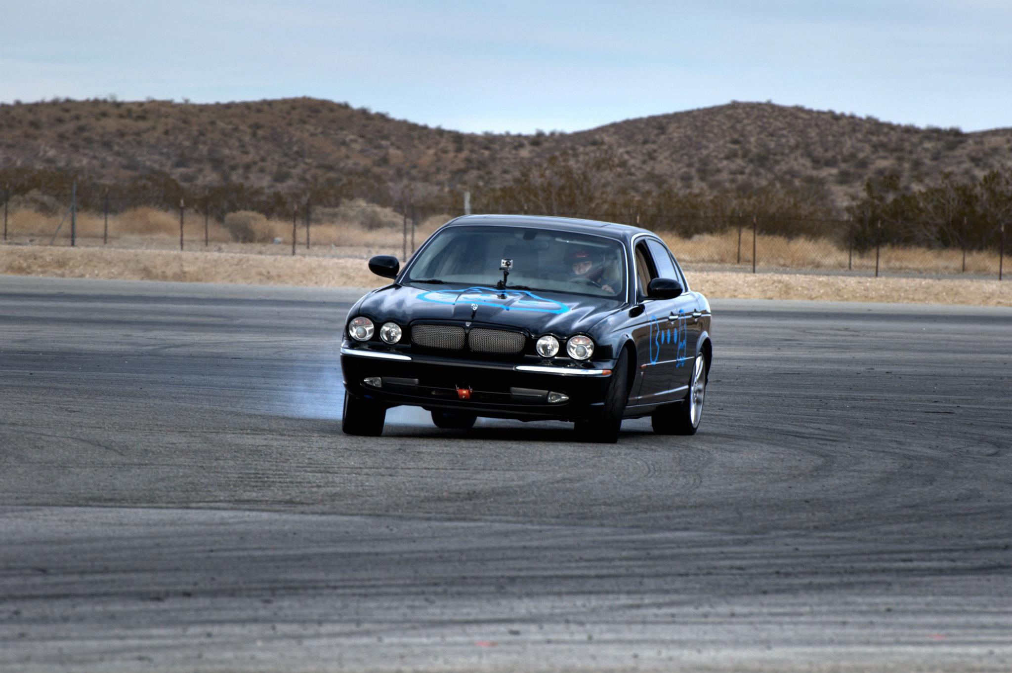

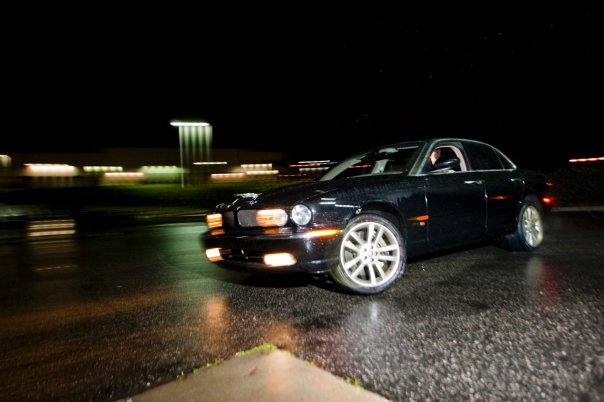

Having taken my past X350 XJR to the track , I can say that the car is ridiculously easy to slide and control. Because of the open differential, power-on oversteer is extremely controllable with even aggressive inputs into the throttle and steering. The car did not have a tendency to become snappy even when pulling off the throttle mid slide. My current XFR is definitely a bit more 'edgy' when driving on the limits.
A basic understanding and some prior experience with car control is obviously important to feel out the dynamics of the vehicle. In my experience, the X350 XJR is very easy to drive fast, drive sideways, and drive down the freeway!
Here is a video of my X350 on the track. The last corner entering the skidpad (time in video = 2:05 and 4:00) is the corner where I was able to pitch the car sideways. Enjoy!
Attached Thumbnails Over Steer in an X350-322976_2760632649500_1021780790_o.jpg   Over Steer in an X350-24609_1337055900971_4689939_n.jpg
