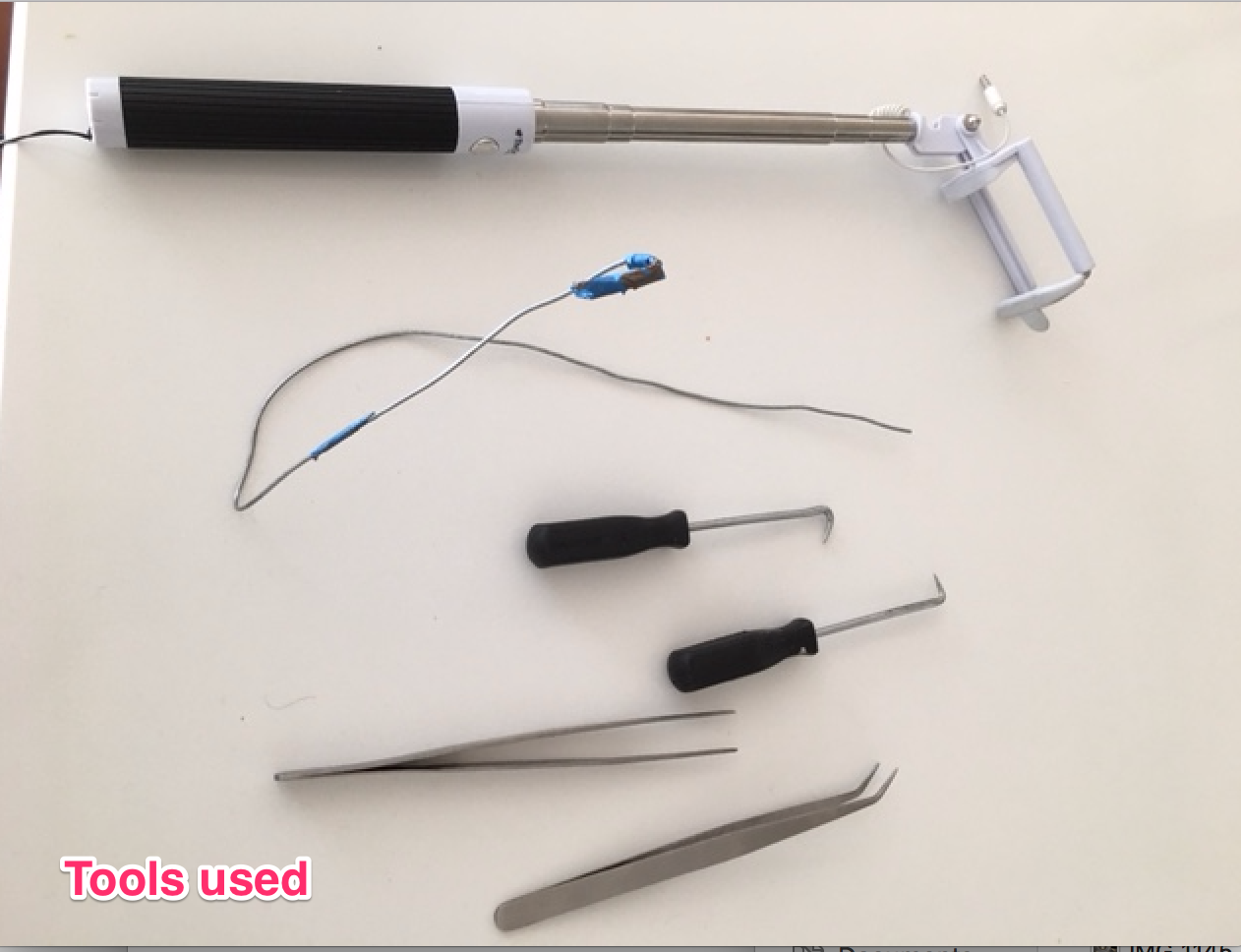

Here's what I've tried so far, with no luck:
I've used different types of tweezers, picks that are curved at the end, thin wire, placed a garden hose at the end of a house Dyson vacuum and pushed it all the way into the spark plug and ran the vacuum.

To close the loop on this question, I tried to dislodge the piece of rubber using an air compressor, then followed by a vacuum, I loosened the spark plug and repeated the air and vacuum process, used different type tools, from picks to wire to hemostats, but nothing worked. The location of the cylinder is awkward and I don't have a clear view or straight access which may have contributed to not being able to retrieve the piece of rubber. I gave up for now and just placed the new ignition coil in, so I can drive the car again. I may regret doing so later on, but I'll deal with it again when I have to replace the spark plug.
