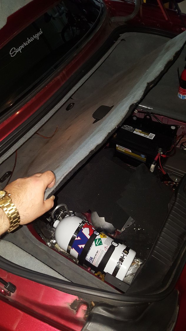

I live in Arizona temps do get really high it was 119 degress out here today I used to daily drive my str with nitrous and have had the bottle pressure at high temps to the point where it wouldn't even purge so the positive of that is that if the bottle pressure is to high you'll know it when you try to purge i have a remote bottle opener a nx express window switch purge kit with fuel pressure safety switch and bottle pressure sensor with a bottle heater now i mainly use it at night or take it out briefly so it doesn't really effect my setup the nitrous bottles now have a burst disk if pressure gets to high it will burst and safely empty your bottle which beats blowing up the bottle burst disk cost a dollar i have never had a bottle or disk burst and ive had my car in 119 degree weather all day the bottle heater to some people state its a waste of money ive had 5 nitrous setups including my car having a bottle heater with a bottle pressure sensor keeps your bottle pressure no matter what the temperature outside is its automatic if you turn on your heater it will not turn on due to the the relay cutting off power but will kick on if pressure falls below 950psi which if you take it out for some night runs you will need it and it heats the bottle up pretty fast to make sure you always have the pressure needed to run properly my first two nitrous set ups i had no bottle heater and after 5lbs of nitrous used the pressure would drop to much and it would throw to much fuel 3rd set up went with a 15lb bottle that was with a bottle heater on with a 200shot 5.0 i could go down until it 2lbs were left thanks to the heater then i got a x type 3.0 manual transmission and put a 75shot with a 10lb bottle with just the genx2 kit then put a 100 shot and i broke the transfer case so i took my previous experience and thought i knew it all and decided to put one on my str i had serious problems it made it slower on just a 75 shot i kept playing with it got it running right on 75 shot and i kept having to much fuel getting dumped in if i sprayed off the line but not from a roll so i took it to jba speed shop to get help met a nitrous guru named lee and they fine tuned everything explained to me why i needed a window switch why i needed a heater he went above and beyond the window switch allows you to set it up to spray when you want and cut off when you want as we all know the supercharged 4.2str is sensitive and hard to tune so they fine tuned the fuel side of the nitrous system because it was running rich they cleaned up my setup

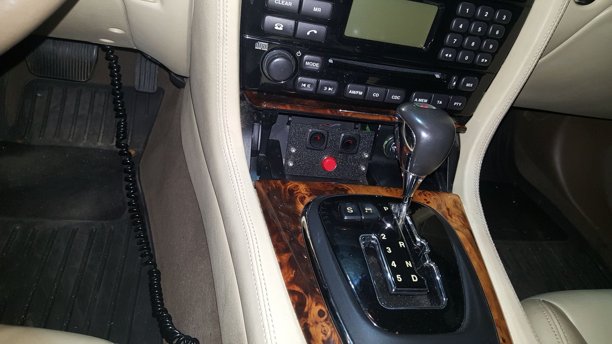

And made me a custom switch box for the str where the cup holders used to be i didn't have any issues on any other car i had nitrous on always gapped the sparkplugs at least one stage colder and pull timing but my str was alot of trial and error even the shop said this was one of the hardest set ups they had done but they really took there time and did it right other cars are very forgiving easy to tune 4.2str dont have a plug and play tuner or have any shops that i know that can tune it especially for nitrous so the nitrous system needs to be tuned on the car if you guys want i can give you guys more information or part numbers my 03 str with 135000miles has nx express proton kit 10lb bottle kn air filter cats deleted and 44 series flowmaster nitrous express has pretty good customer service and NGX customer service is really helpful and will give you your sparkplug heat range needed to handle for your nitrous set up or for any other mods they are very helpful I truly love nitrous and believe its a great mod to the 4.2 super charged engine i love it but nitrous is not for everyone i have sprayed alot of bottles thru my str and have had minor hiccups mainly user error i was racing a 63 amg forgot to purge and ended up spraying air and fuel instead of nitrous and fuel no damage done just got rich codes put fuel cleaner and it was back to normal just make sure you do your own research and take your time and i highly recommend the window switch purge and bottle heater and fuel pressure safety these are not cheap parts but it made my setup work reliable and safely
