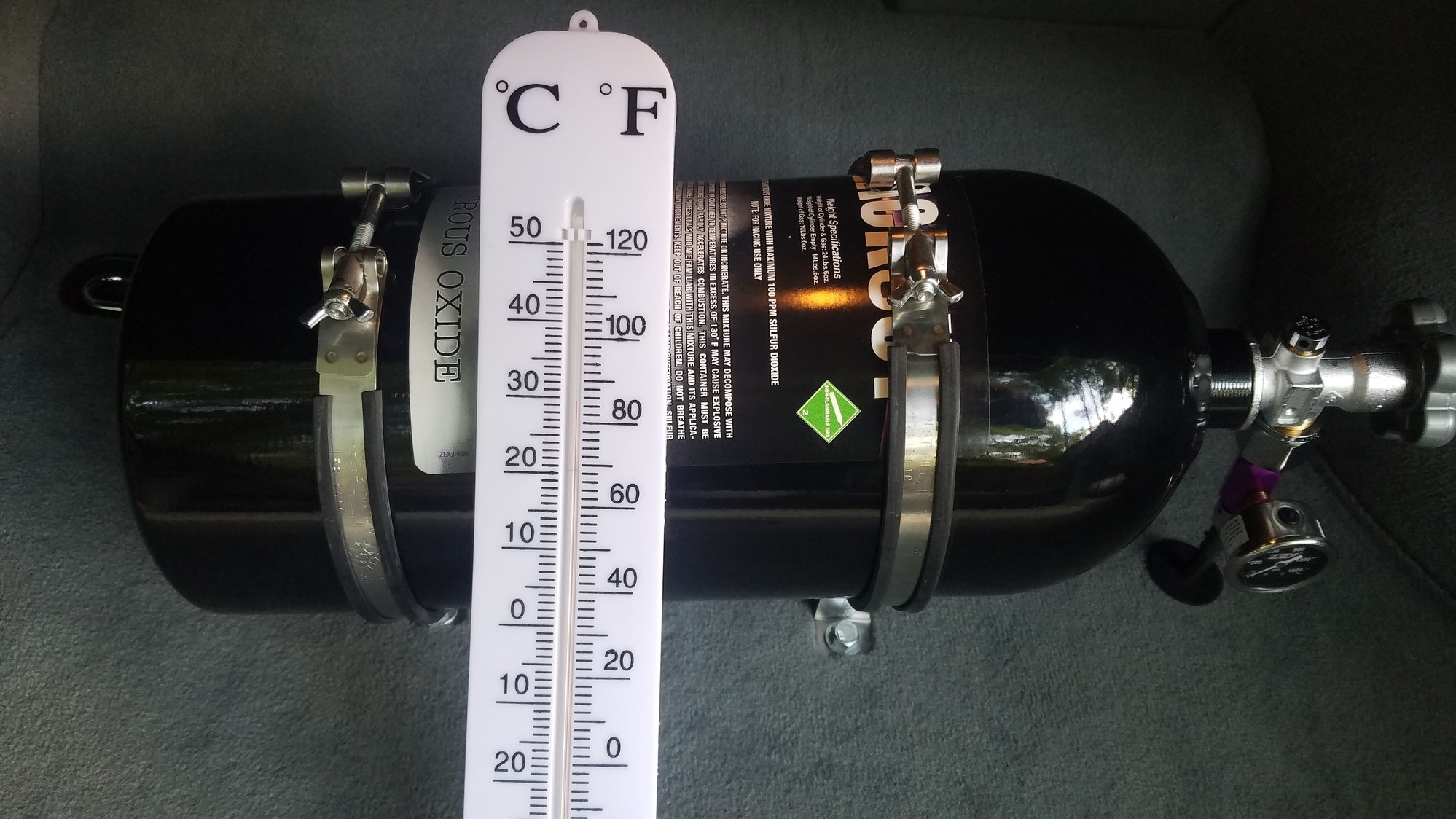

Wow great for all that information guys well appreciated I haven't given up yet. It's going to be 90 and hot here today so I'm going to put a thermometer in the trunk and see how my temperature is and that will help make a informed decision also will run the pressure gauge into the interior of the car so I can monitor the pressure instead of on the bottle... I do plan on buying the bottle blanket remote opener I already have The Purge Kit I'm just holding off until I'm sure I want to keep it. It rarely gets above 90 here in Connecticut

I left the car out in the sun yesterday it was 91 degrees. The temperature ended up being right around 85 which is the exact temperature you want to keep the bottle at at all times for your 950 PSI so I would say the bottle will never get that hot if I leave it in the car all the time so that worry is over.. today it's only supposed to be 78 and sunny I'm going to leave it outside and check the temperature again. Also going to put the pressure gauge in the car so I know the temp and psi

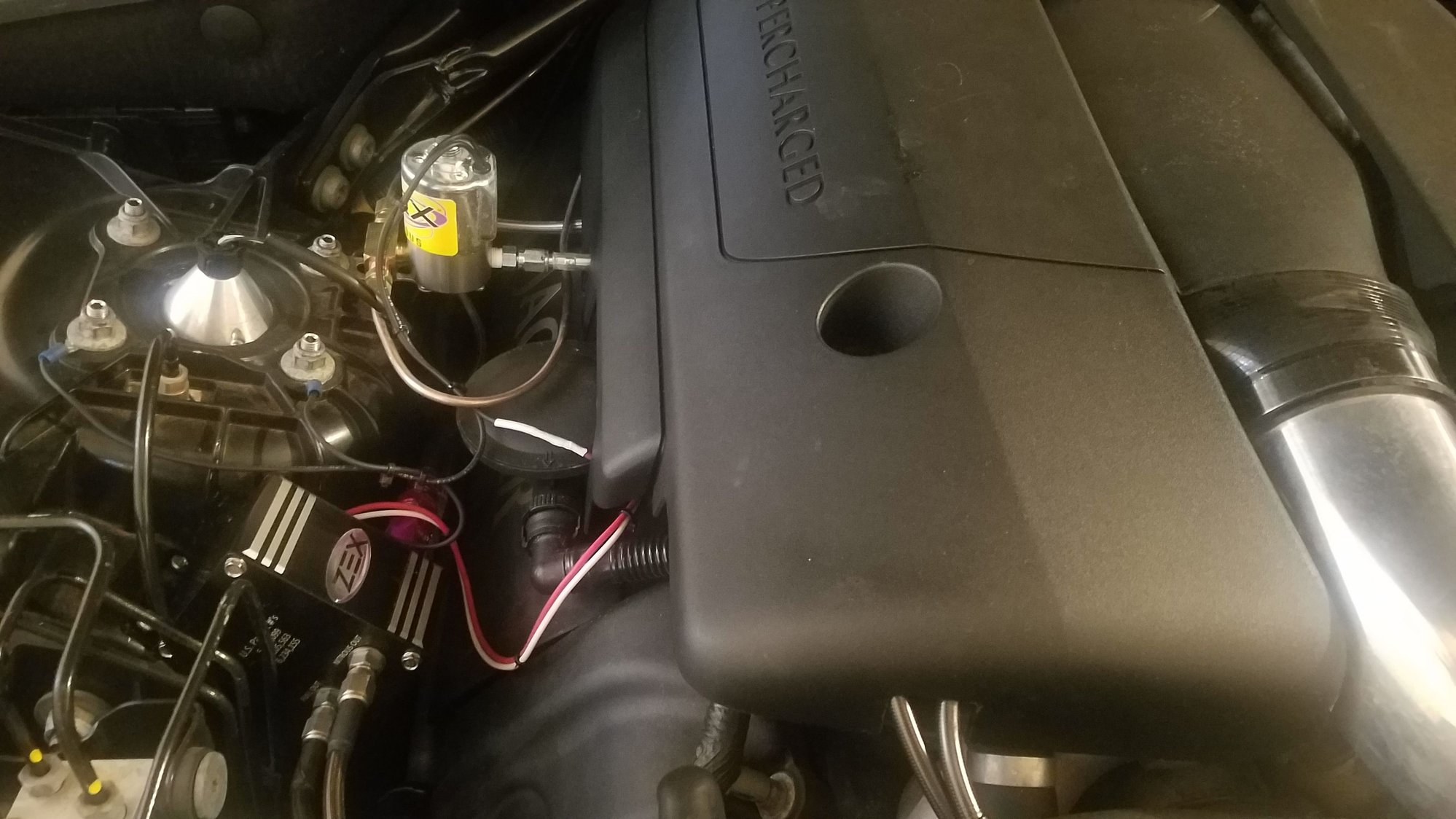

The nitrous is finally installed...Just have some final wiring cleanup to do...I am going to try it this weekend...So this is what I used: Zex 75/100/125 HP nitrous kit...Zex purge kit...Zex liquid filled pressure gage...Zex thermostatically controlled bottle blanket...Remote bottle opener...1 step colder spark plugs...To do it right this is what you need...Air fuel gage if you go over 100 HP...I am going to stick with the 75 HP to be on the safe side...Soooo If all goes well my quest for 450 HP will be over!!!

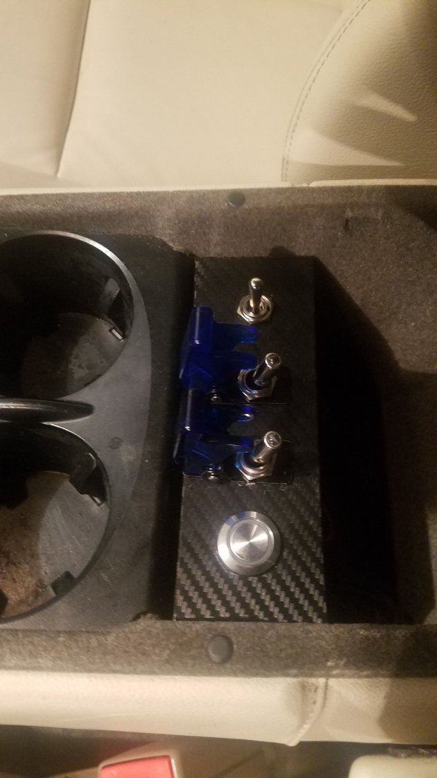

this is the finished product what it looks like installed
