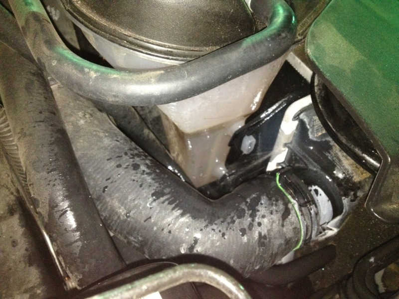

It seems to be leaking from the side of the radiator where it meets the plastic at the seam. See below, notice the white stuff from the fluid.
Attached Thumbnails Radiator Question-bffa96d4-885e-43d3-b20f-e917941aab70-19586-00008954c219676c_zps6d9e0f53.jpg

It's gotten worse! Here are a few pics of what's going on. You can see water shooting out.
I lost about half a gallon on the home last night. I'm tempted to go over to napa and buy the radiator tonight since it's my primary car. I noticed on the website it says "w/ manual transmission"
I haven't had a chance to check but does anyone know ifthe xjr have transmission lines to the radiator? Greatly appreciate any help.

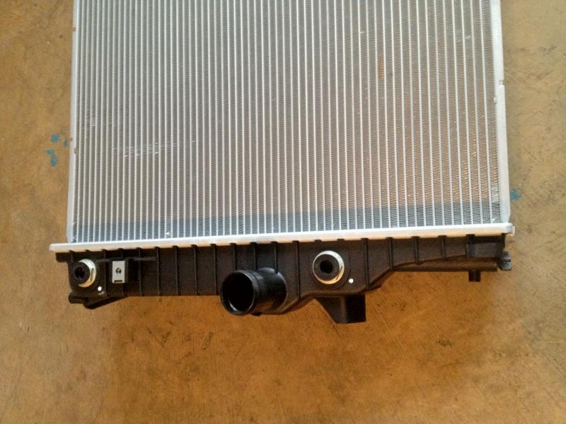

After looking at the radiator tonight I noticed the only radiator that will fit is the BEHR radiator from partsgeek. The reason being is that it's the only one with transmission cooler. Be aware the other radiators mentioned in my initial posting will not fit!

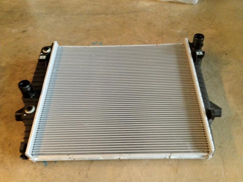

Thanks, I was almost tempted to find a separate transmission cooler. Got the new BEHR in today. So far it looks good. Gonna install in a bit.
shot of transmission cooler
Attached Thumbnails Radiator Question-img_21411.jpg   Radiator Question-img_21431.jpg

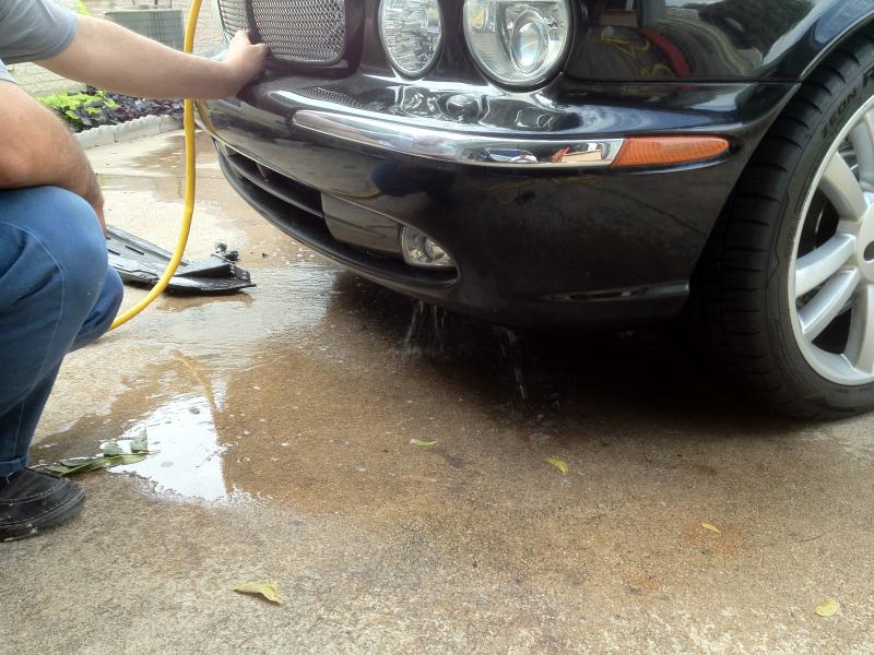

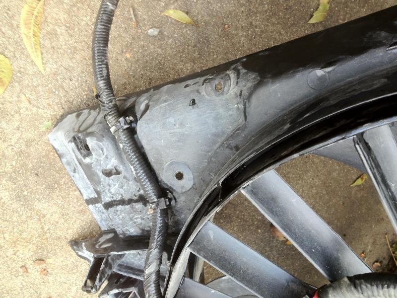

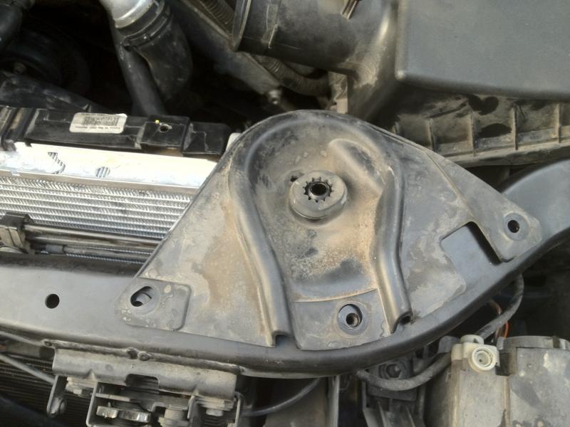

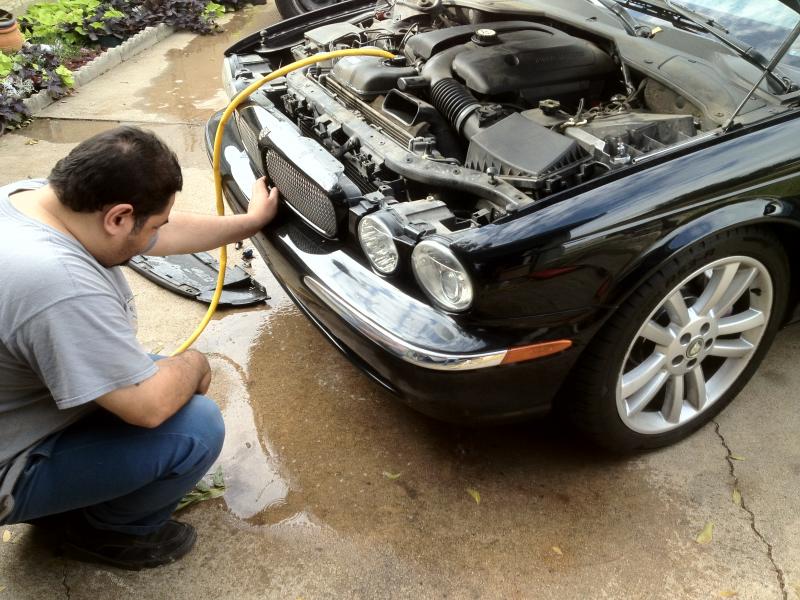

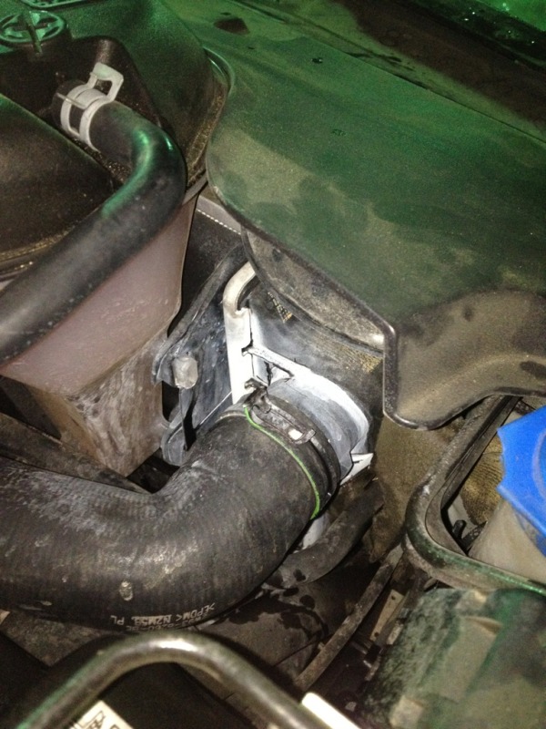

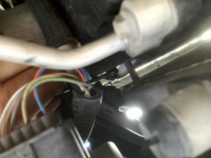

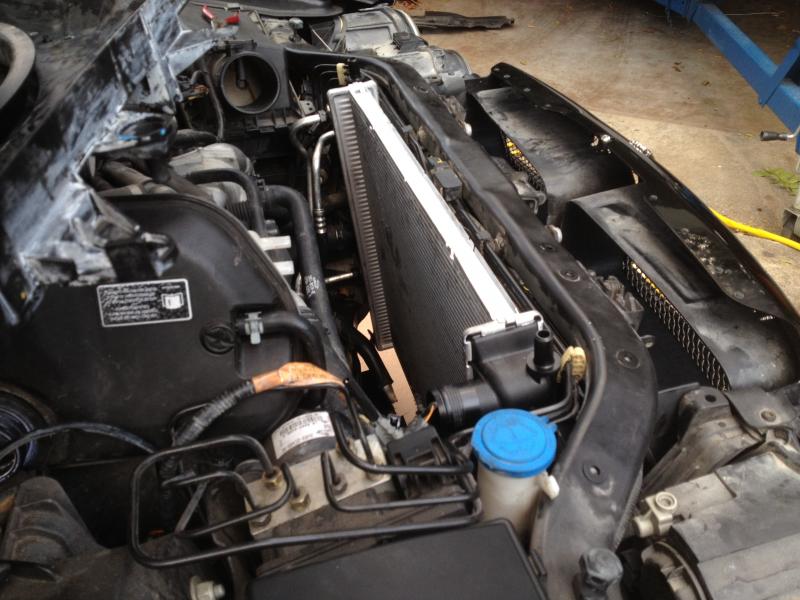

Installed new radiator!
Removed front undertray and bottom radiator shroud. Flushed old stuff out using good ol water hose, engine running and heater full blast.
Disconnect hoses and removed expansion tank. Removed brackets holding radiator down. Disconnect fan and sensor cables. Slide fan shroud up and out. Made note not to forget the slide in cables back onto fan shroud.
Disconnected more hoses and transmission lines. Didn't notice much tranny fluid, probably from lifting the front end. Unscrew two bolts from rear of radiator, these hold together radiator, ac condenser and intercooler. Very little room here. Luckily I found a baby wrench, 2.5 inches long. It took a while to take the driver side one out, small turn at a time.
Wiggled and pushed radiator back to access front bolt. Using a very long extension removed front radiator bolt through bumper grille.
Slide radiator up and out. Lots of patience required here plenty of hoses and brackets just love to grab to this radiator. Pull rubber mounts from old radiator and slide unto new radiator. Slide new radiator in. Slide Ac condenser and intercooler into their respective slide brackets on radiator. Bolt radiator, ac condenser and intercooler back together. Re connect hoses and transmission lines.
Checked thermostat and housing. Still looking good and clean.
Install radiator brackets and expansion tank and everything else back.
All in all it took a couple of hours. Still have check engine light on, will wait to see if it clears, gotta buy a scanner.
On to the next one..... cleaning out heater core. Will keep you guys updated.

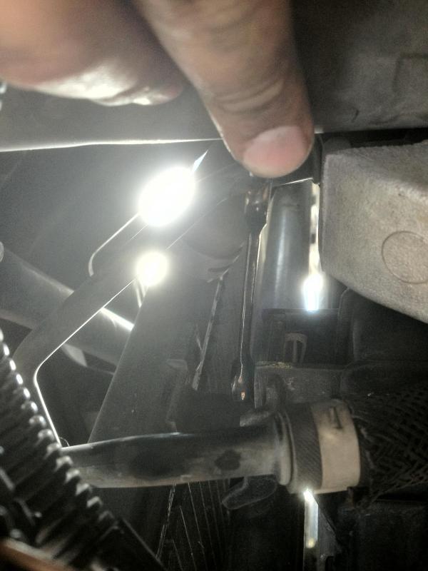

I know it's been a while, but could you clarify the pics that go with "Unscrew two bolts from rear of radiator"? I cannot make heads nor tails out of the pics that accompany this step. I don't see retaining bolts on the back of my radiator and I cannot tell which way is up or forward in your pics. Could you describe where these small bolts are? Also, one of the electrical connectors for my fan or sensor will not release. Can Is there a better pic of the smaller connector or an explanation as to how it comes apart? Thanks
Old Jan 21, 2015 | 09:14 PM
BlackKat's Avatar
Joined: Sep 2013
Posts: 598
Likes: 171
From: Texas
Just from memory. Those two bolts connect a bracket to the radiator. The bracket holds the AC condenser lines.
The pictures you see (the one with the baby wrench) are ones I took lying on the floor facing up. The bolts might bolt to the side of the radiator.
Hope this helps.
As far as the connector goes, we'll, my guess is carefully squeeze and pull hard as heck.
