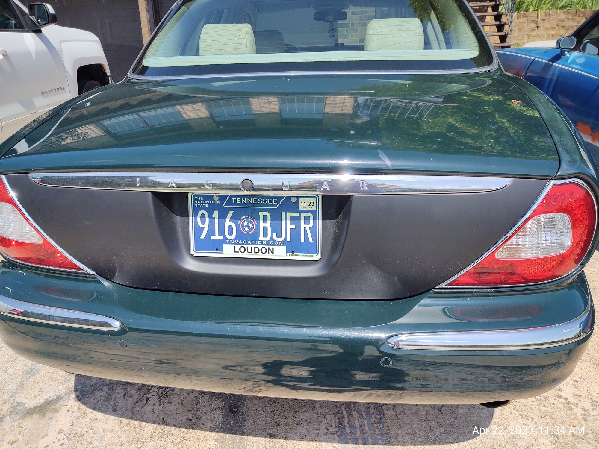

Default Buy a replacement. Will break more when you remove it
I just replaced mine about 6 months ago on my 2004. I tried to remove the old broken one and it broke into a million pieces like glass. I ordered a new one from here.
https://parts.harperjaguar.com/
Here is a picture of the replacement part. It comes with all the clips and everything. All you need to do is transfer your chrome bits and tag light etc. I also drilled pilot holes to reinstall my license plate so it wouldn't crack again.
Replacement panel from Jaguar.

So is that dark grey/black bit a 'Rear Fill Panel'?
Old Apr 22, 2023 | 01:26 PM
Gregory Long's Avatar
Joined: Feb 2022
Posts: 45
Likes: 12
From: Lenoir City, Tennessee
Yes. It's the black part.
