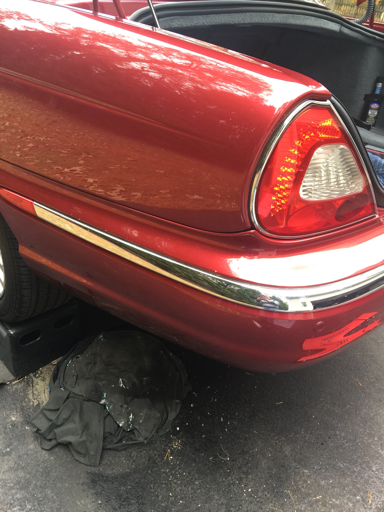

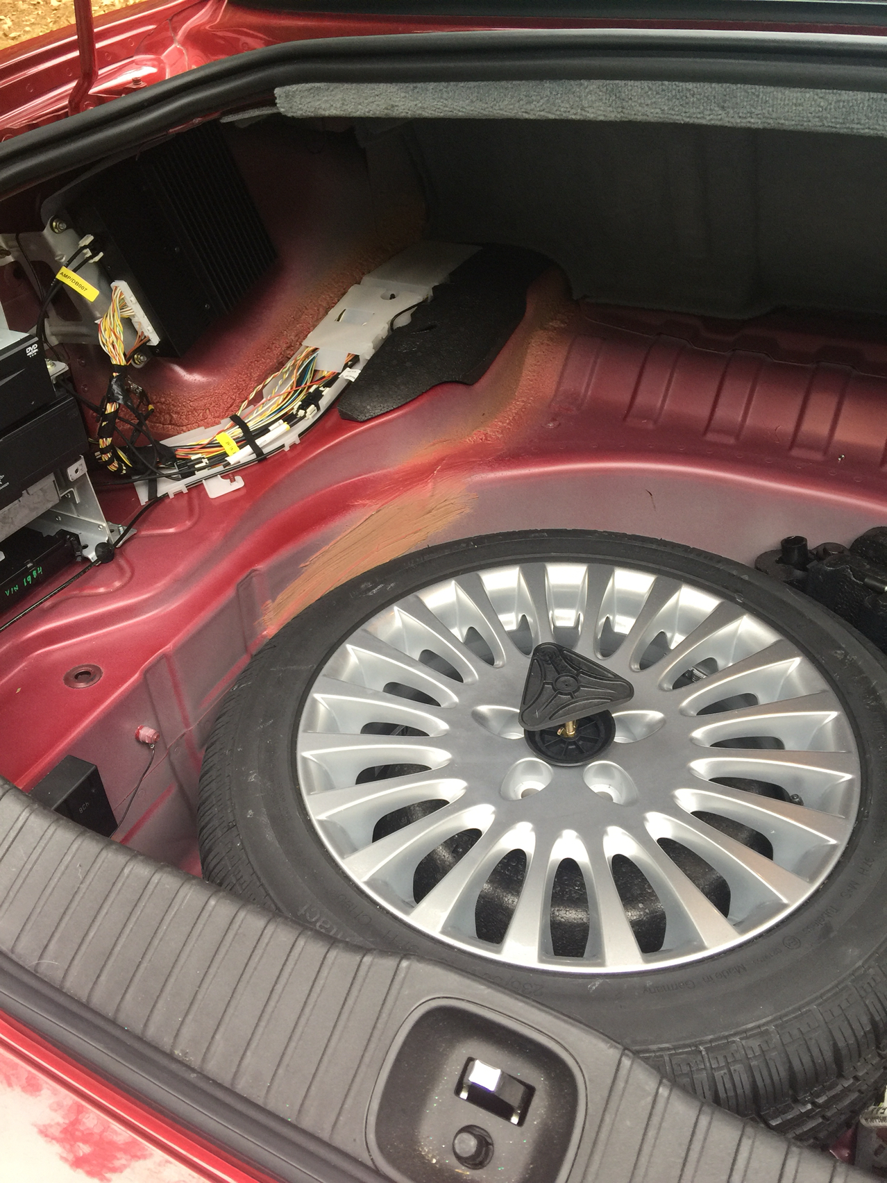

Replaced the rear park sensor today. Here are some pics.
First, put the car on ramps and remove most of the trunk coverings.

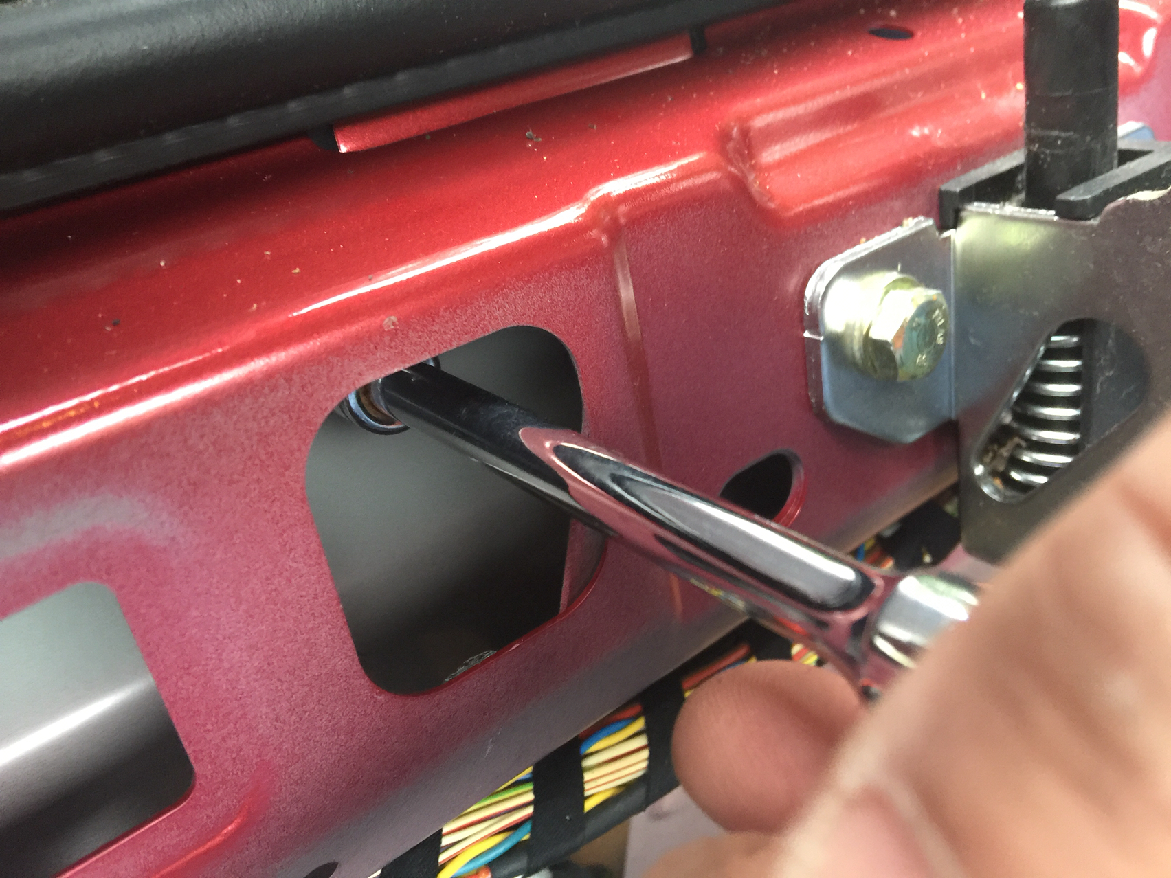

Remove the rear plastic trunk molding.
Two metal and two plastic fasteners...

Remove 4 bolts to bumper cover, 4 plastic fasteners underneath and one near the rear wheel.
Pull bumper cover cover away.

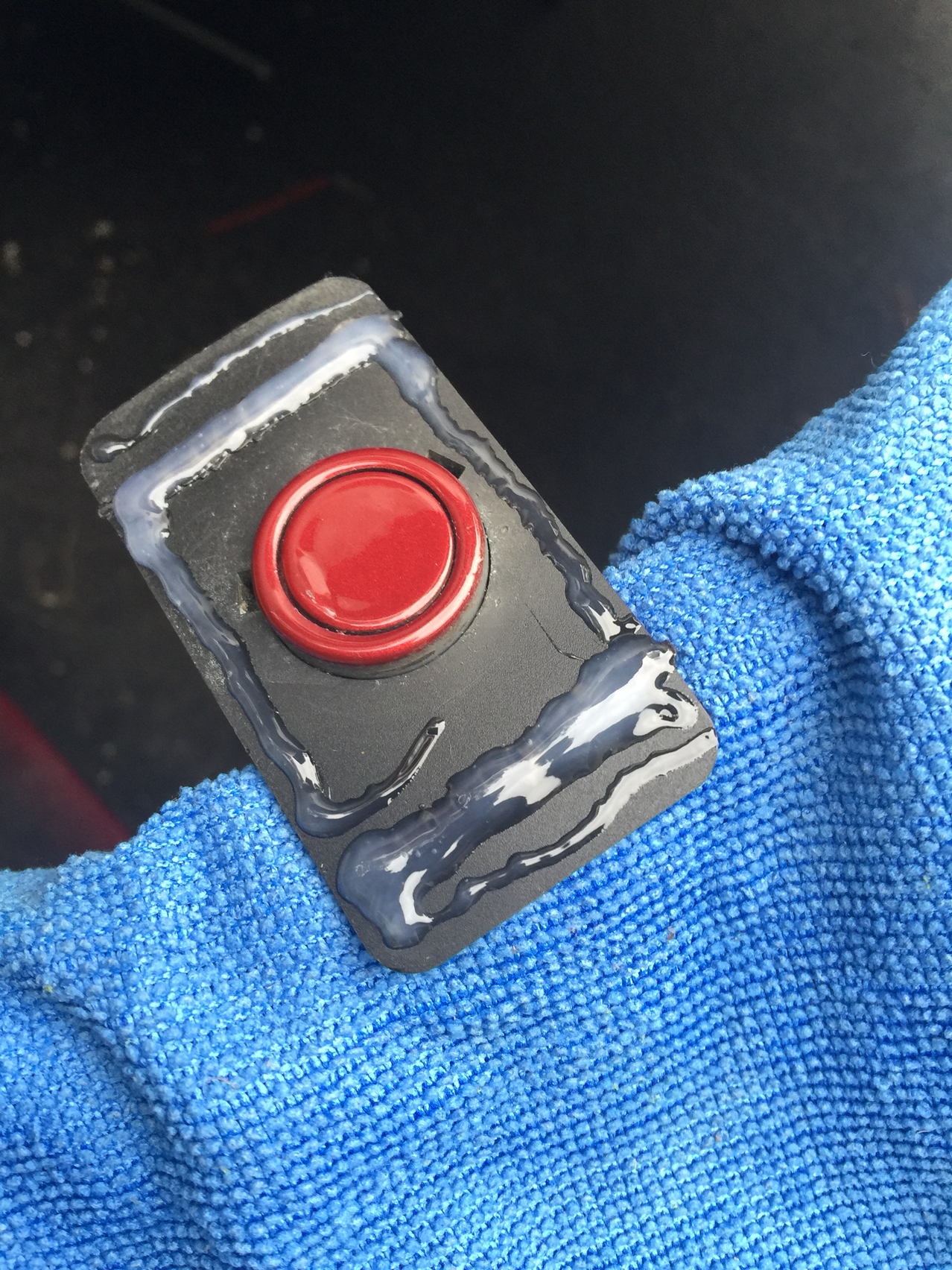

Test replacement sensor for proper operation.
Removed failed sensor.

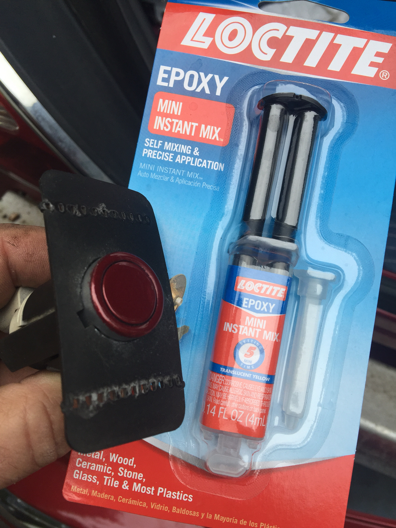

The plastic 'ears' came off the bumper with the sensor. The info I had said to push and twist the sensor out (xk8), but this was not the case. So, the flat plastic 'ears' came off and needed to be affixed again.
There are clips on each side of the sensor that can be moved away from the sensor with a flat screw driver. No twist, no spring; just open the clips and pull sensor out.
So, affixed unit to bumper with epoxy. Held in place a couple minutes.
