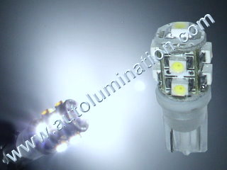

I ordered them from "Autolumination".
Website:
194 168 W5W 2825 Map Led Parking Signal Marker Bulbs
Order the 194 SMT Bulbs $9.99 ea
9 Led SMT Tower II 194 168 W5W 2825
I got the website from another forum member.

I will be replacing my parking lamps with LEDs, ordered a couple a few weeks ago-they were too long. Waiting on a new batch.
How long was too long? The Tower II you mention are 32mm in length. That same site has Tower III that are 38mm. Anyone know the max diameter that will fit as well?

I could not reinstall the bulb holder into the headlight assy while it was mounted on the car. If I removed the headlight assy, I could have used those bulbs. The bulbs has to be the same diameter as the bulb holder or you will not get the bulb holder back into the slot.
