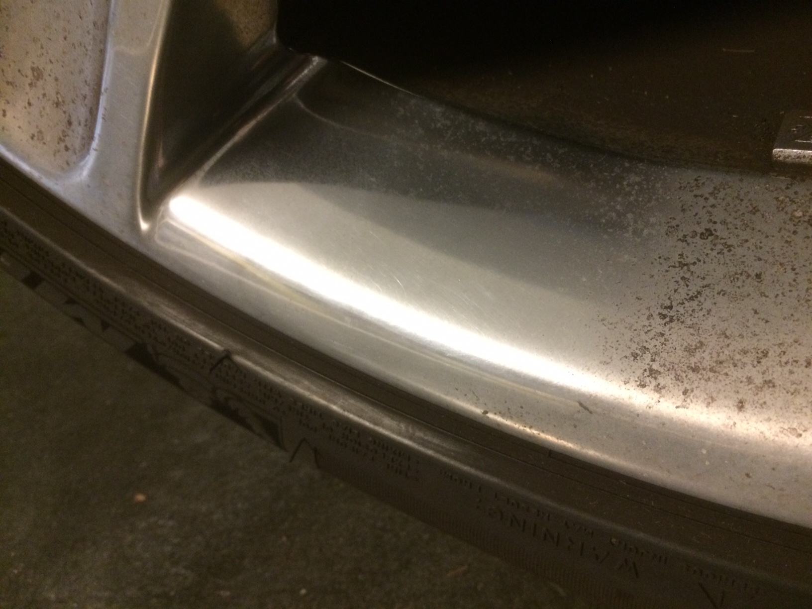

I washed my car and attempted cleaning the wheels (something I did not do for a while, they had become greyish).
Unfortunately, I observe that the surface now looks pitted, as if some hidden corrosion has taken place under the dirt during that period.
I recall that these wheels are originally diamond polished witout clearcoat if I am not wrong.
Any advice for the best refurb?

Try a little metal polish, if the rag goes black then no clearcoat. If it does not, then the clear will need to be stripped and re-polished unfortunately.

Thx for the tips.
I'll try a metal polish (I believe there is no clear coat).
I would really prefer keeping them with the original polish look (no powder coating or painting).
Assuming I succeed in "derusting" the pits, I am wondering if the pitted surface wil not then be better clear coated to avoid rerusting. I'll see...

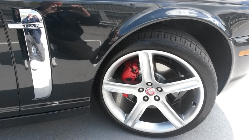

Even in 20" guise the were taken off the car, dipped and stripped, painted and lacquered and put back on the car for around £300 iirc, all good.

Thx for the advice, Jim.
Fortunately they seem to be recoverable albeit some energetic rubing will be required.
I tried using some aluminum de-oxidiser and the result looks promising.
I showed it in another thread here where there was a discussion on lattice alloys polishing:
https://www.jaguarforums.com/forum/x...-142779/page2/
