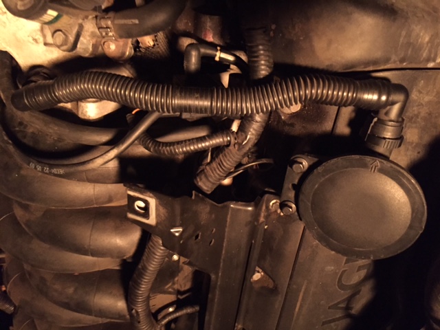

I noticed the hissing sound was coming from either the vacuum hose that leads to a port at the top of the engine then off to something that appears to be some sort of breather valve?(pic included, looks like a black flying saucer) hoping someone can identify it for me. Definitely seems to be where the hiss is coming from, I assume there should be no air escaping noise from that correct?
Tried replacing o-rings on it but still getting a hiss....
That is your PCV valve, and yes they do hiss somewhat under normal conditions. However I do not suggest changing the o-rings unless you have the correct site (2.65 mm cross section) otherwise you will make the leak worse. https://www.jaguarforums.com/forum/x...-tubes-151869/
