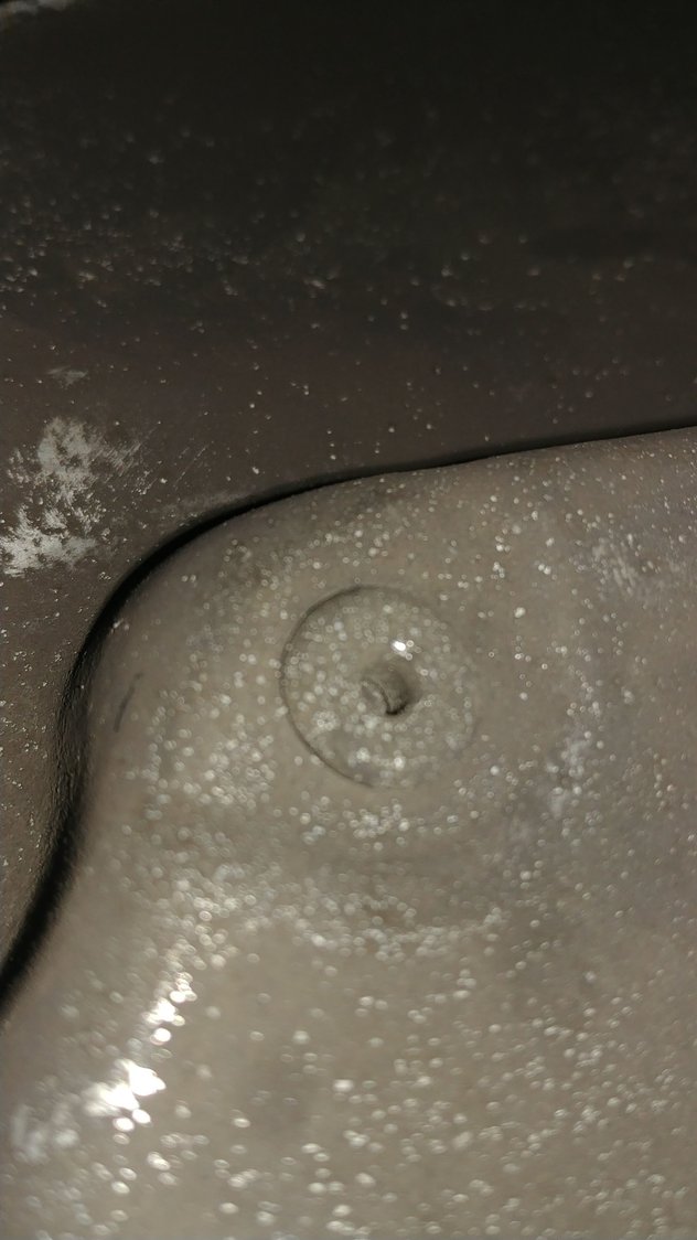

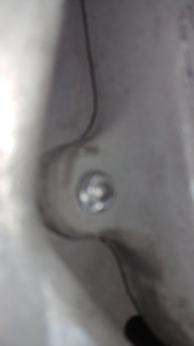

Need help in how to remove the rivets described below & help in how to replace them. &, would like to know if there is a satisfactory nut & bolt replacement for the rivets once the rivets are removed.
The pictures show each of the rivet ends. One is flat with a small hole in the center and is almost 1/2" in diameter; the other is dome shaped & appears to have a rod-like center with a round, doughnut-like surround & its diameter is almost 3/8"; it appears that the center is a different metal from the surround.
These rivets are holding the brake shield around the knuckle on the front right(passenger's) side.
Thanks for your help.
Almost 1/2" in diameter
Almost 3/8" diameter; center seems to be a different metal from doughnut-like surround

The easiest (& most intuitive) way to remove the rivets is by drilling with a 3/16" & using a chisel & tap as per the youtube below.
According to the tech at Jag Greenville, they use ordinary aluminum rivets. While they use a heavy duty air-driven machine; he suggested a regular one will do.
Now, this car has me talking with myself! Hope this may be helpful for any other uninitiated riveters.
