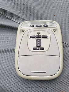

If you need one I have an upper console unit I don't need..

Thanks for the offer. I need one without a sunroof and with the combined parking/rear blind switch.
Yes I think you're right, the inside of the switch is likely to be tiny bits and pieces
I'll keep a look out on ebay for a suitable unit
