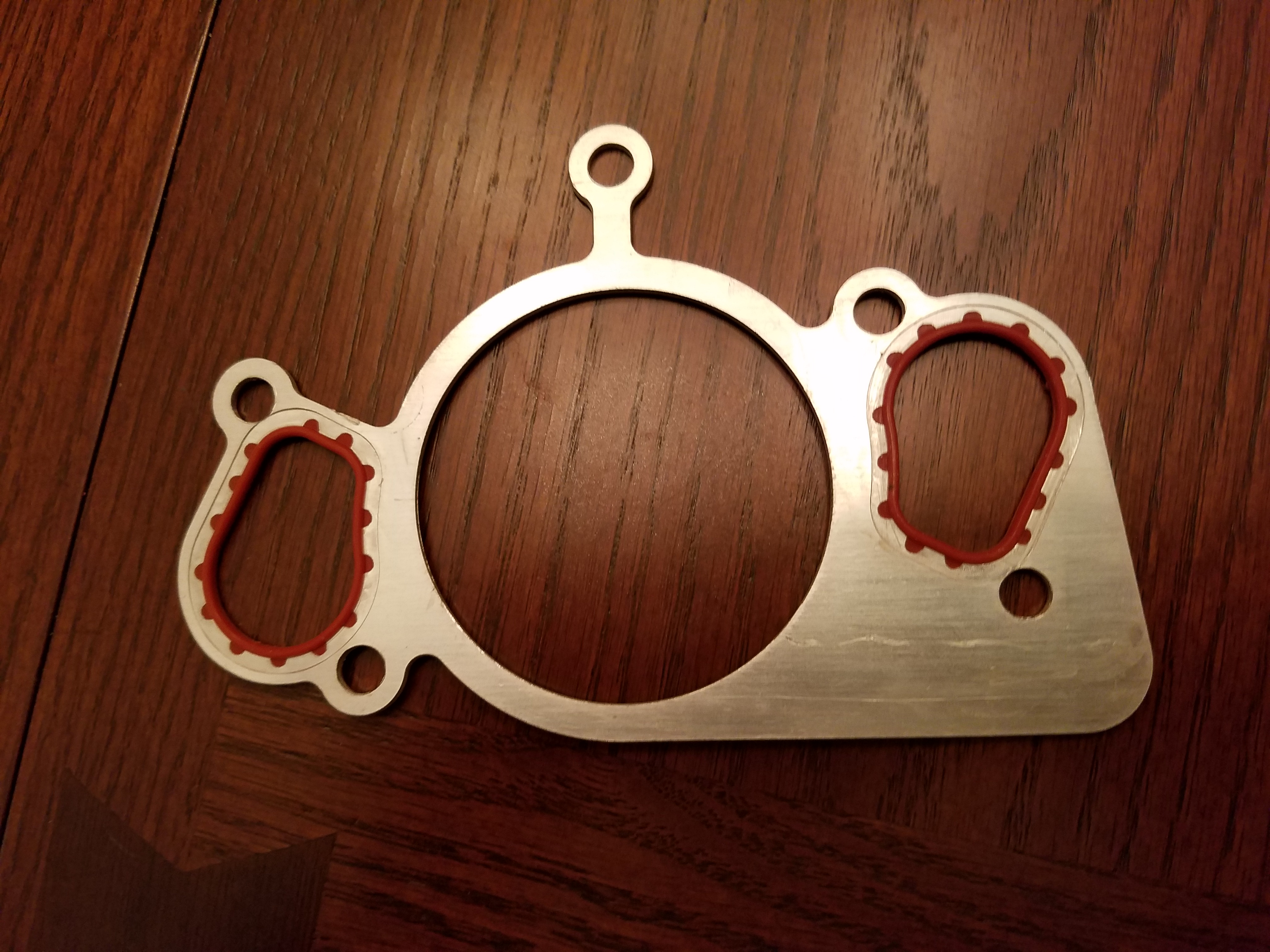

Thanks for the answers. The new gasket is made from aluminum and is just under 1/16 inch thick. The water passages in it are surrounded by a rubber type bead. Please see the pictures. The gasket and the mating face of the pump are included.
I was surprised by the gasket thickness and material; it's pretty rigid. Does this change any sealing opinion?

Those APPEAR similar to factory parts--where is the O-ring?

You don't use anything on the aluminum plate. However, OAT coolant is not to be used with metal impellers. Your pump should have plastic impeller (white poly phenyl sulfide) and use OAT coolant.

Once again, thanks. This pump is an ACDELCO and it does have the o-ring already installed. I test fit it and it's fine.
Thanks for the heads up on cavitation. It does have a metal impeller but I wasn't aware of that making a difference.
Oh yeah, (to the original question) , no sealant, cheers.
David, excellent catch. The impeller in that ACDelco pump does appear to be stamped steel, which is incompatible with the correct OAT coolant that Jaguar specifies.
My understanding is that OAT coolants provide good protection for aluminum but are antagonistic to steel and solders and do not protect them from cavitation erosion. One reference is at this link:
Engine Coolant Testing
One option is the Airtex AW4124 pump, which has a proper white plastic impeller and is just $32.79 from Rock Auto. Airtex is an OEM for Ford, GM, Chrysler and other major automakers. The Ford Motorcraft pump may also be a good choice. It has the same type of white plastic impeller that looks identical to the one in the Airtex pump, and it is likely made by Airtex, but Rock Auto's price is significantly higher at $115.79.
