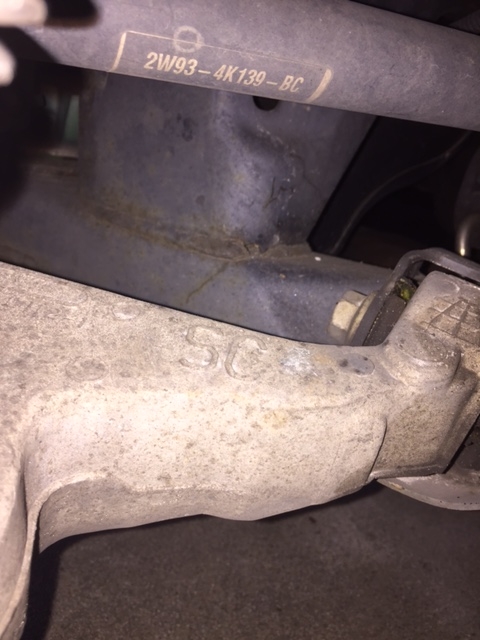

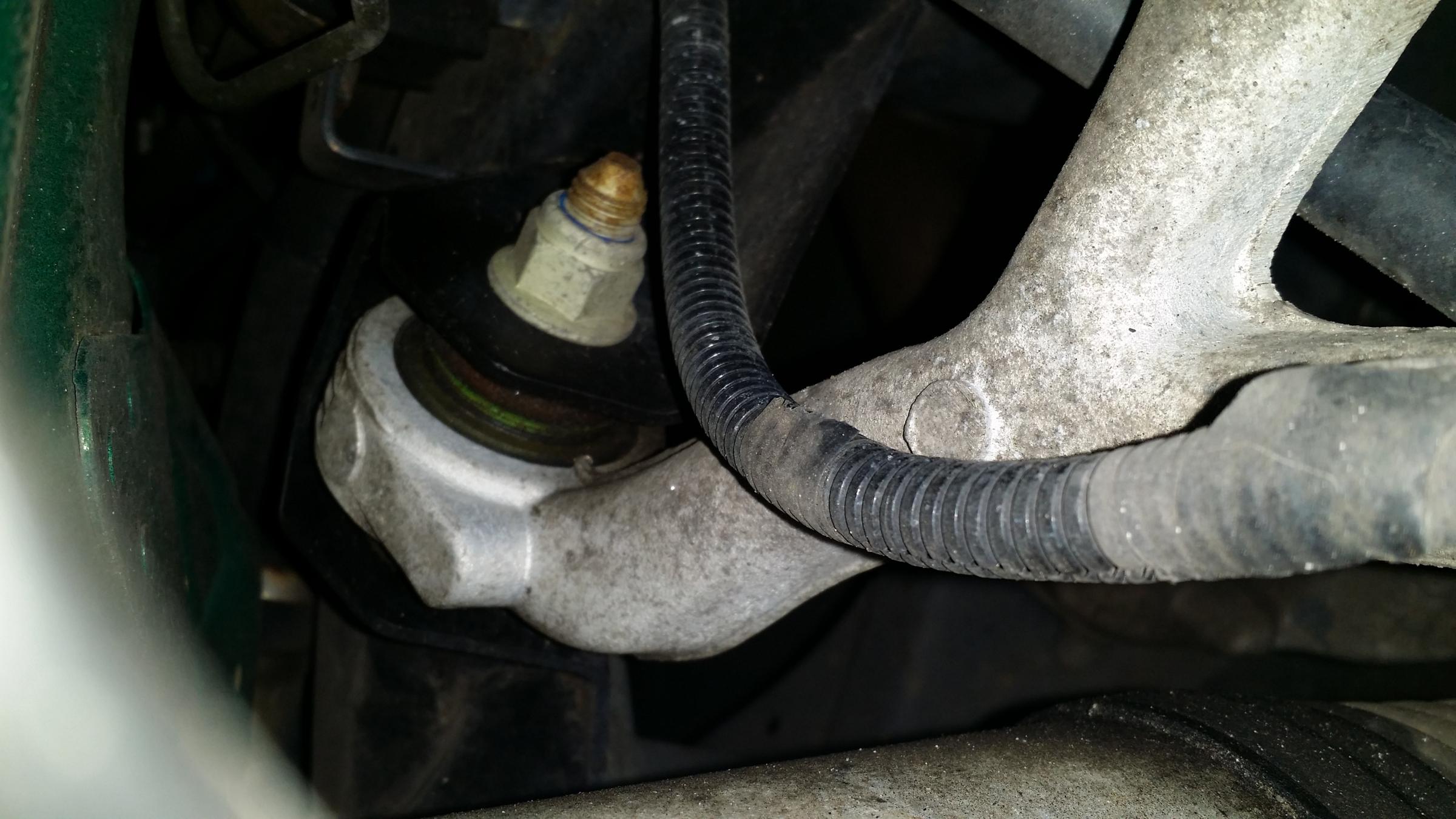

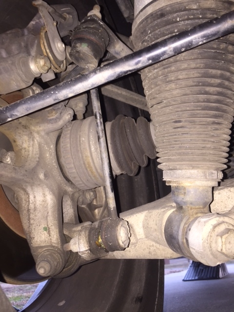

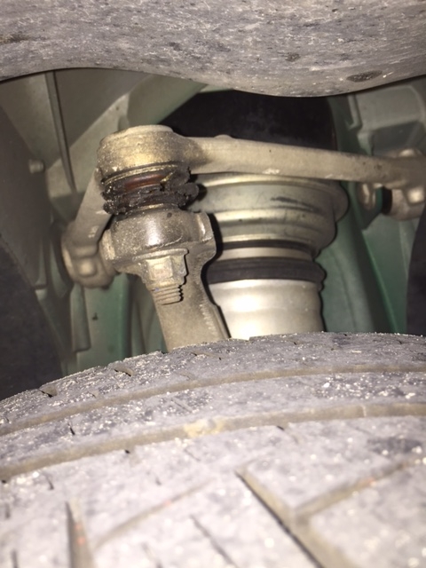

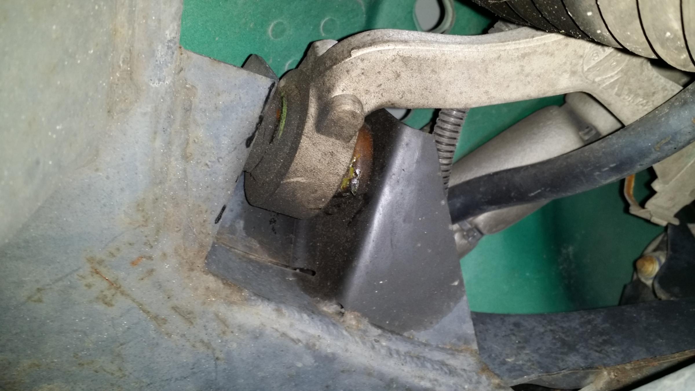

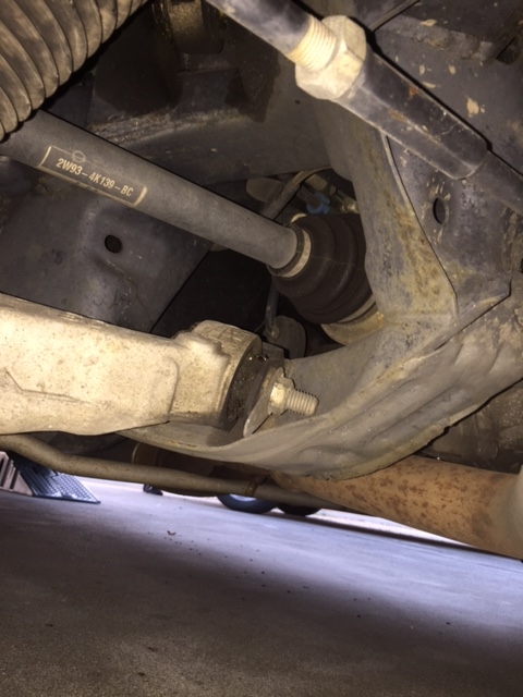

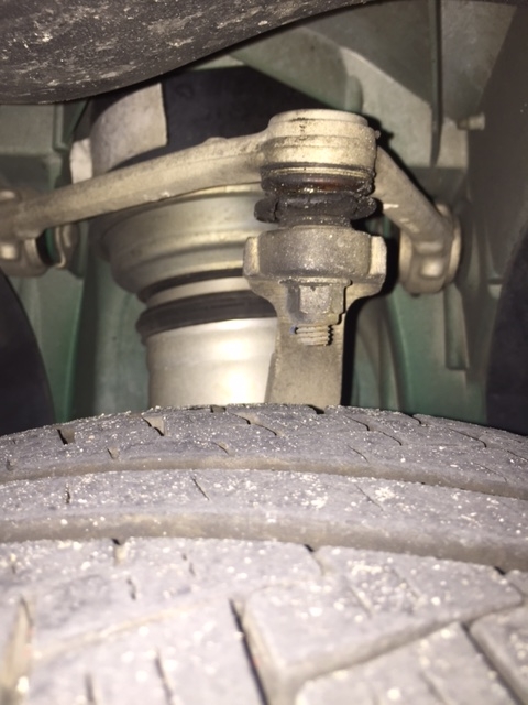

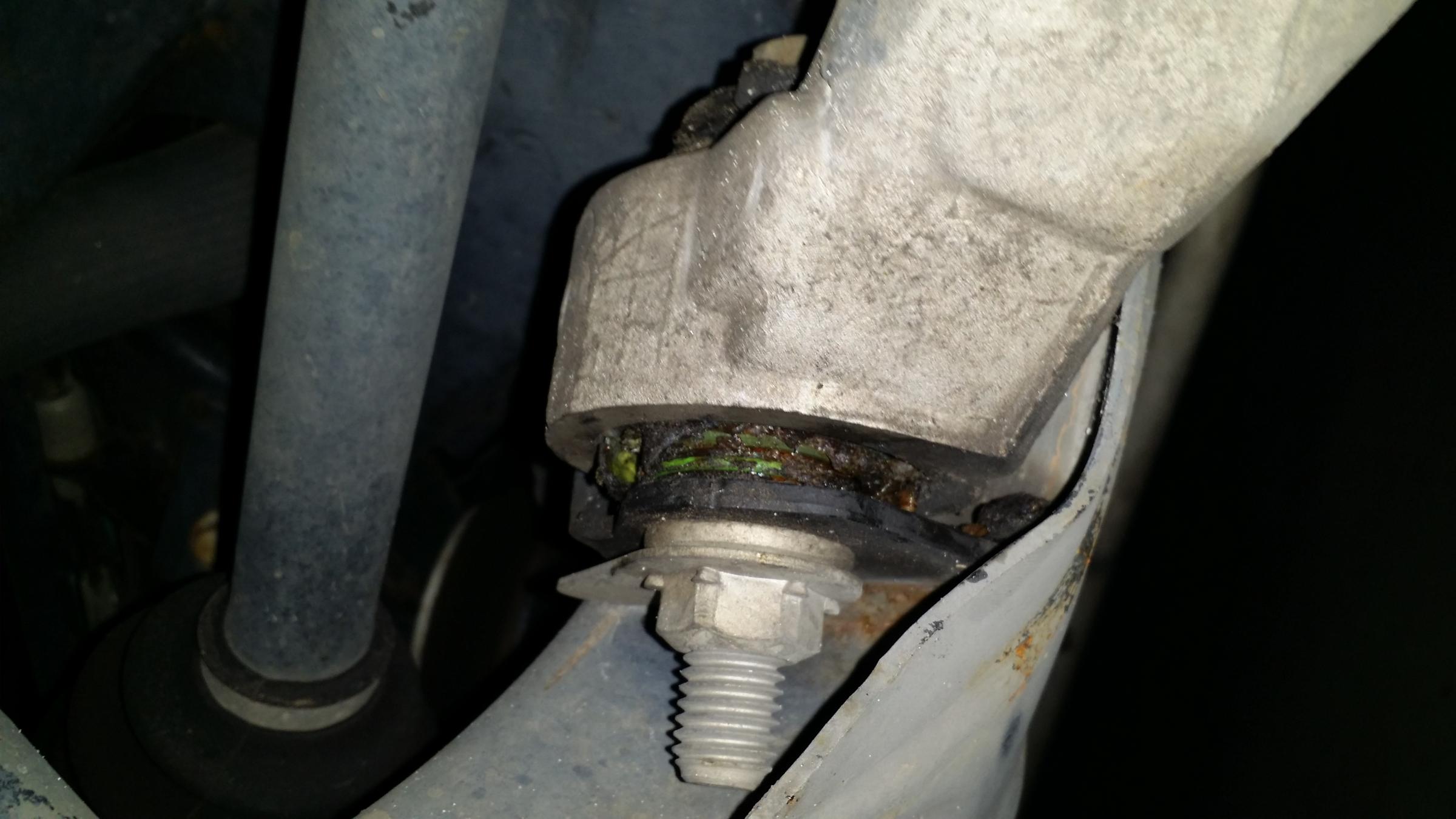

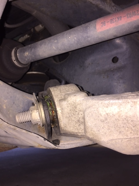

Ok here is a few photos. I will add more soon.
You may think this is funny, took the wheel off last night (RR), the nut on the ball joint bolt was so loose that it could be taken off by hand...... Needless to say that wheel doesn't move around so much any more. Took it for a test drive and maybe a 40% increase in handling. Can not believe two different techs missed that. I am embarrassed lol.
The bushing issue is not non existent though. The lower latteral arms on the rear are the worst as you will see, the upper ball joint seems to be just fine. One of the bushes on the upper rear arm looks toasty..
Pic 1 is Right Rear Upper Ball Joint
Pic 2 & 3 are of the two bushes on the Right Rear Upper Arm, they look acceptable.
Pic 4 is the busted Rear Inner bush
Pic 5 is the busted Rear Right Upper Arm bush.
More to come, I'll update this post with part numbers for the images. My verdict is on that rear upper right hand arm, that only one bushing needs to be replaced, so I wont be ordering an entire arm. Thoughts?

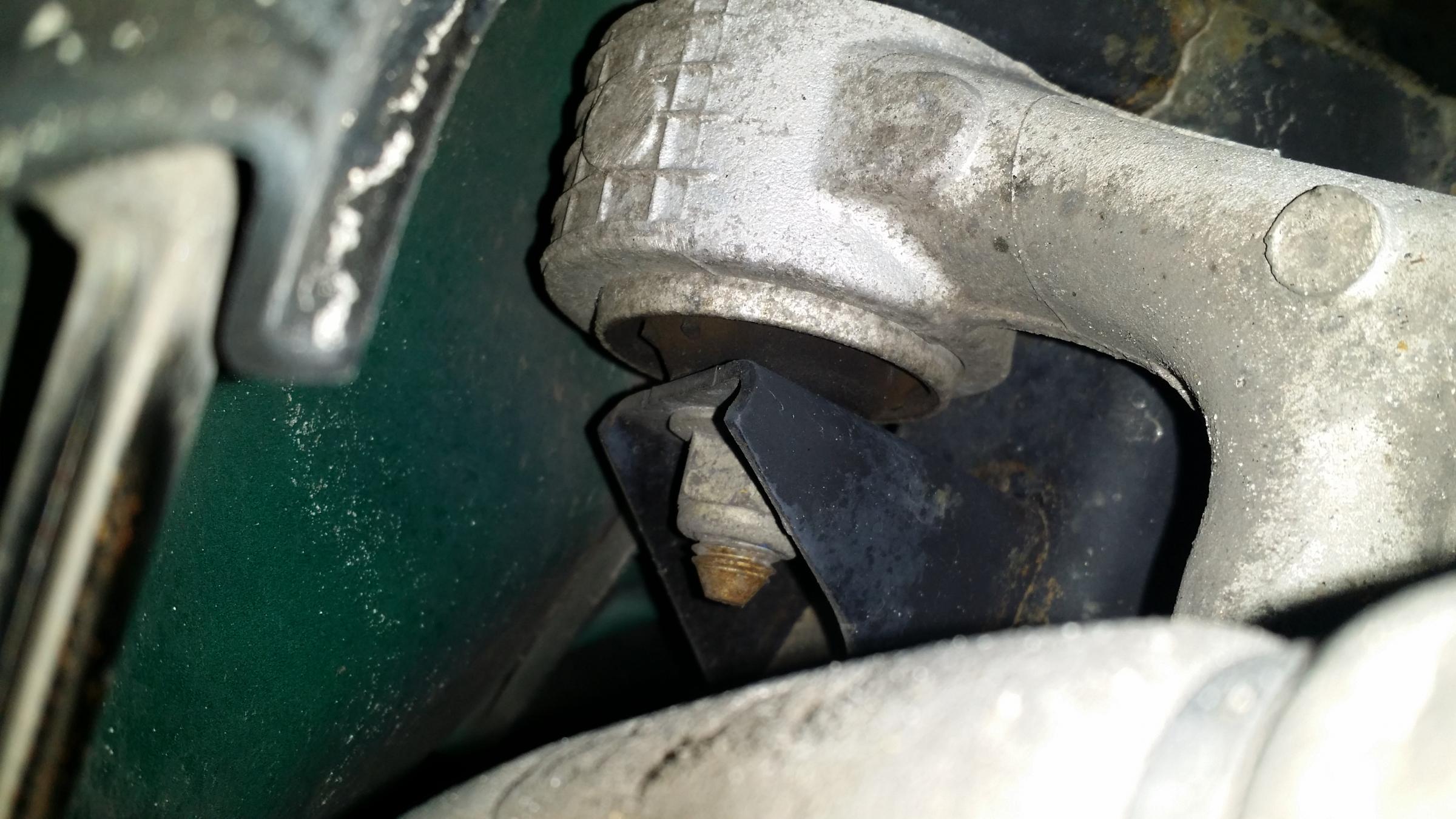

Here are some decent images, they are labeled in the image description. Interestingly enough the Lower rear arms are stamped SC (Super Charger). That answers my tolerance question.
I am going to go poly bushings on the rear lowers and replace them all at once since I will have the arms out of the car at that point. Part Numbers coming soon.

My, my, that car is clean underneath ! The air springs look new !
Very, very, useful pictures. It looks like you need to replace the bushes on both lower arms.
On the upper arms, if the steel ball joint is good but the boot is knackered, you can buy boots on the internet. just take measurements and find one the right size. However if the ball joint has worn out, you cannot get replacements, you have to buy the whole arm. These ball joints are not exclusively Jaguar, being of Ford origin as is the whole suspension front an rear so getting the boot should be fairly easy.
Again, one of the anti-roll bar links has a knackered boot, so again, if the joint is OK, get a new boot. For any of these steel ball joints, you should try to work some grease in before putting new boots on.
One trick for re-bushing is when ready to draw out the old bush, pour a couple of kettles of boiling water onto the arm near the joint. It expands the aluminium around the joint thus making it easier to push out. Same thing for pushing in the new joint.
BTW are you sure you can get polybushes for the ball-type originals ?

Are the air spring units filled with fluid?? It seems like one of them has some residue on the upper part due to some sort of leakage..?
Old Jan 19, 2015 | 04:36 PM
Fraser Mitchell's Avatar
Posts: 9,555
Likes: 2,553
From: Crewe, England
Well, Naso, lol, your car is the same colour as mine, Jaguar Racing Green. Very nice !! I have stick-on leapers on each front wing low down just behind the wheel arch approximately where the old XJ Series 3s had a leaper badge. You also got a good price if that was a UK pound conversion
I think you'll find there are no polybushes available for the ball-type joints, but anyway you can now get these separately. At one time you had to buy the full arm with joints. If it were me, I'd replace with the same type of joint. The kit I found on the internet, did show what looked like a polybush for the silentbloc bush on the arm. Polybushes are a very common swap-out for silentbloc bushes. The lower arm has two ball-type joints and a silentbloc type. AFAIK, the joint has a ball internally so the arm has more angular movement relative to its securing points.
Have you checked the ball joints on each anti-roll bar (sway bar) link. These can fail, (I had to replace one 3 years ago, they are not expensive)
I got mine from this company. You'll see the "-A" on the part number indicating it is aftermarket. So far it is wearing well. Obviously I use UK suppliers if I can, it costs less.
JustJagsUK.com - Jaguar Parts | Jaguar Wishbones, Control Arms & Links
As for fluid on your air spring unit, clearly there is damper oil in the shock absorber, but your's is the first post I have seen with this mentioned. The shock part of the air spring is very long lived, not so the air spring part, where the diaphragms don't seem to last very long. Arnott Industries do service exchange air springs with new diaphragms fitted, but leave the shock alone, (at least that is my understanding). Where exactly have you seen this fluid, on the shock top inside the trunk or underneath somewhere ?
What miles on the car, BTW ?
Edit
PS, if your swapping out the ball-type bushes on the lower arm, you must maintain the distance between the two bushes or it wont fit. Measure it up before pushing out the old bushes.
Old Jan 20, 2015 | 10:28 AM
Naso--Lituratus's Avatar
Joined: Jan 2015
Posts: 409
Likes: 89
From: North Carolina
Yes sir UK conversion. They fetch 12,000 american all day so I feel like I definitely scored. Is it Jaguar Green or British Racing Green, you'll have to link me the leapers.
My father inlaw was finally free to look at the car yesterday, he works at a shop, he looked over the car, changed the oil and such. He was very surprised at how clean it was, he said those ball joints pictured have zero play, told me the independent ships I went too were trying to grease me for work. His honest professional opinion was that I have at least 20,000 miles to go on what is on the car before I see "problems". Those rear lowers I posted a picture of are the main issue now. Phones dying I'll post back in a moment.
Milage is in my signature, 87,000.
