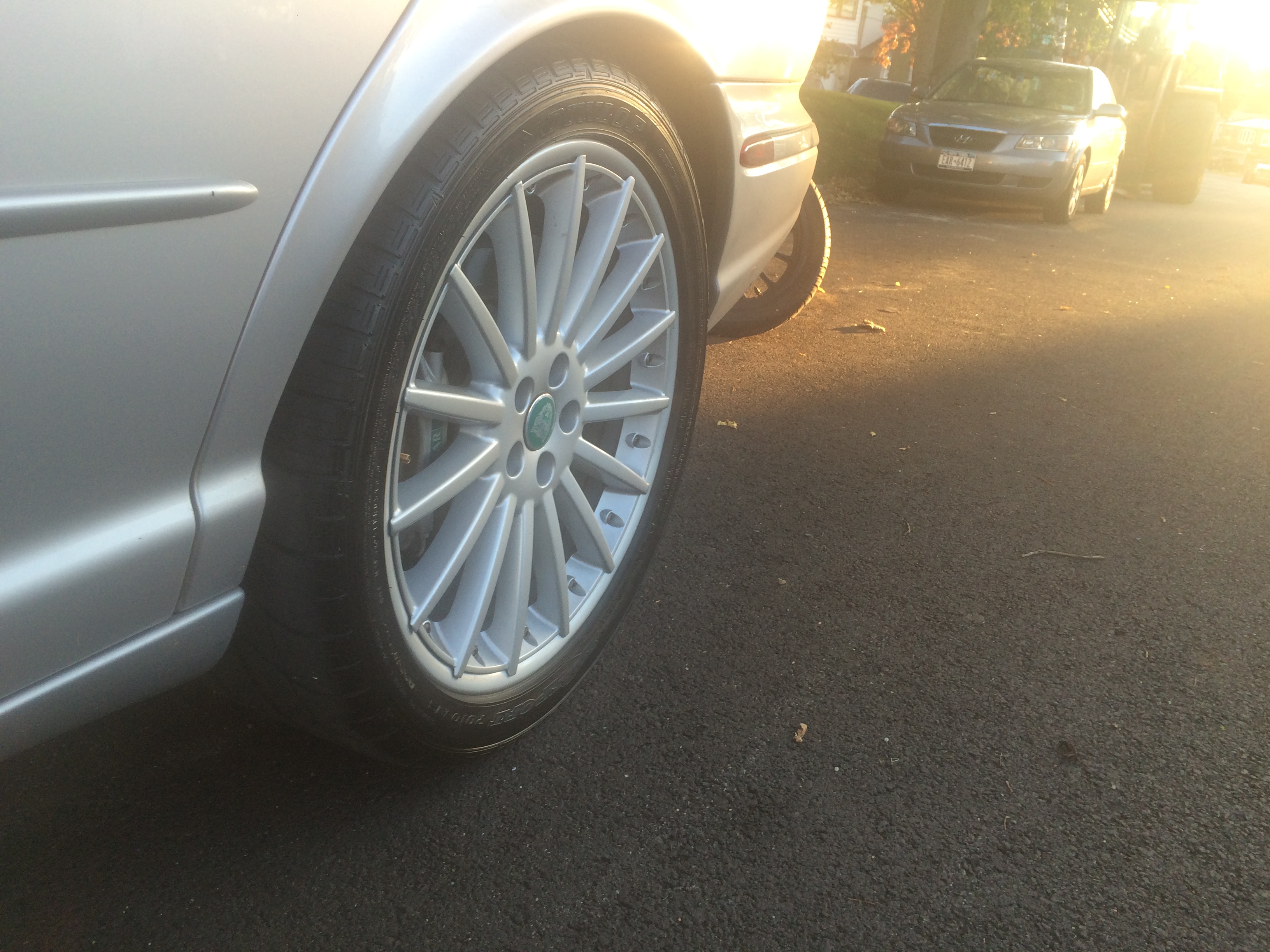

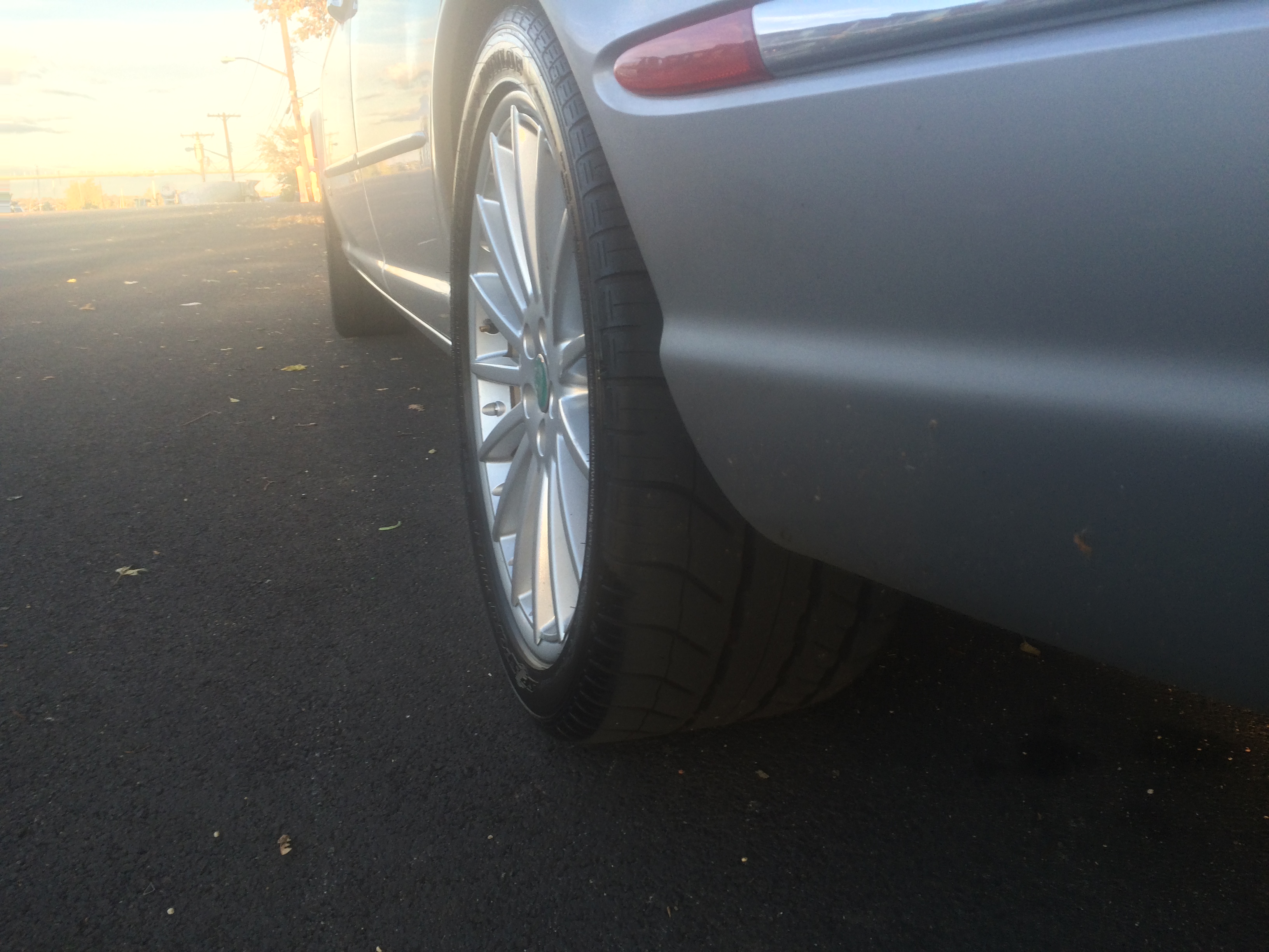

Well Wasn't so sure they were going to fit but after a week of driving so far no rubbing whatsoever. Basically after bending a rim I wanted to go with a tire that would give me a bit more protection. That meant a bit taller or a bit wider.....What I found was a set of tires off of a Nissan GTR. 285/35/20 and 255/40/20 for the front. Originally I was looking at 265/35/20's...But what the heck.
Now if I can get away with lowering the car a tad that be great as well..Anyways haven't loaded the car up with a load of people but cornering, dips and such have not caused a rub whatsoever. Here are some photos...
Once I get some people in the car I will report back. Ill tell you one thing however. It rides so much better. Seriously
Attached Thumbnails Sepangs with 285/35/20-img_3416.jpg   Sepangs with 285/35/20-img_3417.jpg

I havent had a rub yet. Currently in Vegas for the week but when I get back to NYC Ill beet the crud out of it a bit. So far though I did about 50 or so city/highway miles and some hard cornering, braking and wavy roads....Nothing. It hits the bumps no much better as well. The tires are made to protect the rim lip and do appear to buldge a bit more than stock which is expected. However the tire contact patch on the road seems pretty good. It looks good and when run through water it seems ok...Anyway I don't car so long as I don't bend the rims so easily next time

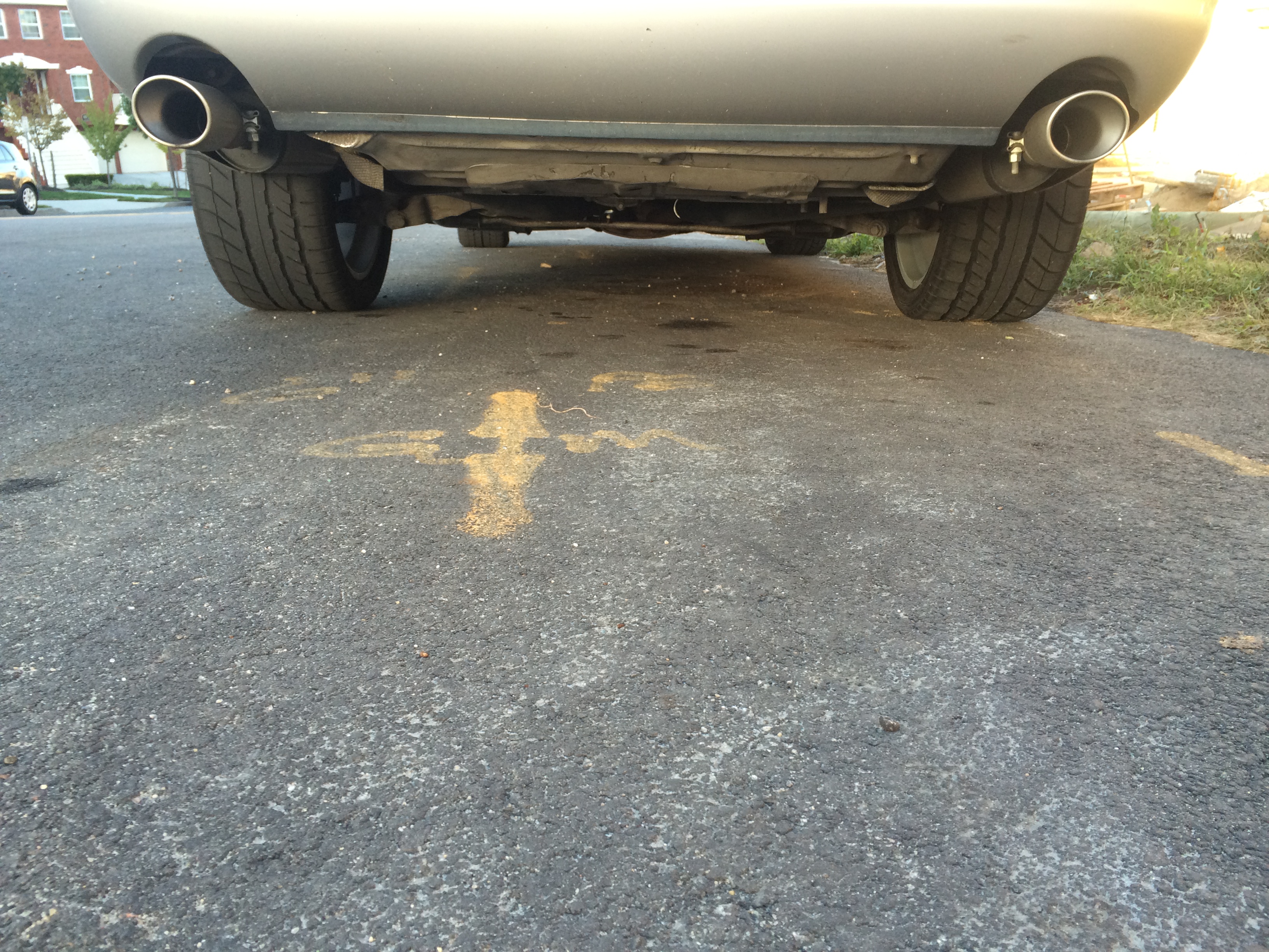

now with better photos....may just need that lowering moduale...SO far so good. Loading up the car now with 4 big burly guys...Will see how that goes

btw fronts are 255/40/20. After some very aggressive driving I can say absolutely no tire rub with three 250lb dudes. Handles a ton better and drives a ton better. Hits bumps like a dream....definitely my new tires size for there rims from now on
