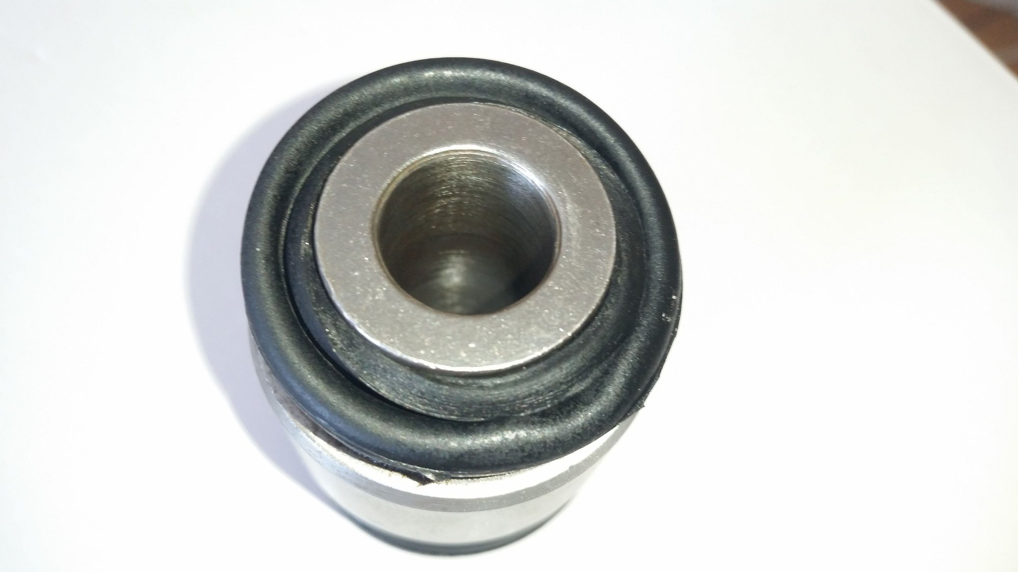

That's quite a list! I have been dealing with my front suspension creaking for some time now myself. I poked my head in under the car this afternoon to find out that the hydra bush on my drivers curved control arm (MAS auto p# CA 20237 which I believe has been superseded) after less than a year. As well as the beck/arnley 101-7517 air shock bushing on the same side.
Check over all your parts when you receive them! I'm actually very concerned at the moment considering my "brand new" 101-7517 looks like this:
