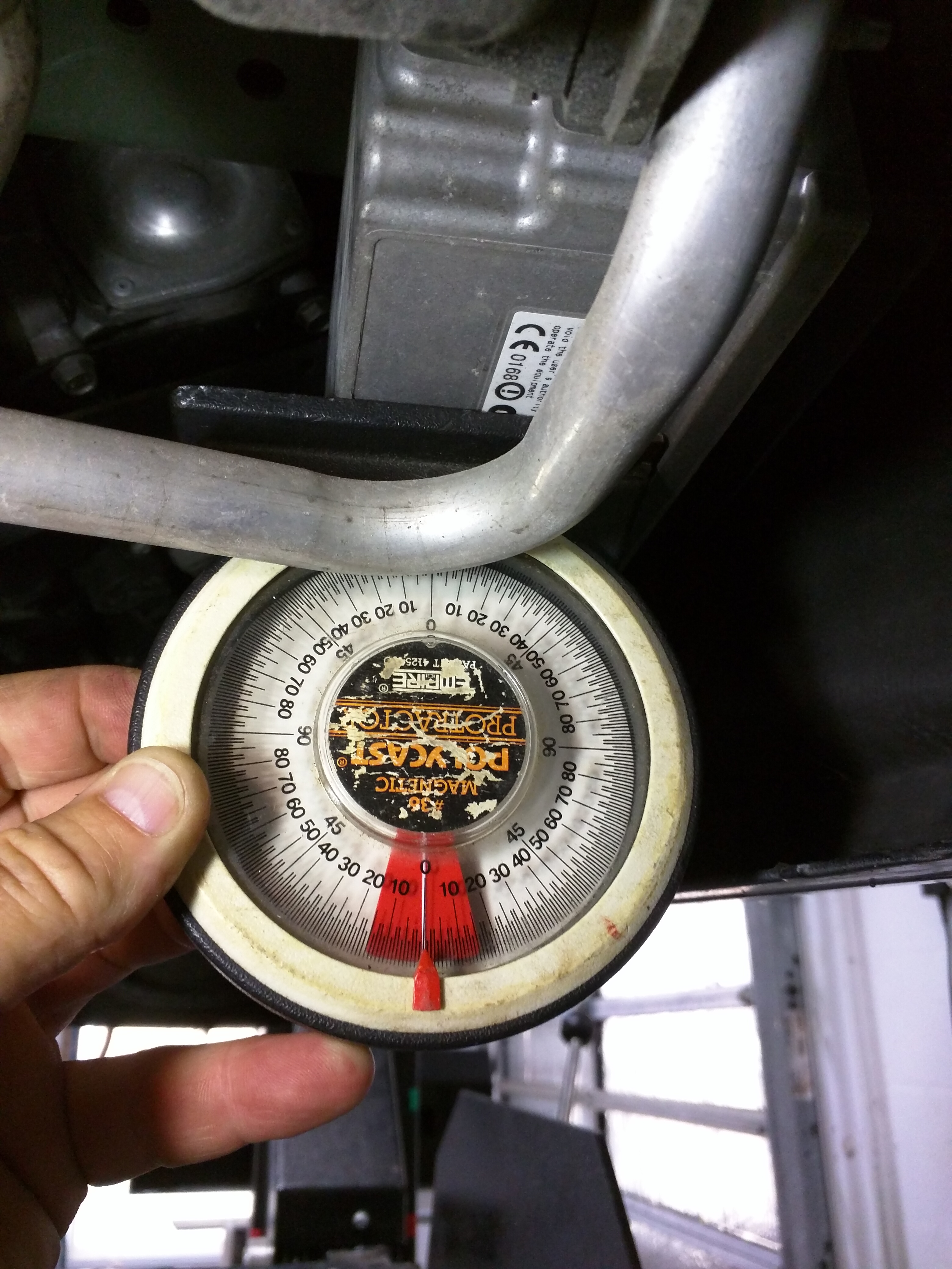

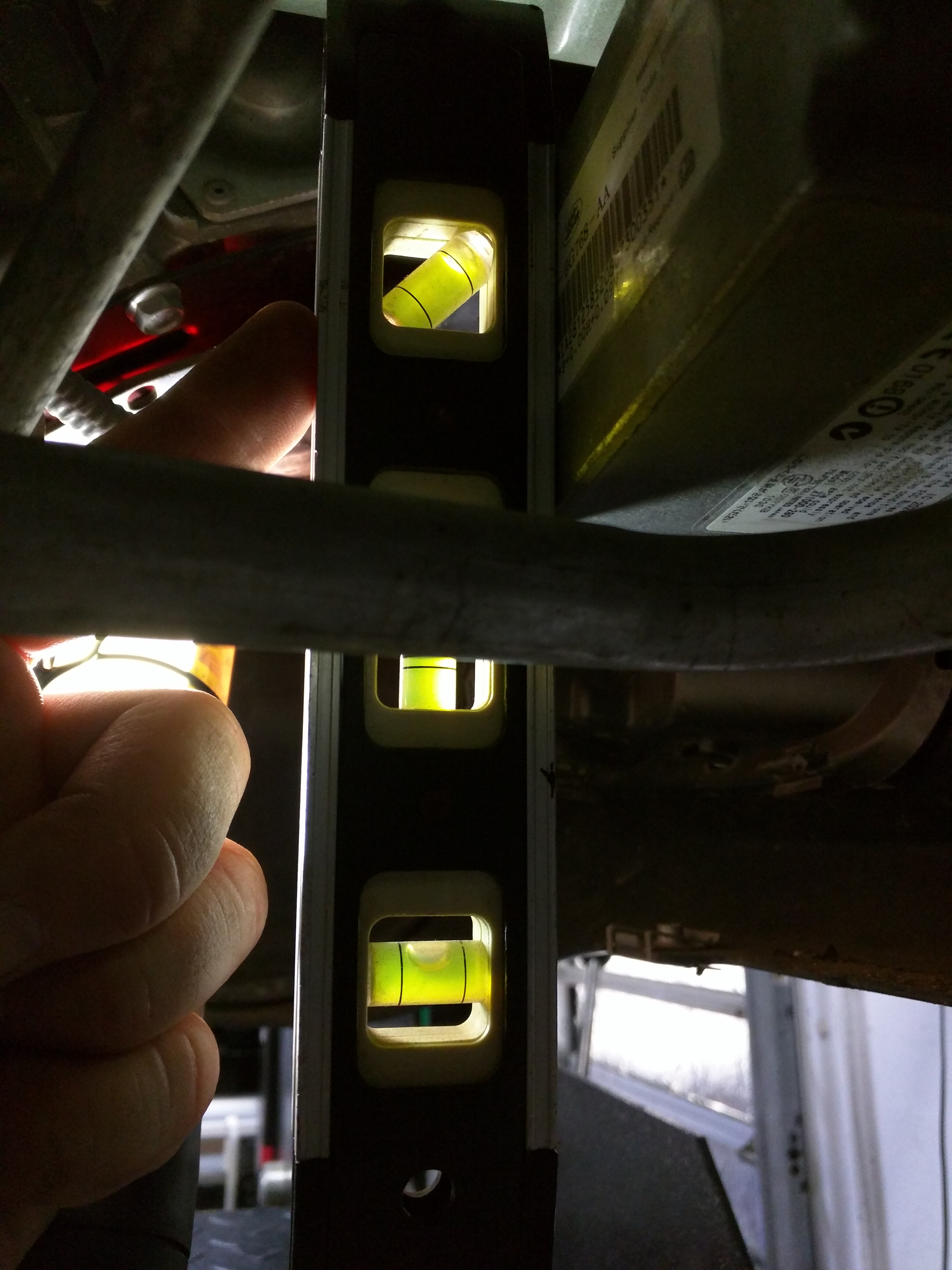

Default FIXED!
I put the Jag up on the lift and pulled the front gravel try off. I could easily access the ACC radar sending unit from there.
I noticed right away, that the unit looked as if it was facing down toward the ground..about 20 degrees , which did not make sense to me, as the unit needs to see vehicles and objects in front.
I made sure the car was at its normal ride height with all the air suspension at its driving setting.
I then put a level and then a degree meter on the back side (see photos) and set the unit right at level, 90 degrees to the ground. Easily moved the unit by hand.
IT IS FIXED AND WORKING PERFECTLY NOW!
Thank you all for your help, very pleased!
Hope this helps others in the future
