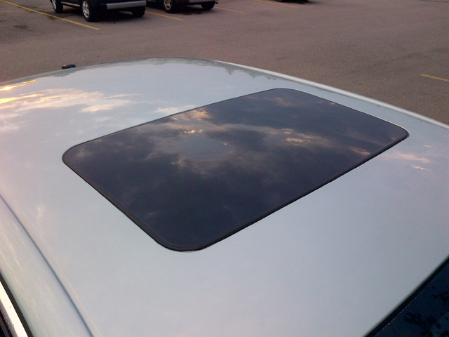

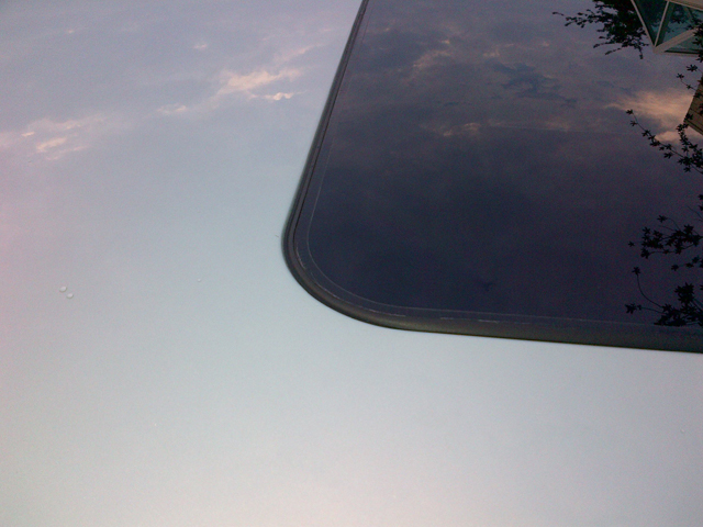

Old Jul 8, 2013 | 06:27 AM
Awgy's Avatar
Posts: 30
From: Canada
Here are some pics of the sunroof. It is difficult to show detail at the seal with the seal and temporary gasket in place.

It looks slightly high, not fully closed...but it is dificult to tell, you are correct. I'm going to take some pics of mine and post up.

The angle the picture was taken at makes it look as if the sunroof panel is sitting high, but it's not. Try putting some paper (single sheet) between the sunroof panel and the opening and see if the paper goes in easily. On mine it goes in easily in some places (at the corners where the seal has to go a greater distance). In the other places at has only slight restriction. Now that I have added a temporary gasket the drainage system is not overwhelmed and no leaks onto the headliner. Keep in mind that I would never have known this if I had not recovered the headliner. Water comes down behind the rear seat (via the C pillar) and makes its way under the carpet behind the drivers or passenger seat. Because the carpet is thickly foam backed it requires a sunstantial amount of water to pool before the carpet looks saturated. Also I am starting to think parking on an uphill grade obviously makes the problem worser because the rear draind would have to cope with all the water rather than all 4 if parked on level ground.
