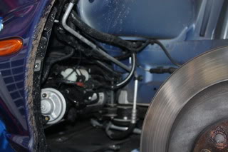

From: The black stump
The compressor, the round object in the foreground, is the horn, I removed this to give more room.
