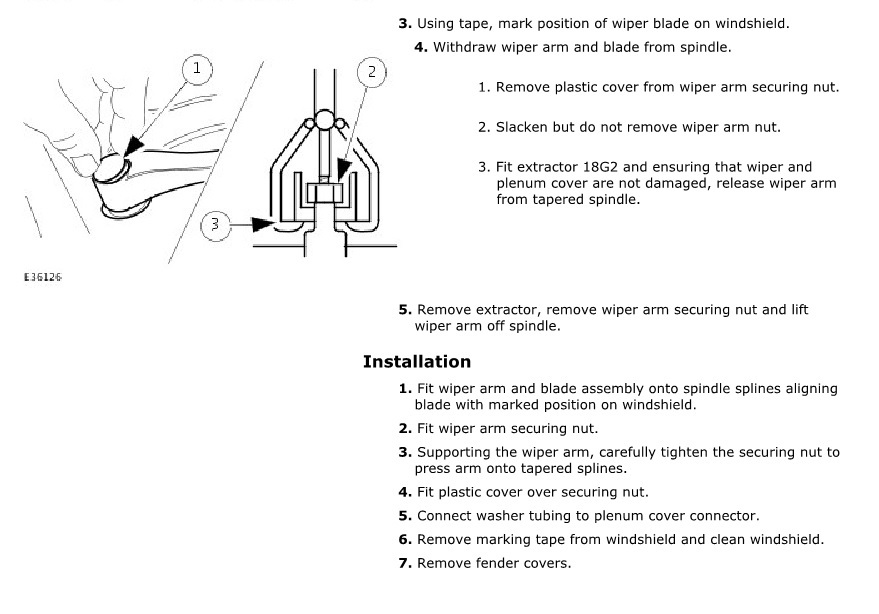

Your wiper seems to be the same type as my X308 - the attached pic shows the procedure to lift it off the spindle and put it back (a teensie-weensie bit further round!) -
You might need a little puller from Ebay (a few pence) to o it easily)

There is a measurement in JTIS, its 56mm from the cover panel on the drivers side and 61mm on the passenger side at the wiper tip.
