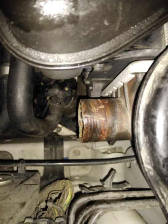

The sensor is in, but without the tab that clips the wiring assembly to the sensor. I thought everything was great after I fixed the clamp. I drove about 2 miles to my daughter's house where after a hour I topped off the system to get rid of the low coolant message. Then I drove home and checked it again because the message came back. The tank was empty. When I added water I heard the unmistakable sound of water striking the driveway..
About dark I went out and pulled the expansion tank one more time. This time I believe I had not pushed the heater hose onto the quick connected on the bottom of the expansion tank firmly enough and it was not fully connected. I had pushed it on until I heard a click but now I think the spring clip may have still been pulled out when I installed it and the click I heard was just the clip snapping into place on the hose not the same as when the quick connect it actually fully connected. However, I now see another potential issue. Since I have now removed the upper radiator hose at least 3 times since I initially replaced it, I have concerns about the radiator itself. Last night I had placed a plastic container under the car to catch any coolant and when I was connecting the hoses I heard something strike the bottom of the container. It was pieces of the radiator inlet's flared end. Meant to help secure the hose, now all I have are the small grooved/lines cut into the inlet. Do you think it be alright or should I go ahead and place the order for a radiator? Here are before and after pictures.

Looks like replacement time soon to me.

Mine was like that, but it was also cracked where that inlet blends in to the radiator side tank. I couldn't see where the steam was coming from so I took it for a pressure test, they proclaimed the radiator tank cracked. Once I got the radiator out it was plain to see, but in the car, and as tight as things are up there at the front of the engine bay, it was impossible to see in situ.
The radiator is very cumbersome to remove! the fan and shroud are about an hour all by themselves. If you get an air conditioning shop to evacuate the system and disconnect the tope line to the condenser, that will greatly ease the pain of radiator removal. That upper line wraps around the top of the radiator and is simply in the way!

New radiator required and check the AC condenser pipe joints for leaks.
New o rings can cure any leaks.
