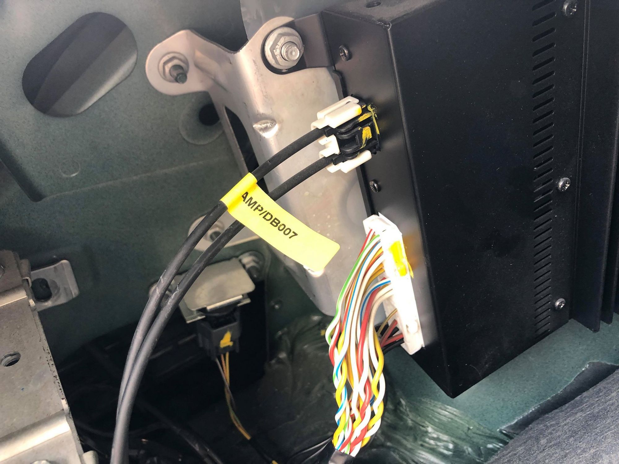

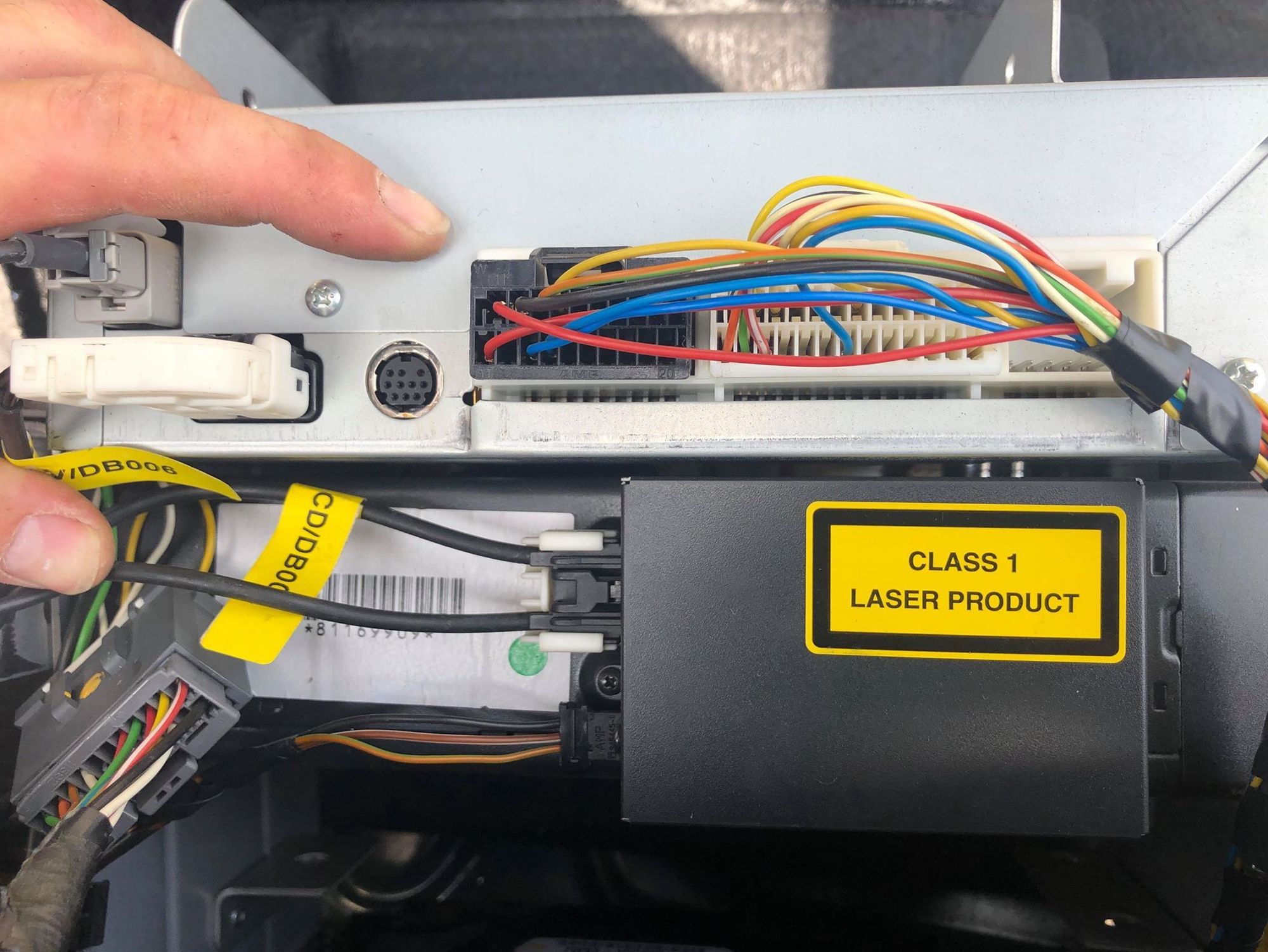

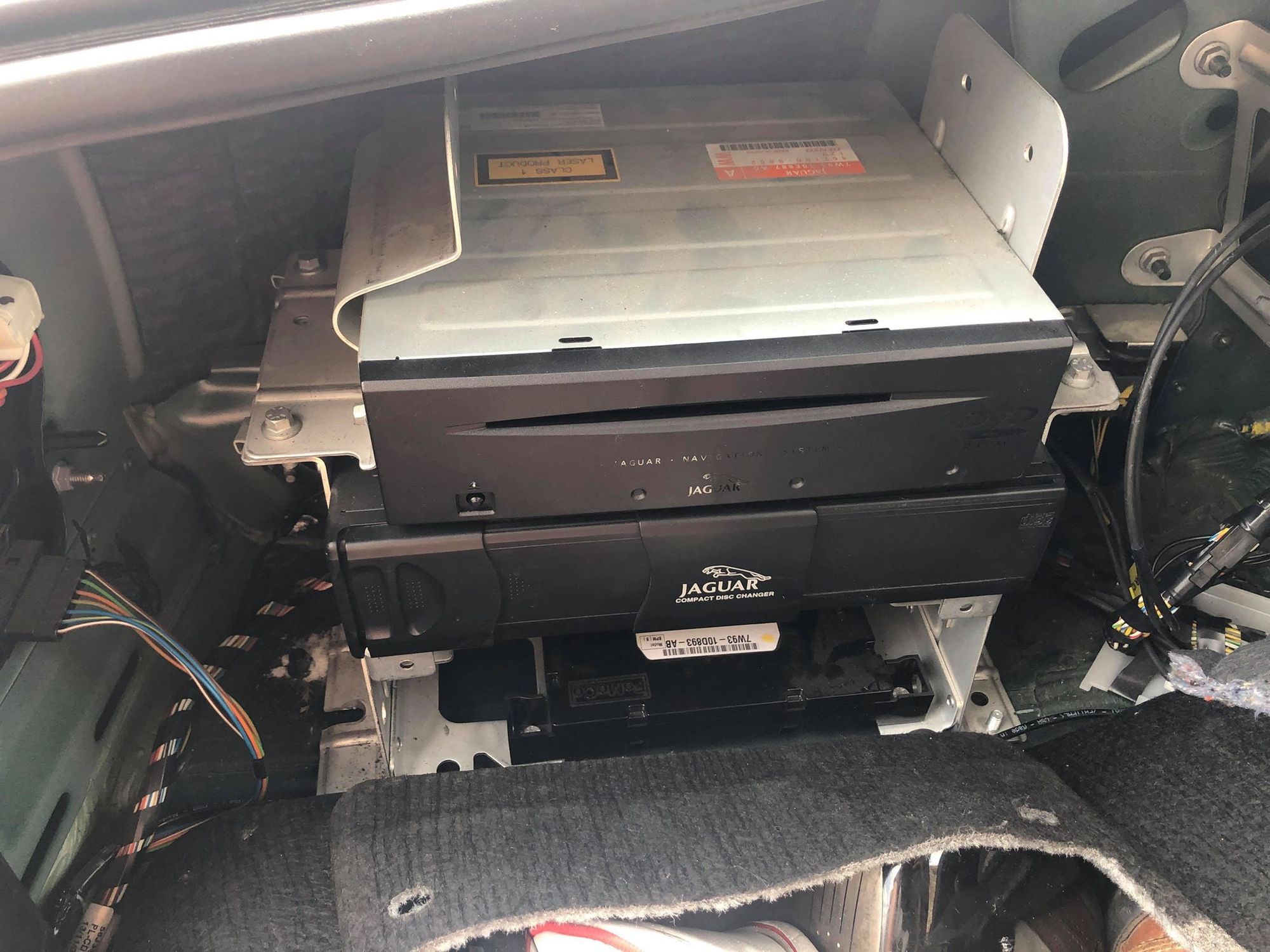

Yes, I know this has been asked many time before, but...
I have a 2009 VDP with Premium sound _ Alpine speakers and CD changer in the trunk/boot. I really dislike the phone call quality, but what I really hate is not being able to l=use my iphone to listen to music. I know there are complicated routes involving altering the head unit. Is there not a fairly simple way of tying into the CD line. I guess I would assume the one going to the Amp.
The first person to successfully help me with this will win the admiration from me, my wife, my family and even my parents. They are mostly deaf though.

No, it’s a fibre optic digital audio network carrying audio to the amp, no analog lines to tie into.
See my link in the thread currently next to this one for my DIY instructions for an aux-in mod to the single slot player in the dash.
