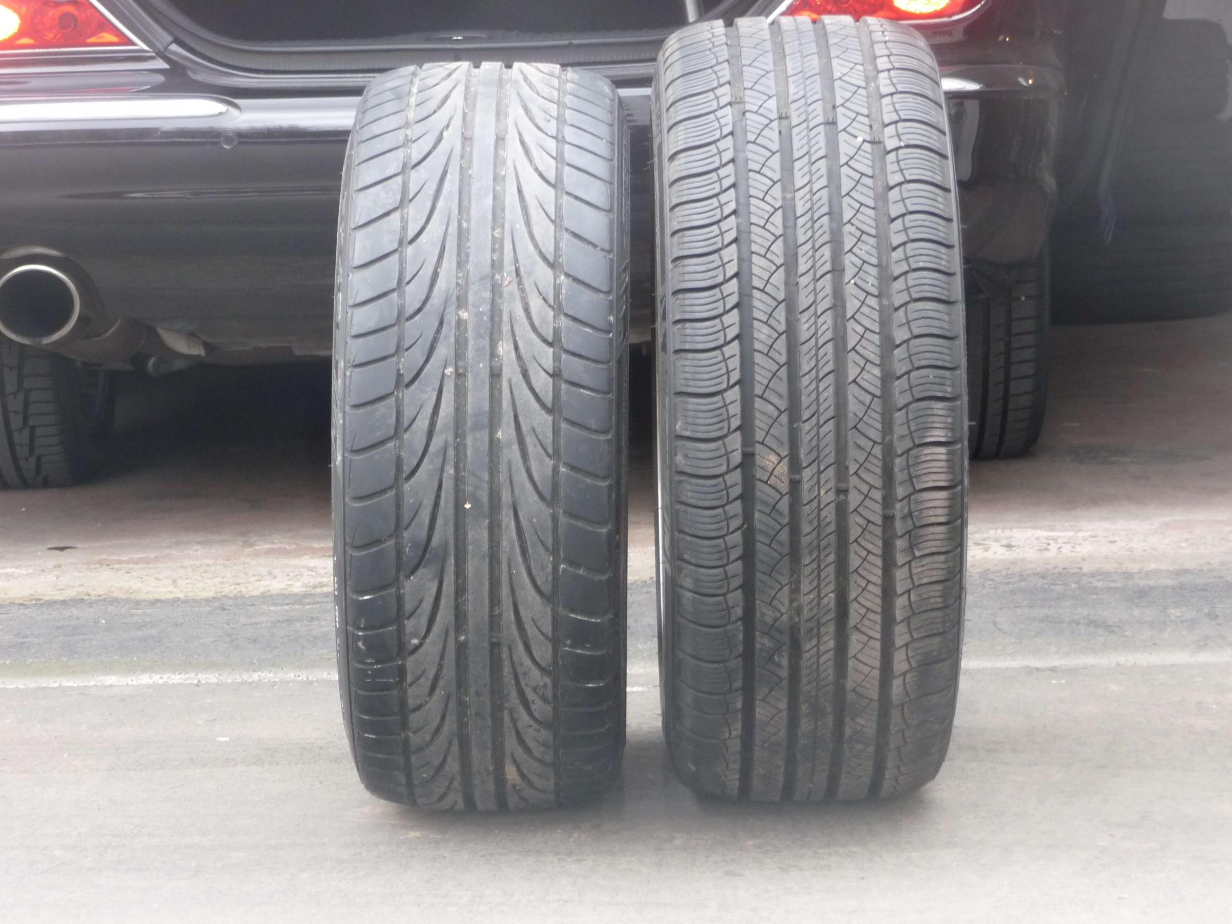

I put taller tyres on my 20" Callisto rims, specifically to be reassured against damage due to potholes.
Look at this thread:
https://www.jaguarforums.com/forum/x...-139921/page2/
The tyres now are 255/40R20 instead of 255/35R20, meaning that the diameter of the tyre is 1" taller and that you get half an inch of additional rubber on the sidewall to protect the rim:
No problem under the fenders and for the drive.
I'm very satisfied of my choice

No problem of speed reading whatsoever with the new 255/40R20 tyres.
Actually, the speedo is now accurate!
As all speedos, the speed reading with standard tyres is always pessimistic by a pew percent.
The new tyres increase the perimeter by only 3.6%.
I have checked my speed when controlled by warning radars on the highway and also by using the GPS. It is now exactly precise, e.g. 130 km/h when reading 130 km/h on the speedo. Same (even less) at 70 km/h
