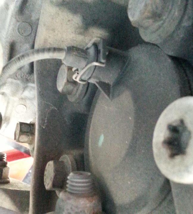

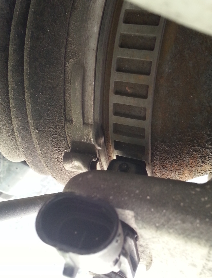

Finally had the time to pull my wheels off to check the speed sensors. I unplugged all four sensors, cleaned the tips with a damp towel, cleaned the rear sensor rings with a detail wire brush, connected all four sensors and went for a drive. I don't know which axle had the issue but all is well so far...
