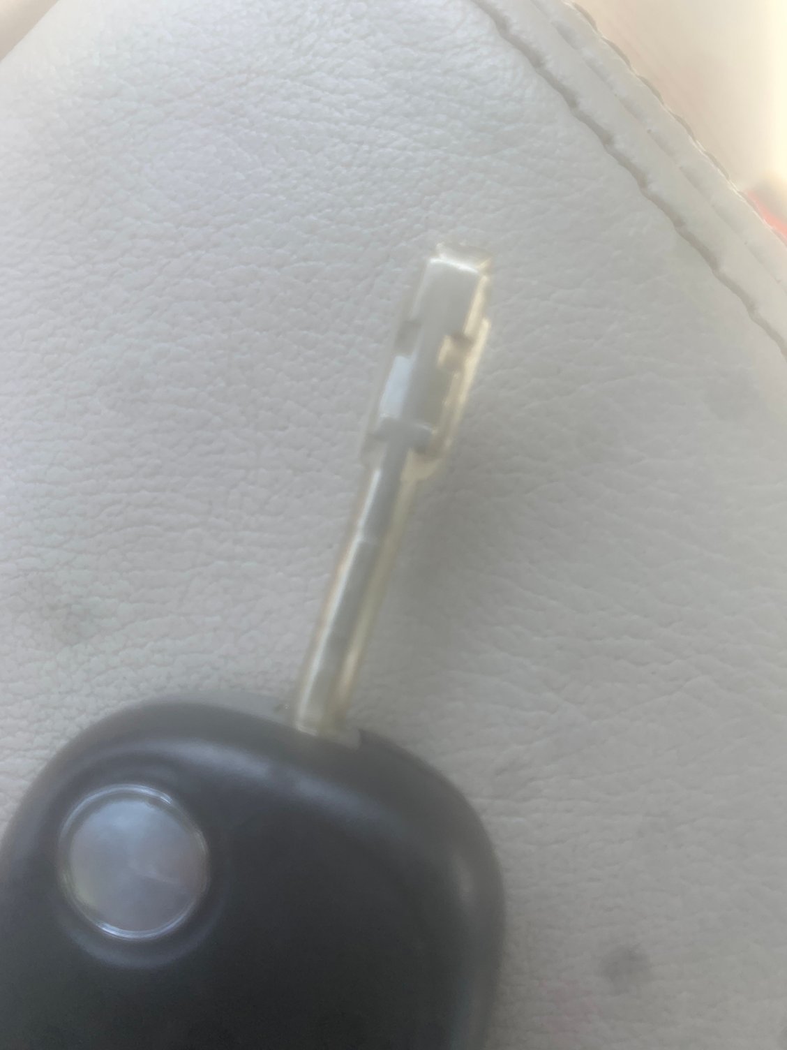

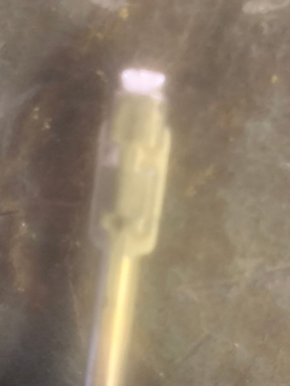

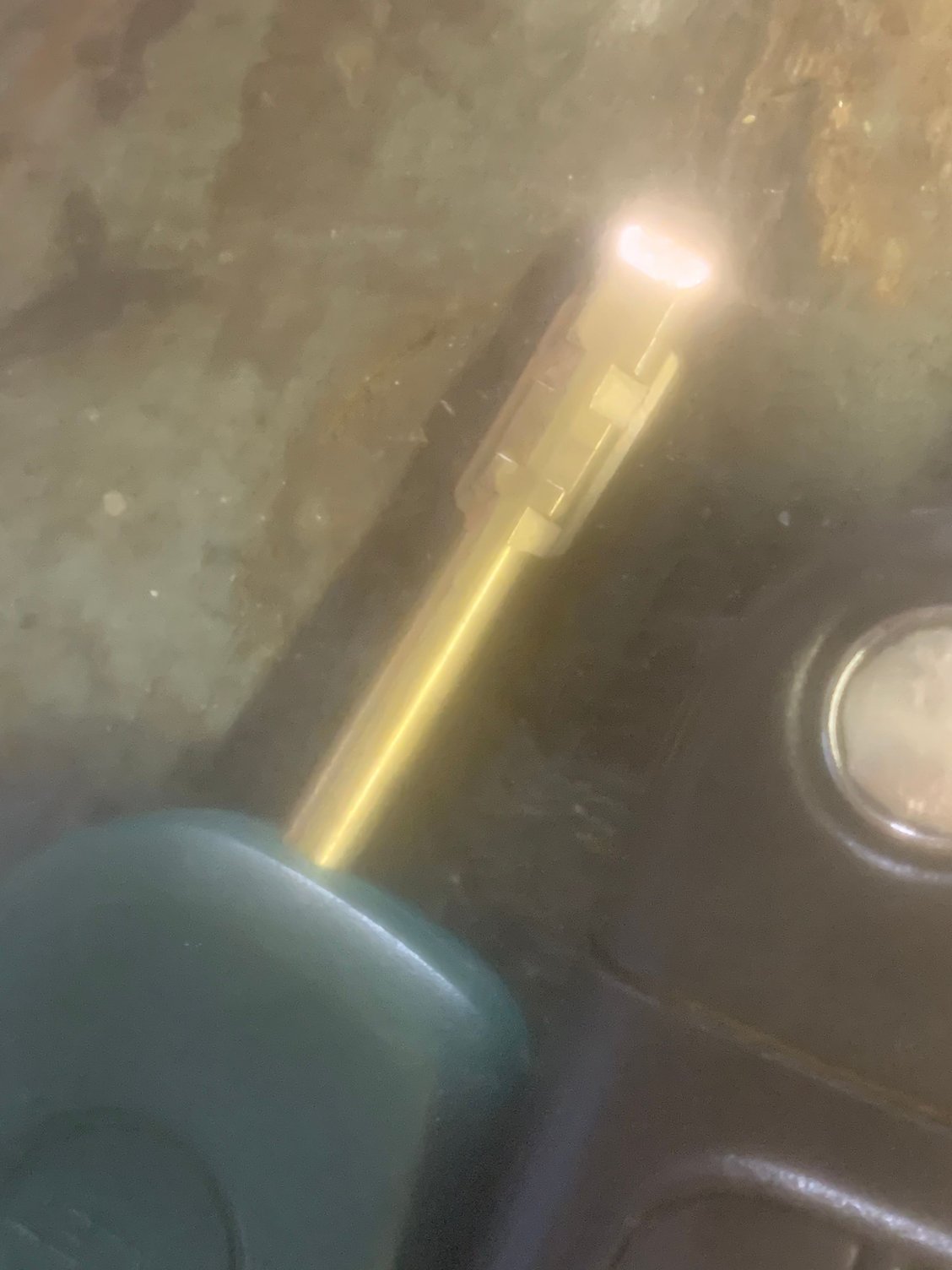

after mrkt. jag keys... the JMA f o-6p entry only ,locksmith supplied key....($47.00) is actually a Valet length ford key TOO SHORT .... to open trunk(chk. Xalty) ...but the fobik standard aftermrkt key($167.00) seems to be okay....but is not yet programed because of lack of confidence in locksmith to then recover my original key that we got out of the trunk. Does anyone know of difficulty in recovering an OEM jag 2008 xl key after adding a locksmith supplied aftermkt. key ??

Quote: after mrkt. jag keys... the JMA f o-6p entry only ,locksmith supplied key....($47.00) is actually a Valet length ford key TOO SHORT .... to open trunk(chk. Xalty) ...but the fobik standard aftermrkt key($167.00) seems to be okay....but is not yet programed because of lack of confidence in locksmith to then recover my original key that we got out of the trunk. Does anyone know of difficulty in recovering an OEM jag 2008 xl key after adding a locksmith supplied aftermkt. key ??
is the normal length key cut? it should open mechanically. programming the key can be done cheaply if anyone has IDS/SDD locally. i would do it for free but you’re 300 miles away

my normal key will unlock the car in valet mode from the trunk lock. every time. if there’s a transponder ring in the trunk i’ll be surprised.
the shafts are actually the same length, just the tip is modified to prevent opening the trunk lock.

I ordered a key on eBay that is very much like the factory key for less than $25.00. I then called around and found a locksmith fairly close to where I live and he was able to cut a new key for under $40.00 (in 2018). He made a practice key that has a place for the transponder if I obtain one. It will only lock the doors. Even with the car unlocked it will not turn the trunk lock. That is how the locksmith confirmed his cut was correct before he made the final one. I now have 2 keys programmed for all functions and a new one that will start the car. I just need to follow the procedure on the forum to program it for all functions with the other 2 keys. The locksmith did not have the ability to program. Still I now have an extra key for less than $75.00 and did not have to contact the dealer.
