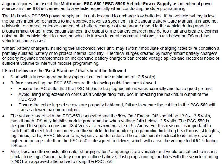

"The voltage target with the PSC-550 connected and the 'Key On / Engine Off' should be 13.0 - 13.5 volts, even though IDS only inhibits module programming when voltage falls below 12.5 volts. The PSC-550 is designed to supply a constant 13.4 Volts at a maximum rate of 55 Amps. For this reason it is important to switch off all electrical consumers on the vehicle during module programming including headlamps, sidelights, fog lamps, radio, HVAC blower fans, wipers, and defrosters. These additional electrical loads may draw a higher amperage rate than the PSC-550 is designed to deliver, which will cause the voltage to DROP during IDS use."

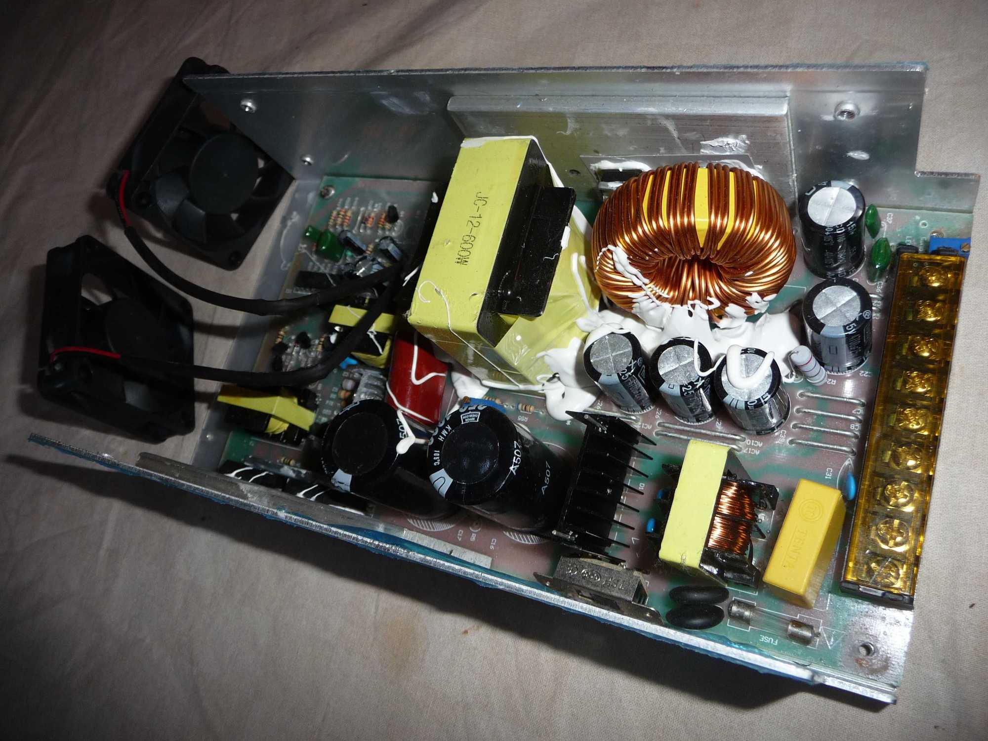

I also bought at first a cheapo chinese "50 amps" power supply.
When I opened it, I understood what crap it was:

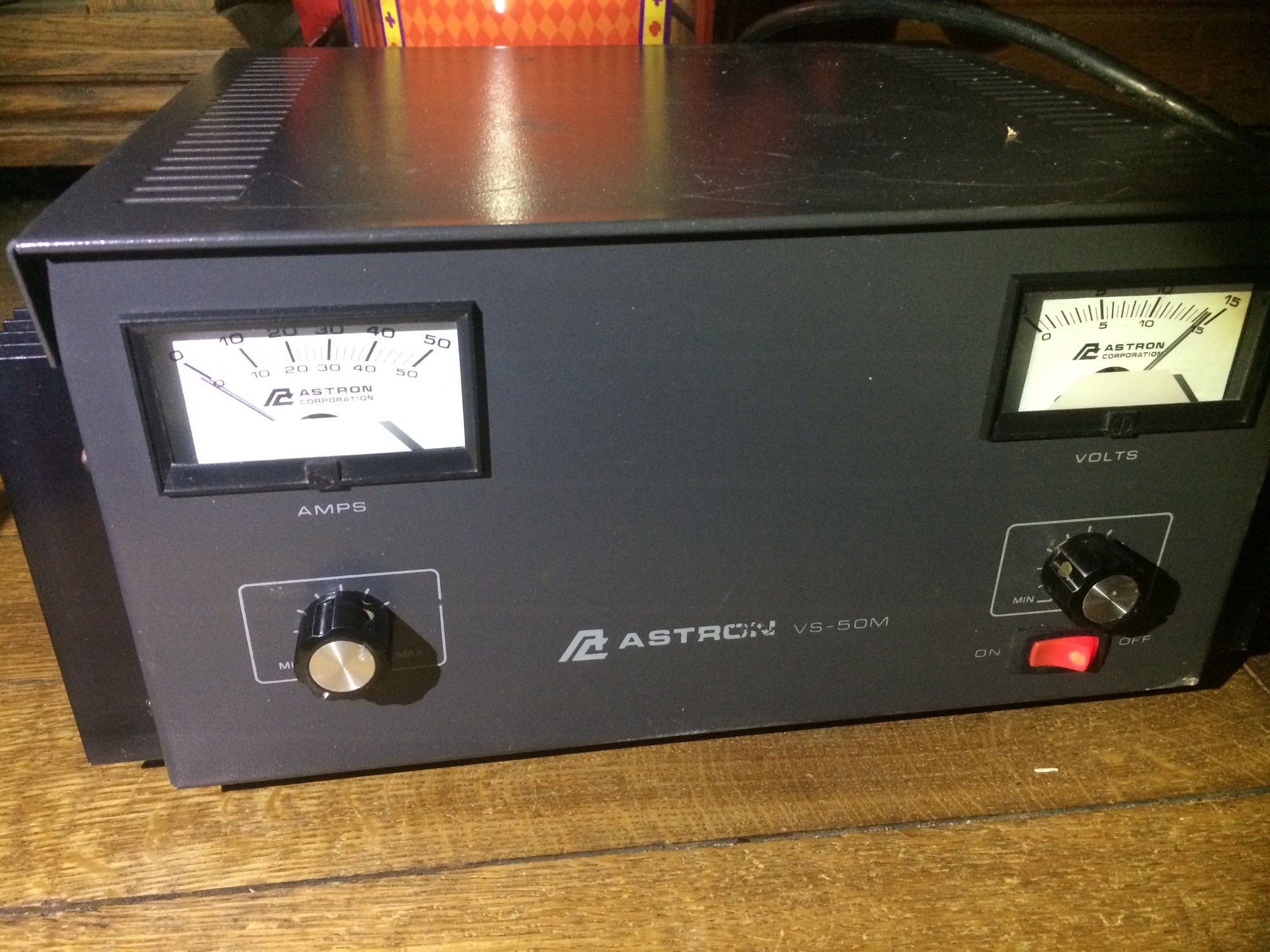

Since then I bought a professional heavy duty one (and very heavy indeed!):
Day and night!
One important remark: the electrical cables that go from the power supply to the car's battery have to be really thick.
To not loose voltage between the power supply and the car you better have 10 mm2 cables to conduct those 50 amps! Because even a loss of a few tenths of Volt along the few meters of cable can be detrimental and lead to a voltage of below the recommended 12.5 V at the battery leads...

I am attaching the Jaguar Technical Service Bulletin that Jaroslav linked to previously, and here's an important snip from that TSB that includes the part that paydase quoted:
There are several unfortunate accounts in these forums of members bricking their ECMs and other modules by disregarding Jaguar's mandate regarding available current during programming.
When I first began using SDD, I used a 50A desktop computer power supply, and I did not experience any problems. But when the opportunity arose, I acquired a good used PSC-550 so that's what I use now. Any quality power supply should be suitable if it has a minimum current capacity of 50 amps, tight voltage regulation (the PSC-550 spec. is <1%) and low AC ripple (the PSC-550 spec. is <50 mV). It is important to follow all of Jaguar's instructions regarding turning off all electrical consumers, etc. With SDD, it is possible to cause irreparable damage to the electronic control modules in your car.

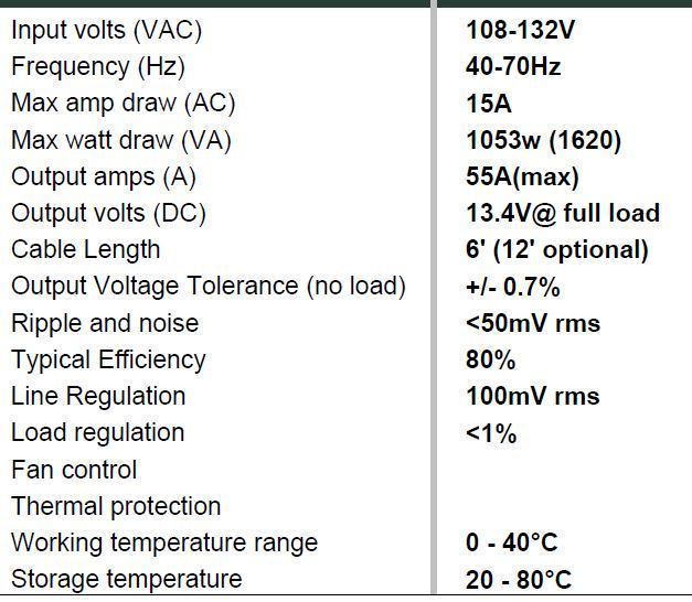

Listen to Don about the ripple measurement!
All those crummy u tube links are from people who don't have a clue.
If the power supply does not provide full specifications that is a giant red flag.
Here is what Jaguar wants when the car is attached to SDD.
Again note the ripple specification.
I have used SDD a good bit and while I can't explain it I have measure 30+ amp draws for hours at a time using a separate clamp on ammeter as I was curious about why such a stout power supply was needed.
