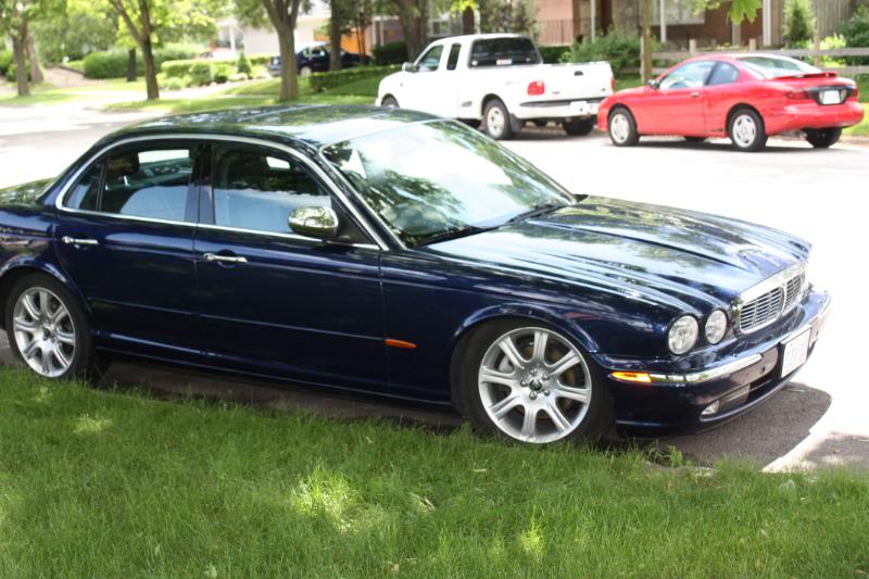

For the past two mornings the front of my car was sitting very low and the message was displayed, when I turn the car on it raises to normal height. I'm assuming it's a leak, what are the steps to troubleshoot this ? Just checked it again, It's the front left and right side and It lowered 5 minutes after I turned off the ignition. I just noticed other similar posts but I find it odd how both sides are lowering at the same rate and the back is fine.

The car may have lowered a bit before but not this much, there is about a one inch clearance. I may take it in and utilize my warranty.
