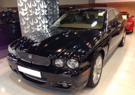

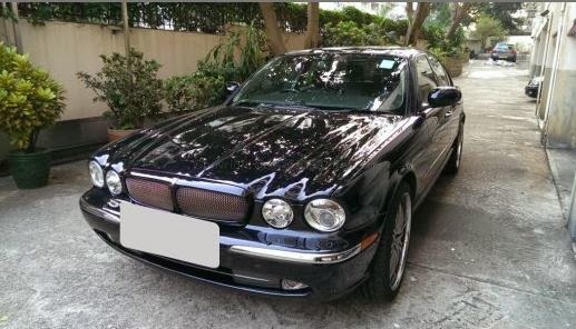

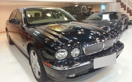

I took a view to two XJ8 today, year 2007 (x350) and year 2009 (X358) both are like new at only 30,000km on the clock. I looked at the front suspensions and the arms with a torch. They are all like new on the cars. The X350 is at a better bargain which 10% cheaper than the 2004 XFR.
Couple of questions:
1. The suspensions on these XJs are never replaced from new. How much longer can they last?
2. The sales guy said if the suspension worn out, there is "air cushion" part in the suspension can be replaced without replace the whole suspension. Which is 20% of the suspension cost. What could that be? it is true?
3. Is the sport mode button for XJ (like XJR). Is it fun to use?
XJR
XJ8 2007
XJ8 2009
XJR
XJ8 2007
XJ8 2009

Personally, I don't like the later restyle, but its an individual thing. I am surprised the 2007 is only 10% off the price of the 2009, I would have expected it to be a lot less.
Check the service records and take a test drive before making up your mind. Is black the only colour choice ?
