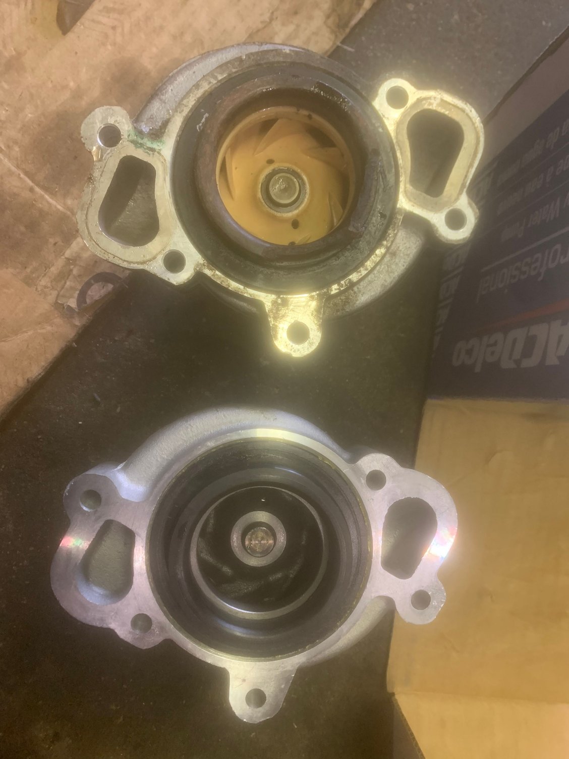

Originally Posted by Mark M
I'll be doing this job soon as well on my 2006 4.2 n/a engine with 110000 miles. Can you tell me though as its not clear online and lots of varying thoughts, when you installed the new waterpump did you use any O rings in addition to the metal gasket? As the jag parts diagram for the water pump shows the pump, the gasket and a 55mm O ring as well as a 70mm O ring, however it's not clear where these O rings go exactly and if both are used or just one or if its not necessary at all to use any O rings? Also did you remove all the throttle body to gain access first to remove waterpump?
Many thanks
Mark
there’s two types of water pumps
the discontinued one piece with an o-ring and a two-piece with no o-ring. the latter is the most common, only the acdelco pump still uses an o-ring. the pic below are the one piece pumps
