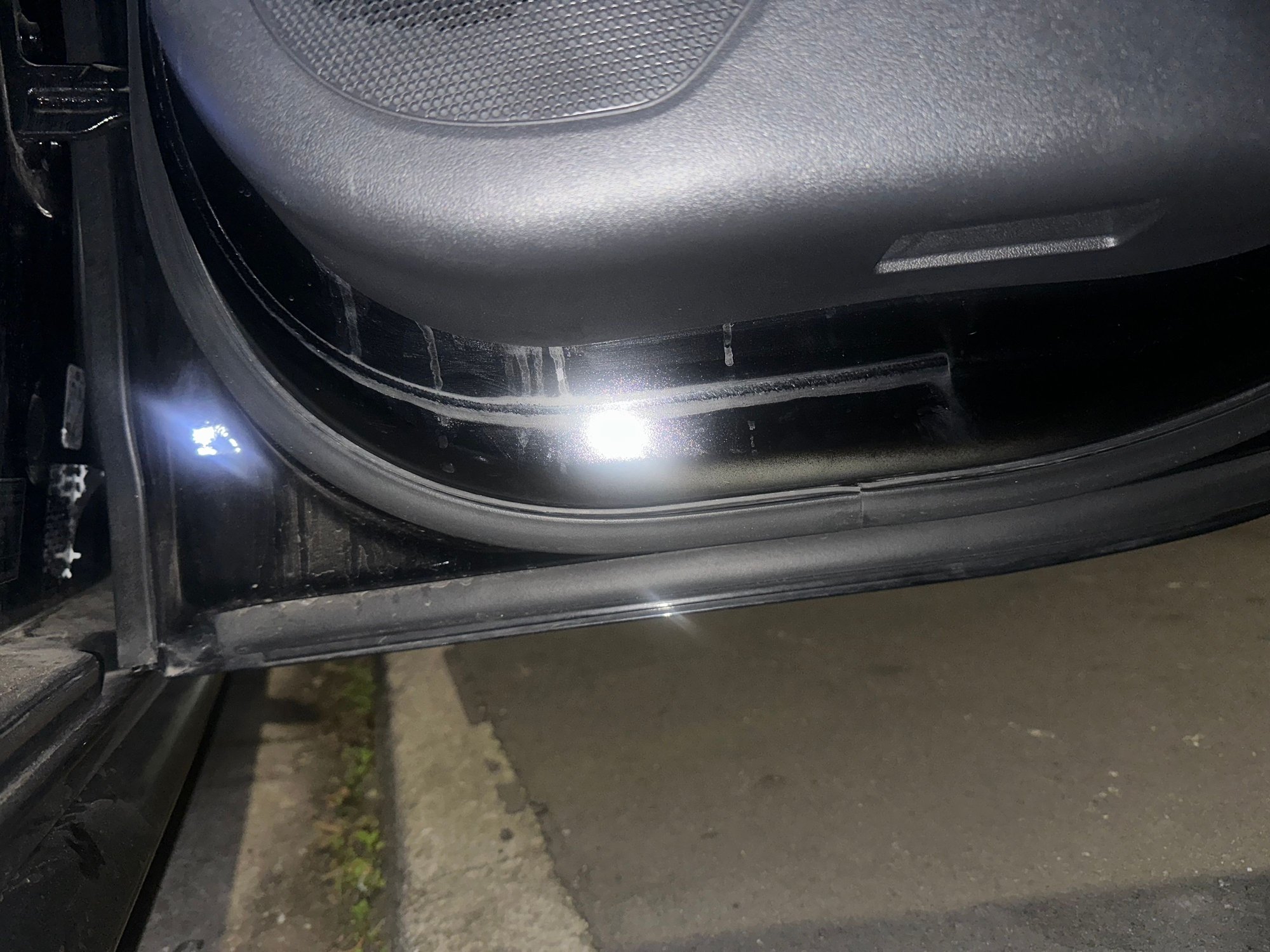

I still get the water in my passenger footwell which i believe makes its way to the drivers footwell, I’ve checked what u did in yours and I can see the previous owner has pulled and glued the seal at the bottom of the speaker, I’ve also noticed water lines coming from the door card which seems to be above the seal so it could mean this water is actually draining into the car from the door card, I’ve also noticed when it rains a lot and I’m parked with the car leaning left I don’t water in car.

Agree, I am inclined to believe an entry point is tracking water through the door card and into the footwell which I haven't seen previously reported here or in the TSBs. When I have a chance to do some testing, I will report back my findings.

Great let me know what you find, for now I’m considering drilling extra holes under the speakers to funnel the water out or better still remove the door card and see what’s causing the issue.
