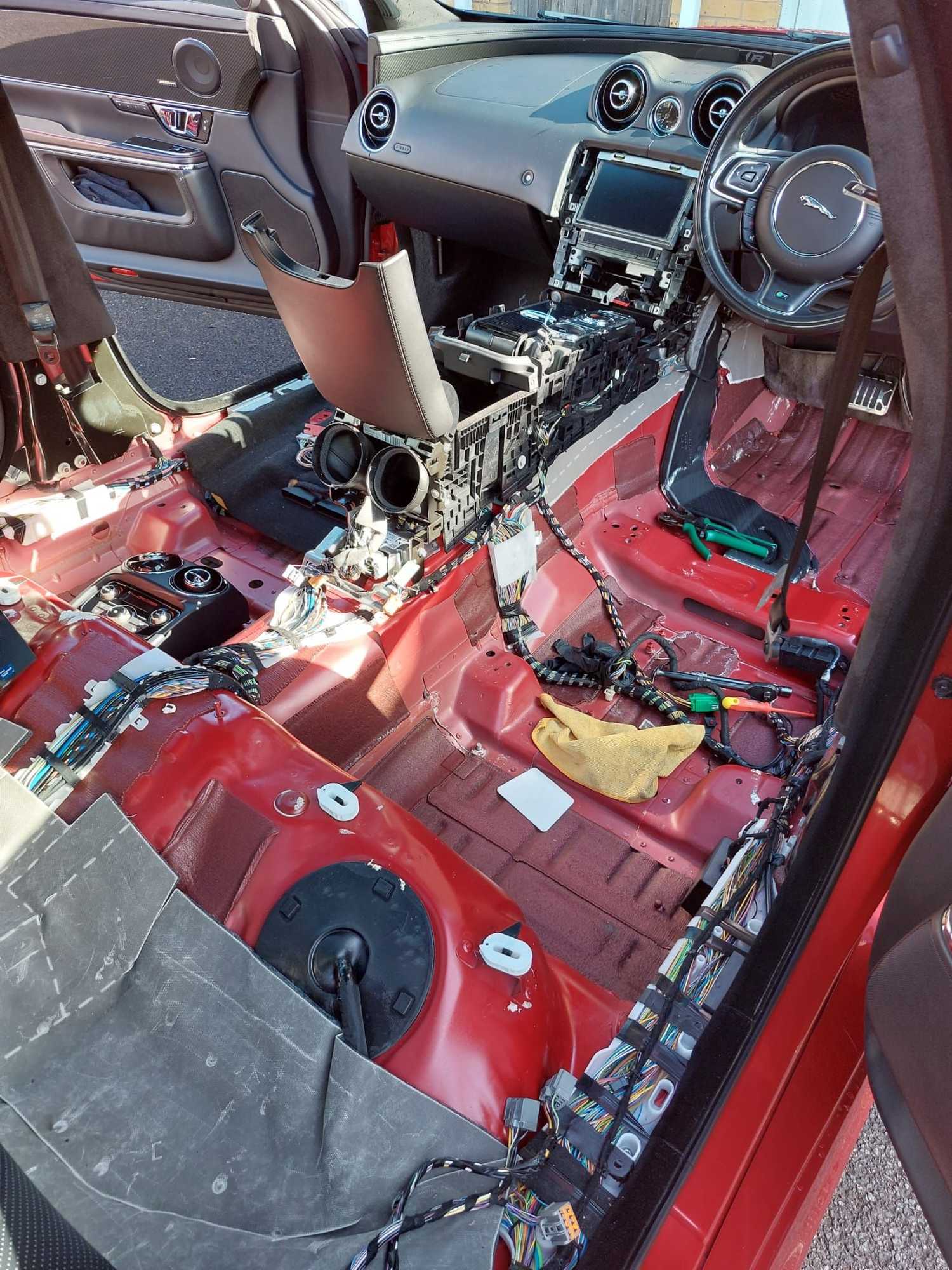

So, I found the leak. The bulkhead grommet was off!! The previous owner had a tracker installed when he bought the car new, I assume they didn't fit it correctly and over the years it moved. It was a pain in the *** to push back, but with some grease and pushing through the wheel arch (had to completely dismount it) I could put it back, and I also sealed it just in case. After 2 weeks for the carpets to dry, I put it all back together, it was a big job but I'm happy I did it on my own and fixed it:

Oh goodness, that's a lot of disassembly. Great job on the DIY fix. I'm a bit disappointed by the lack of even paint coverage in some of those interior areas considering this was a six-figure car when it was new.

Hi, nice job but the photo doesn't show where that loose grommet is. Can you zoom out a bit to show us?

Hi, the gromet is just behind the throttle pedal, it´s the only one there is on the driver´s side and takes all the harness that runs on the right side of the car.
