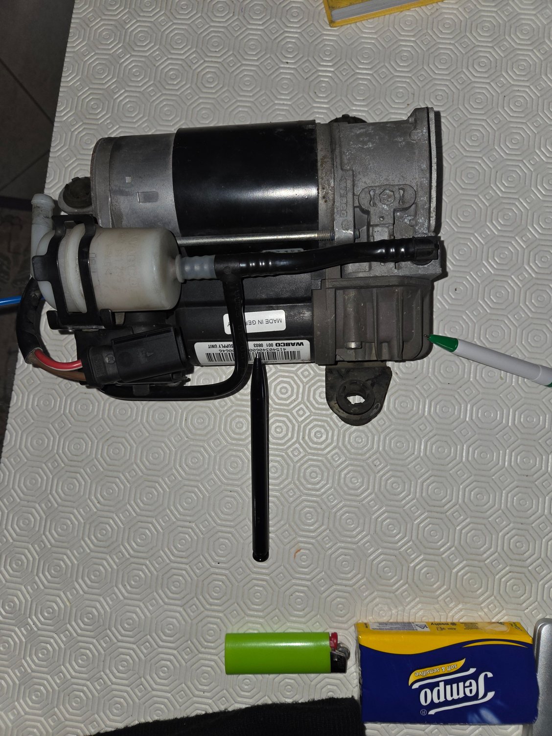

At the compressor you have the compression part where you can exchange the piston ring ( with the green white pen. Bagpipingandy referbkit
at the black pen there are desiccant beads inside that can be exchanged or dried in an owen or microwave. But since the car is in texas now they shoud be dry. If they are humid this alone can cause problems in the (esp )valveblock.

You will find the beads soaked and the compressor full of water. I live in Texas and that's what I found when taking the air compressor apart to install the new piston ring.

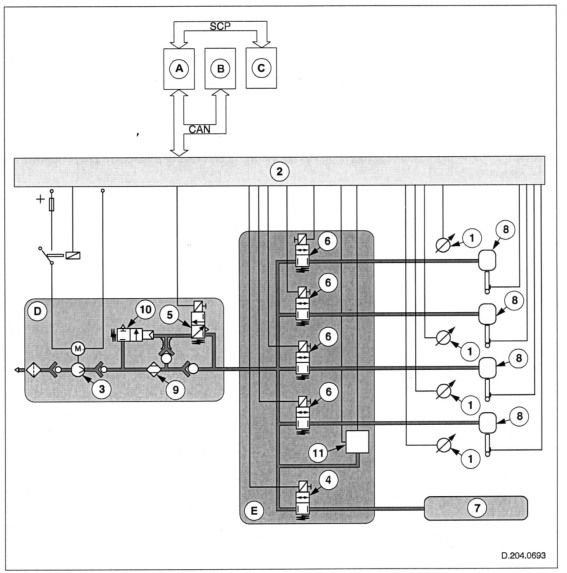

The compressor has a mechanism to get rid of humidity. There is no water or corrosion in my compressor or valve block normally.

@wfooshee. You're not right, as these lines from the manual show:
Speed Lowering Mode The speed-lowering mode is a function of drive mode: – When the vehicle maintains a speed of 160 km/h (100 mile/h) or above, and 10 seconds elapse, the suspension lowers 15 mm below the standard ride height. – The suspension returns to the standard ride height when the vehicle speed decreases below 140 km/h (88 mile/h) and 5 seconds elapse.
Rough Road Detection The ASM inhibits the speed lowering function when a rough road surface is detected; the vehicle is raised to the standard ride height to ensure passenger comfort. • Leveling Inhibits The ASM recognizes significant cornering, braking and acceleration actions and inhibits suspension leveling during these periods.
• Inclination Mode The ASM activates the inclination mode when the vehicle is parked on an uneven surface for example, with one wheel on a curb. If the ASM detects what is effectively a sufficient twist between the front and rear axles, the axles will be leveled as a pair. This avoids suspension leveling when the vehicle is moving away
If you attach SDD while driving, you see the CATs controlling height and stiffness. It's the combination of this, what makes the X350 ride in perfection.
Rough road is not an offroad feature, it's used in parking garages, when the first bump is recognized and then the car softens like a baby swing.
Speed lowering is also important, as I often drive beyond 200km/h. The XJ feels like a flying carpet and still remains well connected to the road.
