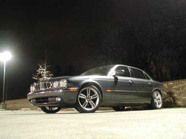

I installed those exact wheels on my 2005 XJ8L. Absolutely no issues. Tolerances are extremely close to the rear fender when suspension is compressed but no rubbing, braking or other issues. And they look incredible. Prepare for endless complements...

245 on front and 275 on rear would look ugly, I dont know how people would make complements about those wheels. unless you put some wheel spacers on the front.

04XJ8 - looking hot
Wow! Rather opinionated huh? Guess you think the XK is ugly then. HA
I loved the stance and wider rear wheels gave it an aggressive appearance. There would likely be rubbing issues upfront with spacers.
