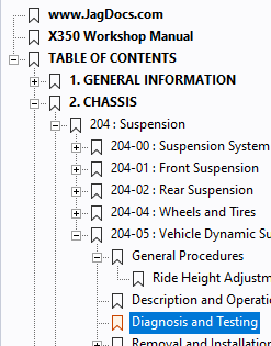

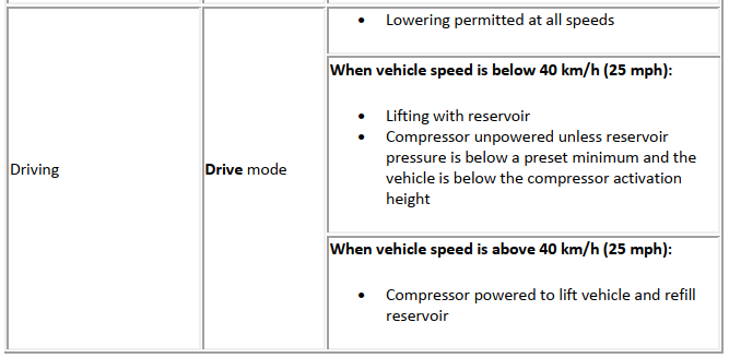

I will plug in a code reader and start the engine, hoping the pump will put air in the system allowing me to listen/look for a leak, but i read somewhere that the pump only activates over 40mph, is that correct ??
Old Jan 12, 2024 | 01:09 PM
Jaroslav Záruba's Avatar
Joined: Nov 2016
Posts: 401
Likes: 93
Old Jan 12, 2024 | 01:28 PM
Sierra1off's Avatar
Joined: Oct 2020
Posts: 8
From: Billericay
Thank you Jaroslav
