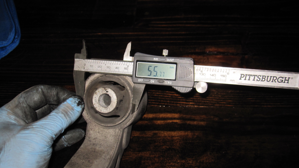

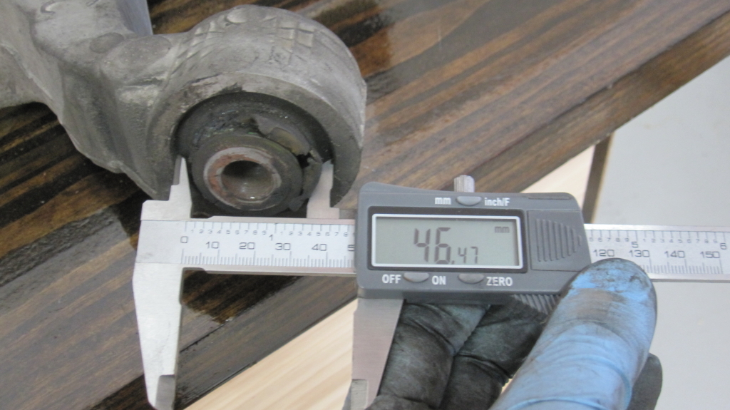

For your enjoyment. My goal is to source these things so that I can replace them.
This is the rear of the two bushings - length
This is the rear of the two bushings - outer diameter
This is the rear of the two bushings - inner diameter

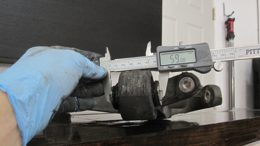

This is the front bushing - It is 59mm in length as opposed to the rear one which is 54mm. Outer and inner diameters are identical to the rear one

The key dimension is the distance between the two inner spacers on the bushes. I think it is 280mm, but check before pressing out.
The X308 rear suspension is completely different as I understand it, and bushes are not the same on each of the two model series.

These lower rear arms have two "ball joint" type joints, and one "silentboc" type. The latter rarely if ever fails, although it will eventually need replacing, but nobody has yet found out when as far as I am aware. I would be wary of replacing the ball-jointed types with anything different. These joints are now freely available on the internet at reasonable prices. Incidentally, the XF and the XK and, I think, the later XJ also has these joints.They are made in their thousands. Use of very low profile tyres shortens their life IMHO, due to high frequency road-generated vibration not being filtered out by the tyres. The tyre walls are too stiff to do this.
