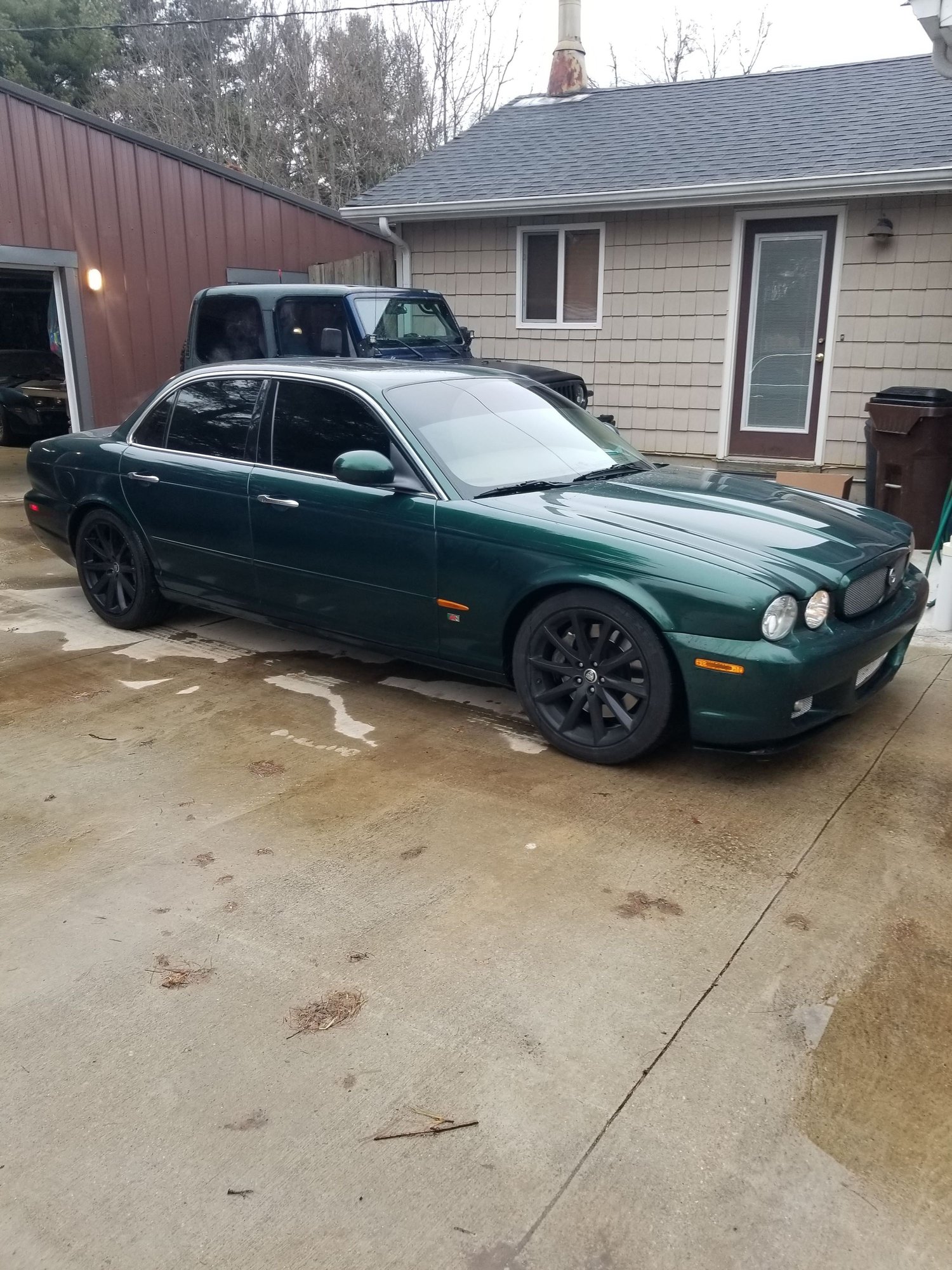

My 05 XJR has X358 front and rear bumper covers, the grill was modified to look like the X358 grill.
