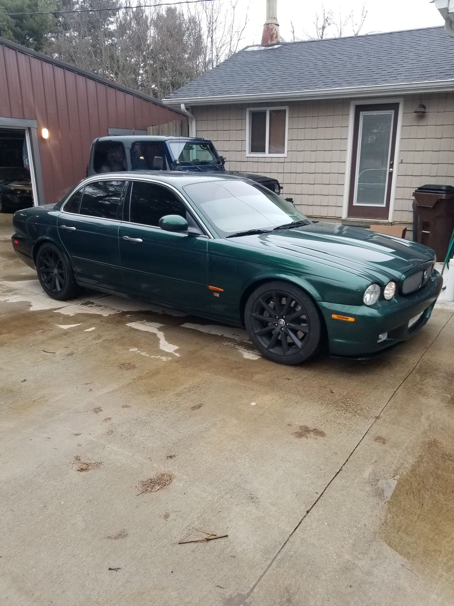

Originally Posted by Wooford XJR
I replaced my Cats Suspension on my 05 XJR with a set of used struts from an S-Type. I unplugged the ASN Module from behind the back seat. Lights are out and no regrets. The car sit about 1/2 inch lower than stock which I like.
hi there, height looks good. Iam also thinking of using the s type struts for mine, how was the fitting? Is there any modification to the vehicle for these struts to fit? Or is it a straight swap ? Thanks
