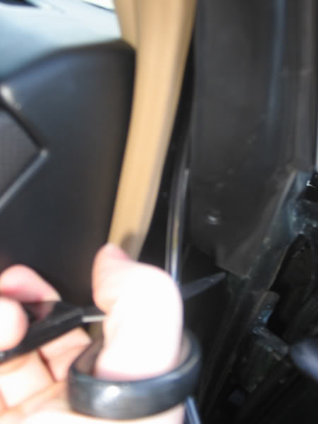

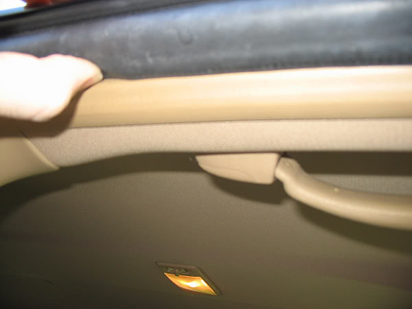

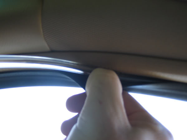

Here's a few pics of my install.

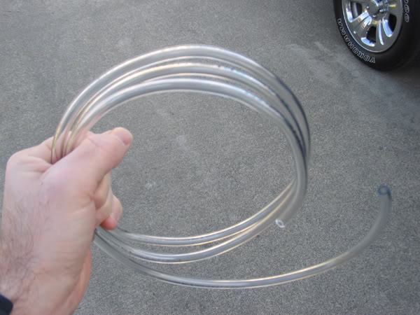

The tubing...
Starting at the rear of the door...

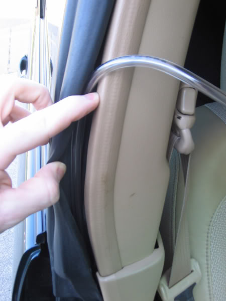

Continuing to pull out the rubber and insert it around the top...
Cutting it off at the end...
Tucking in the rubber...
I took a video clip with my phone while on the freeway I hope to post soon, although I didn't take a before clip so it might be irrelevant.

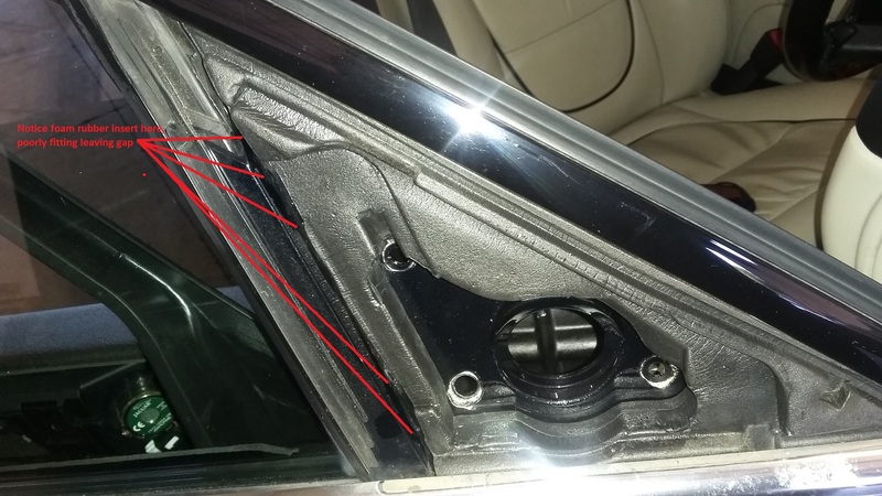

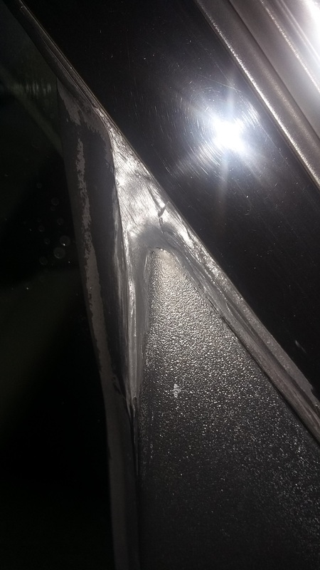

Again, another car forum, but this is on the mirror housing and could be part of the problem?

Option 1
The tubing...

- first, test with the ever-ephemeral grey urethane, specifically the solid round 'caulk saver' stocked in rolls of several diameters at Big Box in the weatherstrip section. Cheaper and 'springier'.
If it shows signs of working at all (I don't expect it to do..) then we'll search for EPDM 'rod' or tubing to replace the urethane.
That clear Tygon is not very stable or durable for applications of this sort. Highly likely to get stiff(er), shift the load to the costly custom seal and fail it sooner.

I'm leaning more towards the mirror housing and that area as a possible cause, however.....

I've also included a tsb for wind noise from the mirror housing, albeit this is for the S type if memory serves, but may still apply.
Dougie at Prestige is obviously aware of this as one of the first things he mentioned was taping that area ( as per the tsb ) and seeing if that made a difference

I have a little wind noise from the driver's door mirror area too, and I wonder if the procedure in the S-Type TSB might work for the X350 and X358. I haven't had a chance to give it a try, but perhaps it might be helpful to your mechanic:
http://www.jagrepair.com/images/TSB/...nd%20Noise.pdf
Cheers, Don
Cheers, Don
But the fun goes on as my daughter gets married this weekend too, so the madness continues....
Anyhow, did a few miles today and had cause to get some pretty high speed runs whilst it was windy and REALLY paid attention.
I swear blind its the mirror housing seal 100%
Check out the tsb and look at illustration 1
As I was driving and the wind noise was elevated both due to high winds and speed I pushed against the glass at the mirror housing area, jamming my fingers / knuckles into that area and the wind died down considerably.
Once I have time. I'm going to revisit Prestige and ask them to carry out the procedure as per the tsb and see what it costs and advise results

Okee dokee, finally have a fix at least for the door mirror housing wind noise
Took the car in to to Prestige today and took the door card off to investigate, I was correct, the door mirror housing area is where the wind noise eminates from.
Firstly and as pointed out previously, the external mirror seal is poorly fitted ( or so I thought ).....On checking several other cars of the same type, year etc they are all absolutely identical. I would therefore imagine that you all have the same poorly fitted seal on the exterior of your cars too.
Taking the door card off, then removing the mirror seal and finally the mirror itself, reveals the interior foam / rubber seal.
This also is poorly manufactured / fitted and leaves a substantial gap around the housing, hence the wind noise, see pics below.....
using black silicone sealant we filled this gap internally and then adjusted the seal as best we could and buttoned it all back up, reinstalled the mirror housing, seal and door card
We then added black silicone sealant around the exterior seal, filling the gaps there too for good measure.
Road tested ( at considerable speed, triple digits for good measure ) and bam, no wind noise from that area, now totally eliminated
Also ordered 2 new front foglight surrounds, the chrome strips are tired and chipped after many thousands of miles and beyond refurbishment. I'll pick them up in a few weeks time as I intend to book her in for a front end paint job on the bonnet, bumper and wings soon
