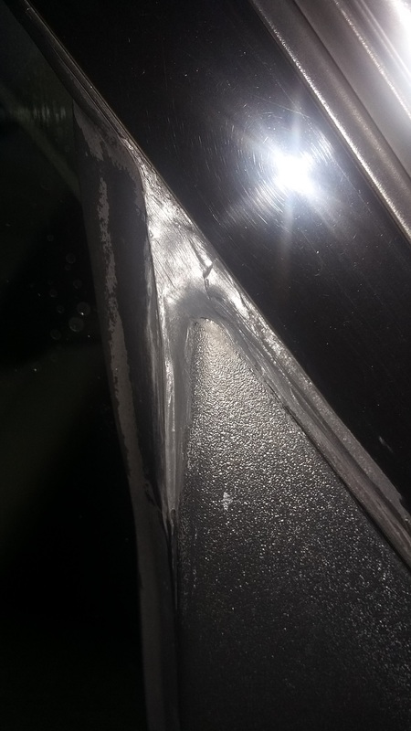

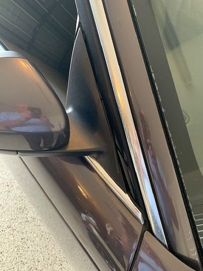

I have a 2008 XJ with the rubber deteriorating around the forward end of the door mirrors.
The pointy ends that JimC64 posted up thread.
Mine look like this;
Close up;

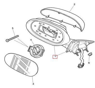

So I think the seal posted above is what I need;
I have been back and forth in the JEPC and looked at the door seals also posted above. But no where could I find that triangle shaped one?
Anybody know where to look?
Am I looking for the right seal?

I wonder if that triangular seal comes with the mirror? The parts catalogs don't seem to list a separate seal. You might call a Jaguar dealership parts department to see if they can track down a part number for you.
Jim filled in the gaps around his seal with black silicone, which may be the only option short of purchasing a new mirror.

I thought of that and it might be so BUT the JEPC has the mirror assembly and does not show any gaskets?
So kind of stuck on where to look?
Maybe I will use black silicone and trim all the loose stuff off and cover the remaining damage?

The gasket is part of the new mirror assembly, at least it was when I bought 2 new assemblies 4years ago.
