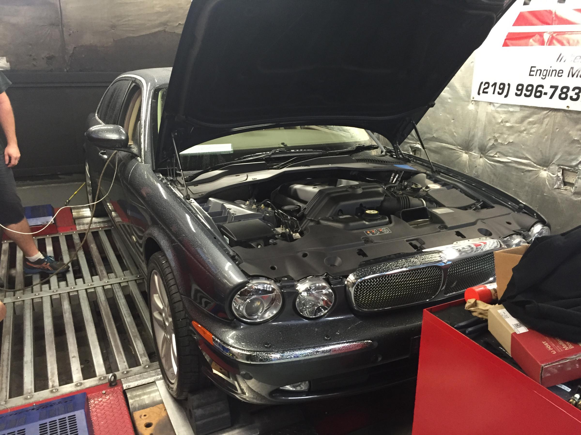

Everyone want's dyno results, so here they are, before and after;
These results are only what you get from 3500rpm to redline, dyno's cannot show results lower than that because of the car always kicking down a gear.
Anyhow, it's a small gain in the top end. There could be more by adjusting the fueling in the upper rev range; as you can see it's still quite rich. But from Sid's point of view, he's happy with the overall outcome, and the time/effort involved to chase another 5-10hp is hard to justify, since the car is a cruiser, not a racer. For a cruiser it's more about low-end torque, which you can't see on the dyno.

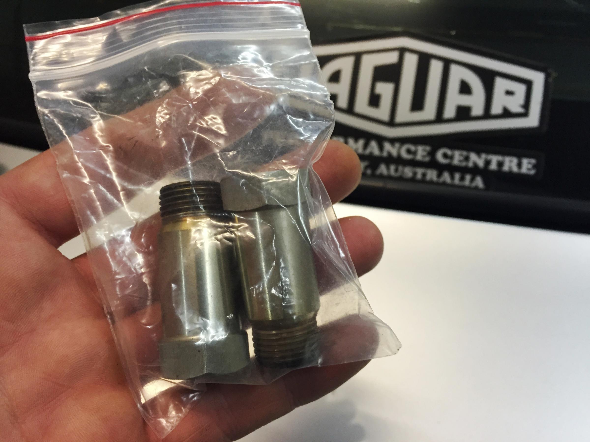

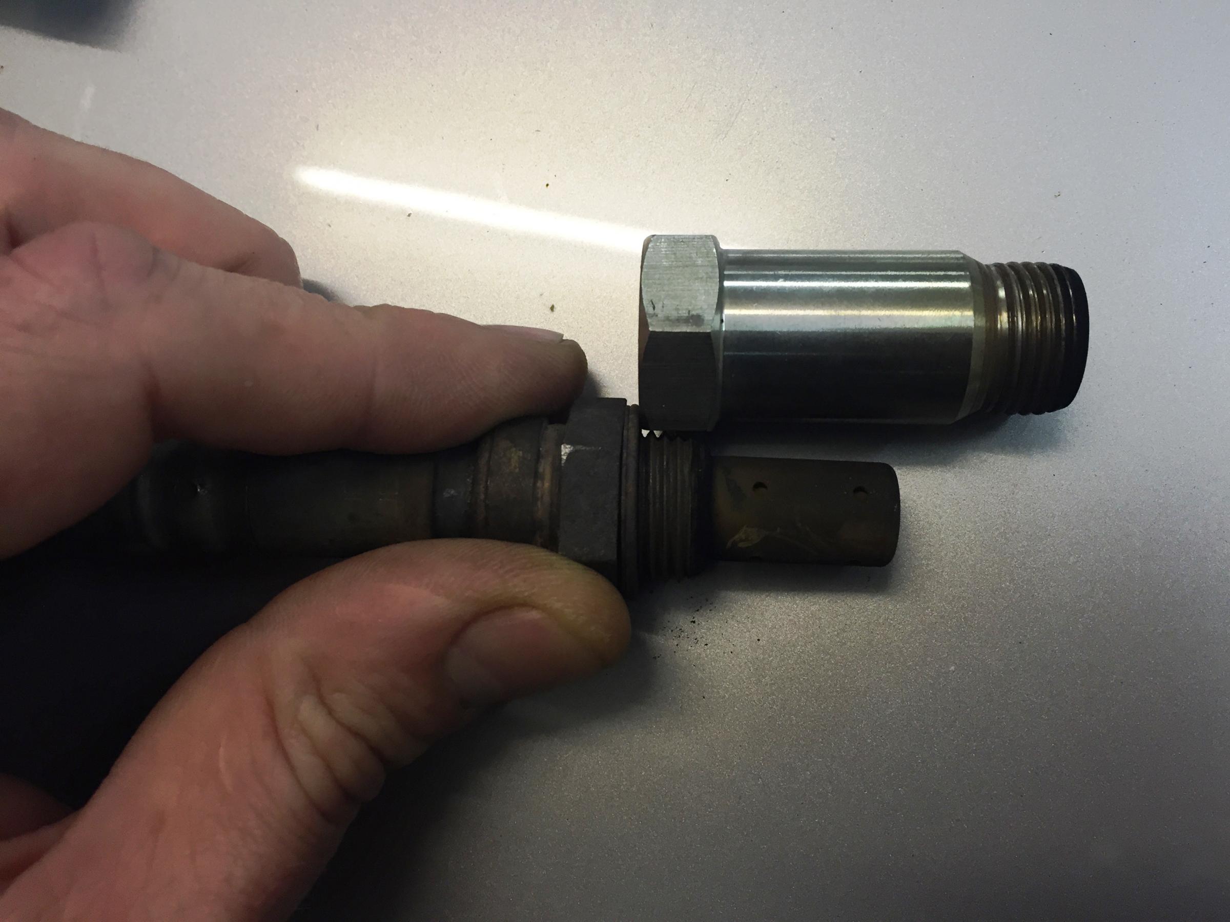

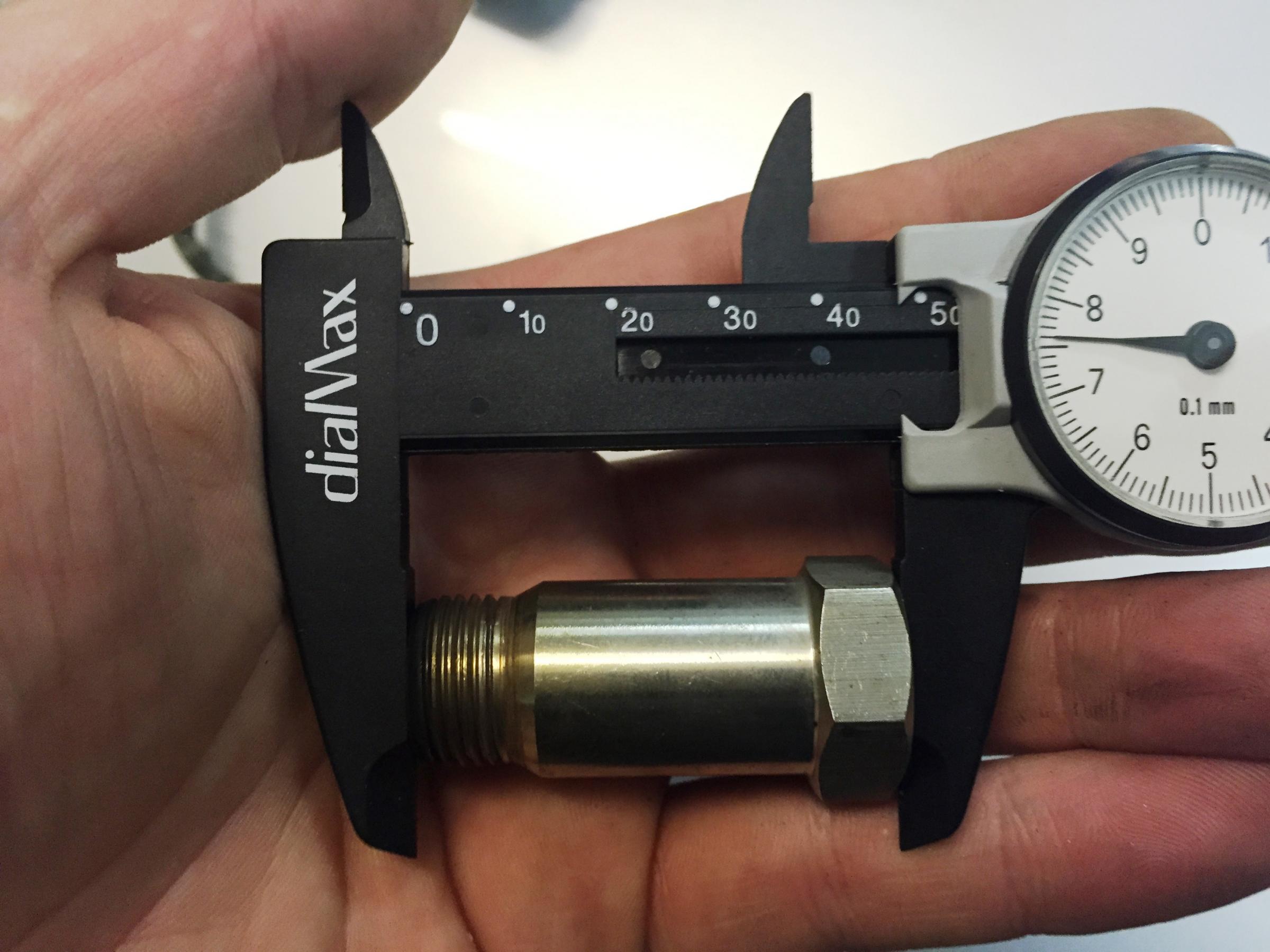

Just for interest sake, here's some pics of the minicats that came off the car;
You can see that what they mostly do is take the sensor out of the gas stream, acting as a spacer or stand-off. You no longer get gas flowing directly though the sensor. On some vehicles a spacer or stand-off is enough to stop the CEL coming on, but not on the Jags. The difference with the minicats is they also have a small catalyst in there (you can see the honeycomb substrate) and that's just enough to clean the gas & trick the sensor.
But no longer needed

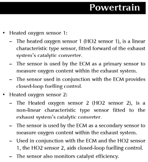

As I understand it , in closed loop mode the the H02 1 sensors or as we call them OXYGEN SENSORS , communicate with the fuel injectors via the ECU , so if it's running to rich , the injectors will back off the fuel amount or supply more fuel if it's too lean .
So in open loop mode the communication is broken so as not to lean out the fuel mixture when the engine is cold as naturally the engine needs more fuel when it's cold .
Given if that is the case , I always thought that the H02 2 sensor was not really that critical for fuel consumption/economy .
But like I said , you learn something new every day on this forum :-)

Closed loop is when the fueling is calculated by the ECU based on the Air-Fuel-Ratio, as determined by the O2 sensors, with the Jags it's both the upstream (before cat) and downstream (after cat) sensors which provide these measurements. Closed loop is when the engine is at operating temperature, and not under too much load. For example while you are cruising on the motorway at light to moderate throttle.
Open-loop would be when the ECU is running off the fuel tables only, for example at wide open throttle or high load, although it's still monitoring various sensors (upstream O2, knock sensors, & others, but not downstream O2) & will react if there is an abnormal condition.
So when you were cruising down the highway in closed-loop, the measurement from the downstream O2 sensors that were fooled by the minicats was not in harmony with the measurement of the upstream O2 sensors, so the ECU responded with a more conservative (i.e. rich) fueling as a precaution because it was getting conflicting information from the upstream and downstream sensors.
By removing the minicats so the downstream O2 sensors can get an accurate measurement, the ECU can provide correct fueling for closed-loop operation. And by disabling only the "catalyst efficiency" function of the downstream O2 measurement, you don't get the codes / error messages.
The open-loop is not really affected by the "false" downstream O2 measurement when the minicats were fitted, as it primarily is determined by the fuel tables, and readings from other sensors.
So to perfect the tune in your car, there is still some tweaking to be done for open-loop / WOT that could release some more HP in the high rev range. This would not have any effect on the closed-loop running of the car, i.e. low-rpm, part throttle, highway cruising, etc. But if you don't need/want it, it's really no worse than a standard tune at full throttle now.
Well that's how I understand it anyhow...
