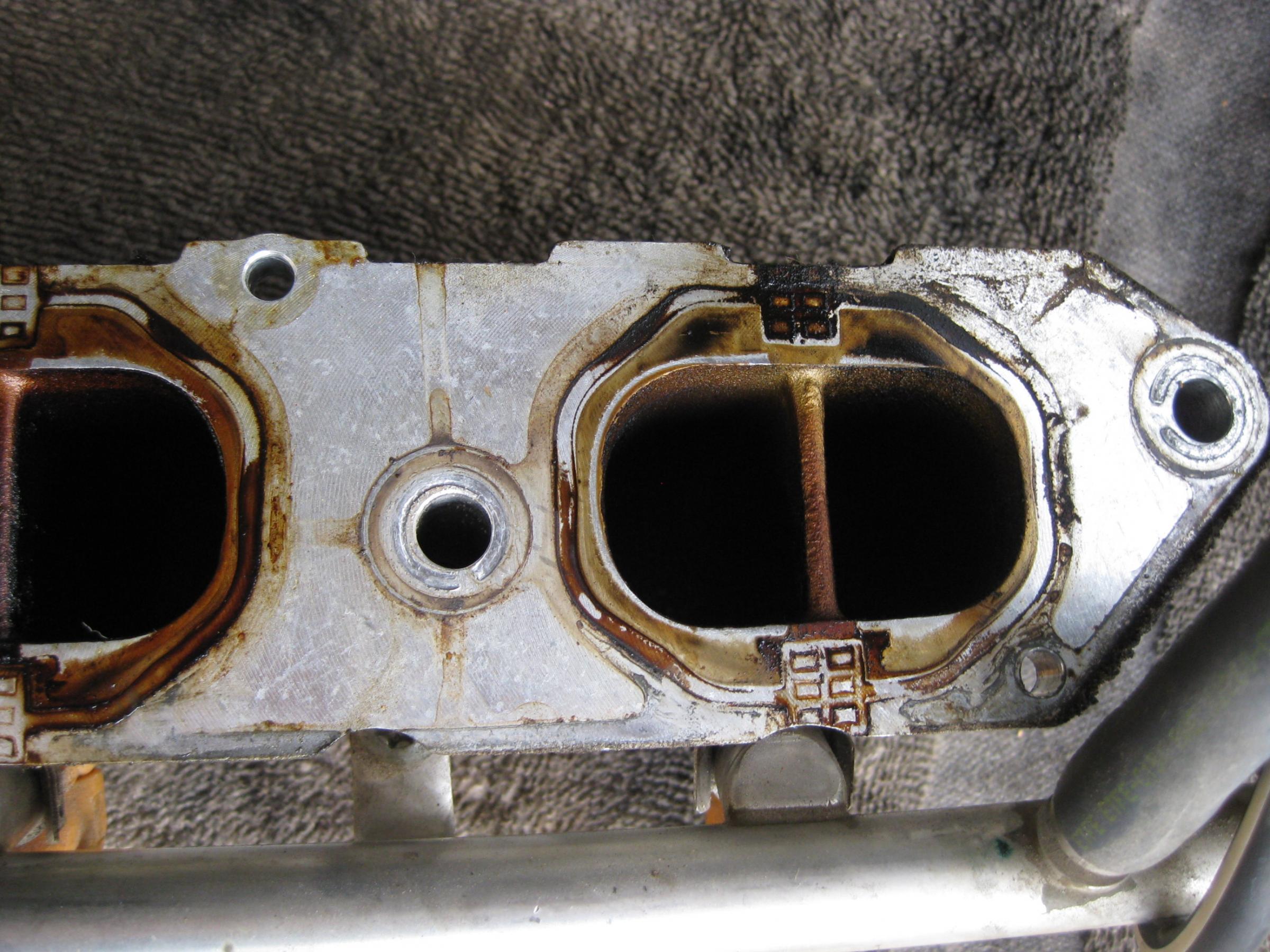

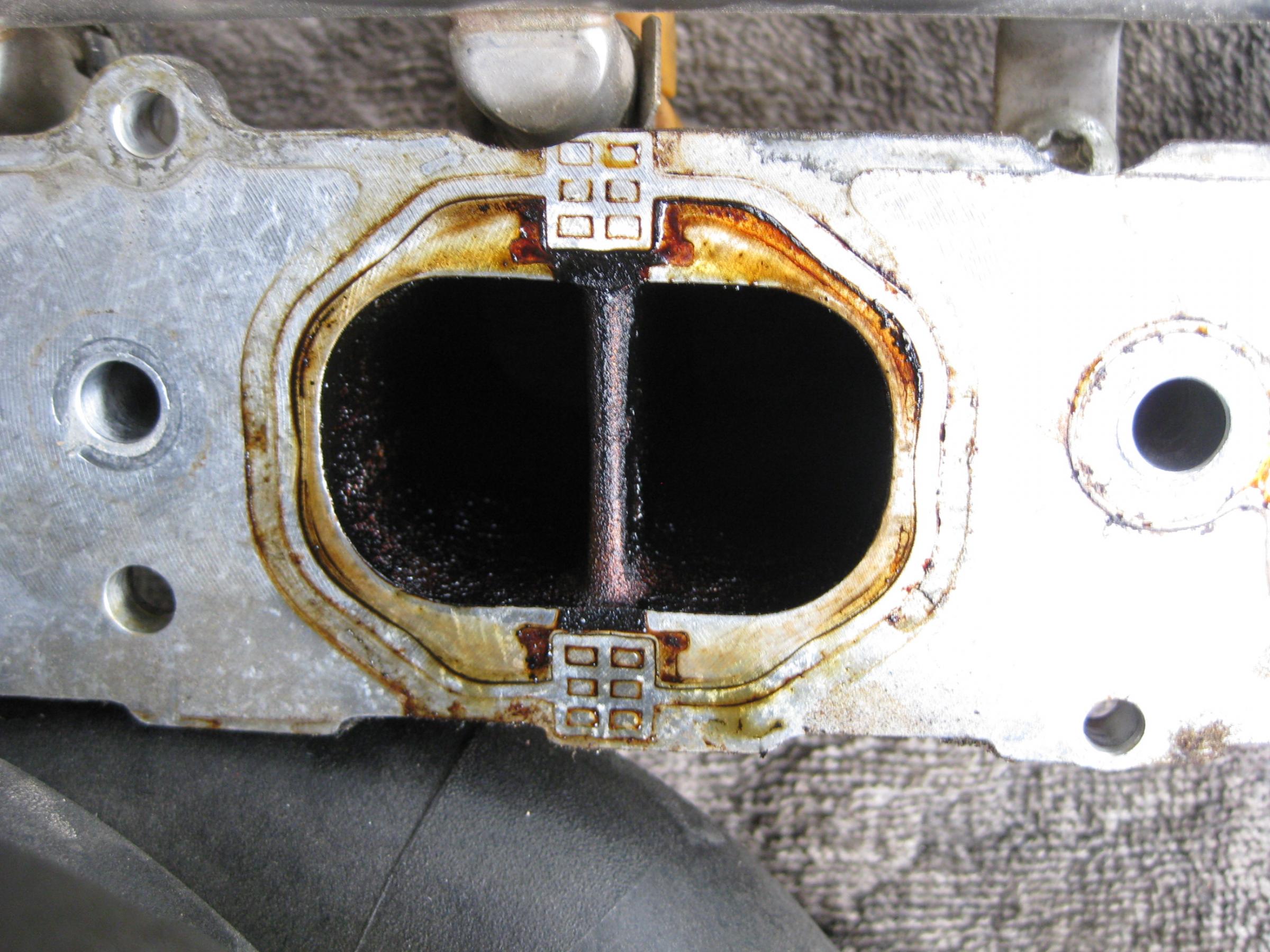

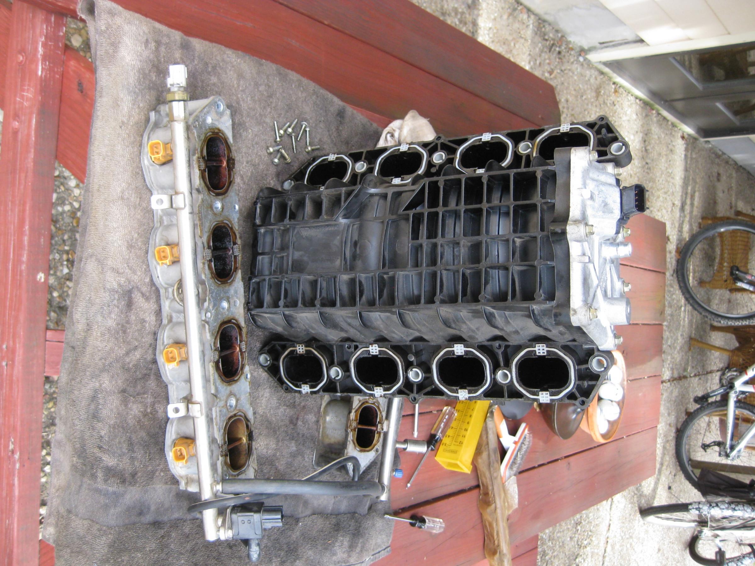

image 6006 shows plenum disassembled from aluminum intake parts. Image 6007 shows close up of "o-ring" style gaskets. Image 6008 shows leakage spots "printed" on front passenger side port. Image 6009 shows port where no leakage is visable.
I have reviewed many posts concerning P0171 and P0174 bank 1 and bank 2 lean. Often intake manifold gaskets are referenced. Smoke test revealed leaks in areas I have indicated but I have not heard any other discussion of this in this forum. It is hard to imagine that someone else has not seen this. My local (Austin, Tx) Jag dealer says they have seen this many times but have to sell customer new manifold as o-ring gaskets I showa are not available.

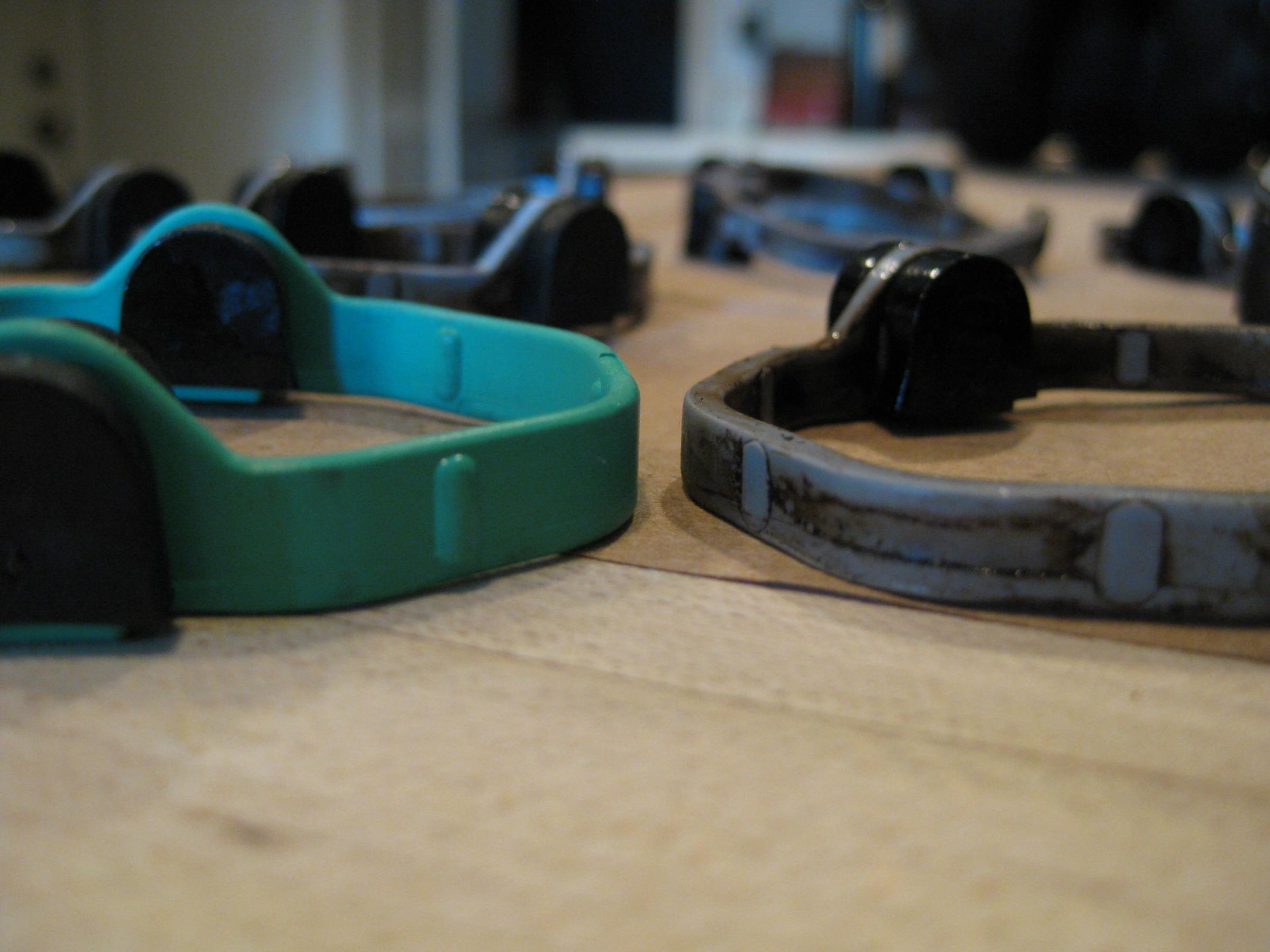

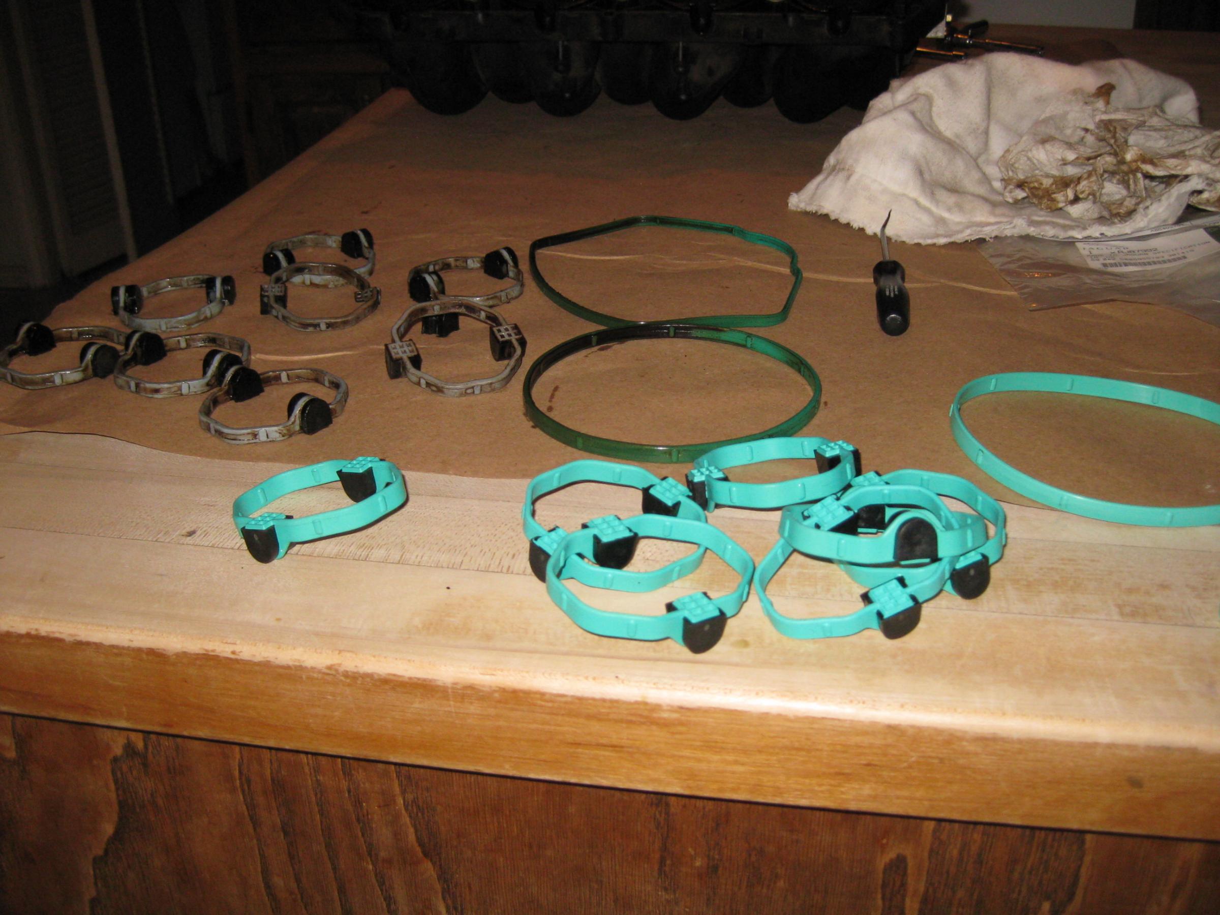

I purchased oring seals for plastic intake to aluminum intake adapters from Euromarque in Houston, TX ($200). I spoke with Ed Harrison there and he was able to get me a set of 8 gaskets out for 2nd day delivery. I did not find any other source for them in the US and Rimmer in UK did not have them either. They arrived and I immediately noticed that they were significantly thicker than the old dead tired ones as shown in attached photo. Completed assembly, even had the Mrs. help me lower assembled manifold in place to make sure not to damage steel gaskets. Once complete, it fired right up. After a few minutes I connected to ScanXL and was delighted to see short term fuel trims at -25%. Continued to check over the past week and long term fuel trim has stabilized on both banks to about 5% and short terms both bouncing around zero. MIL remains off and Monitor Status complete. As earlier pictures show, my old orings showed various degrees of leakage. My suspicion is that a lot of vehicles out there suffer from this affliction to some degree. Just wanted to let everyone know there is another option besides a new $1500 intake or a used intake one that may soon start having the same problem.
By the way, I lubed mine with clear silicone grease as I noticed that old ones appeared to be installed dry. After 10 years the dry orings had small dimples adjacent to gasket side ribs. It appears as if ribs stick to side of gland and restrict oring over time. I hope clear grease may prevent this in the future.
