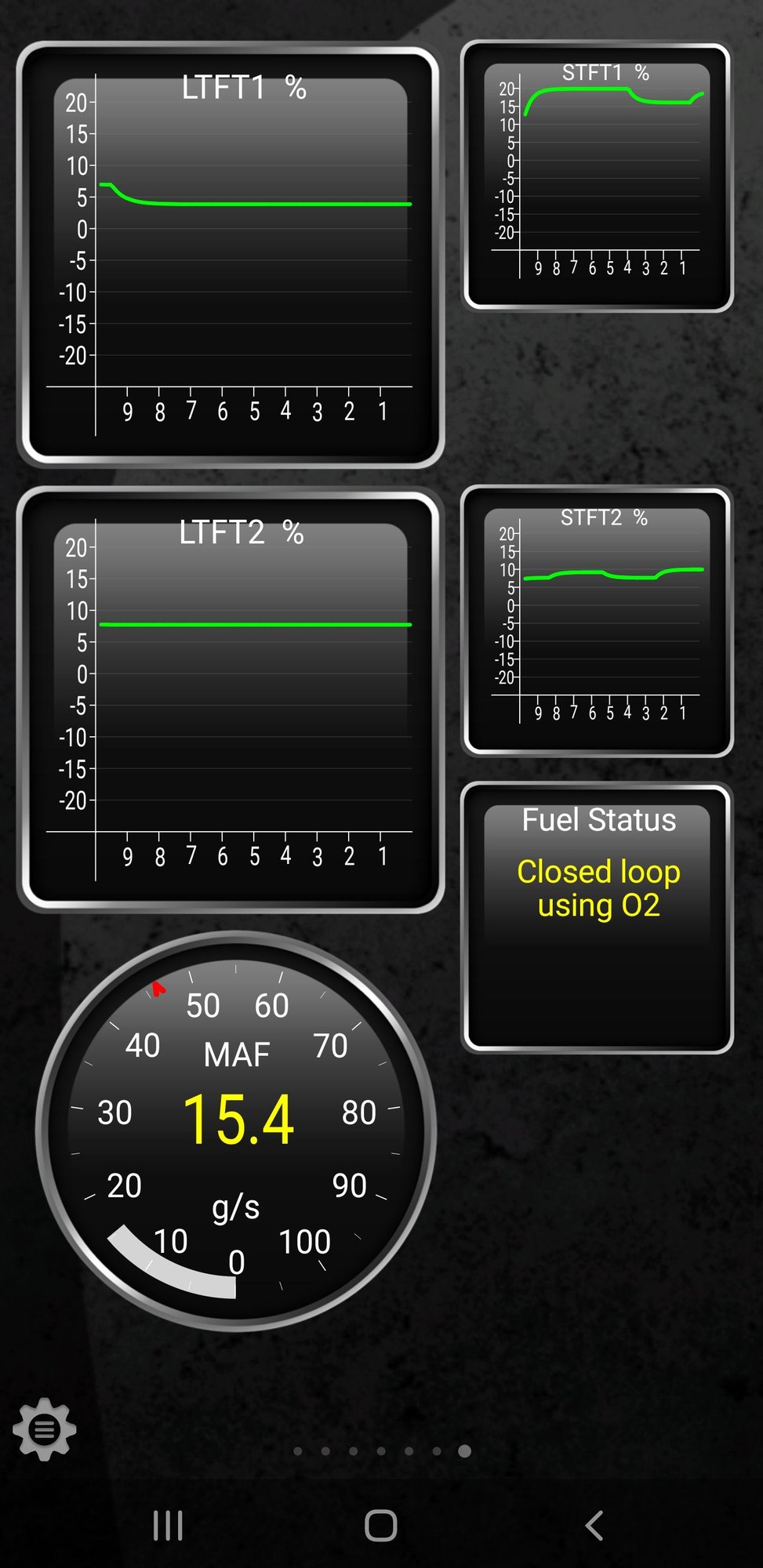

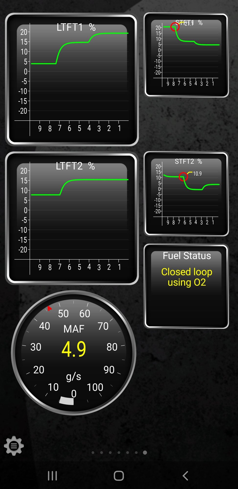

Here's a few screenshots from Torque.
Idle RPM
2500 RPM

If you can get an inexpensive smoke machine, they can speed your leak finding greatly. I had similar issues in my LR3 (naturally aspired Jaguar AJV8 engine) and the smoke machine found multiple cracks in the plastic intake components that were the source of my issues.
For the XJR, I would use a smoke machine this way (engine not running of course):
1. remove the MAF sensor
2. cover the air filter in plastic wrap and reseal the airbox
3. put the smoke source plug into the hole left by the MAF sensor
Some smoke will leak out of the plastic-wrapped filter, but this approach worked for me with the Land Rover.

Spray some brake cleaner or carb spray on the throttle body where the power steering vacuum line comes in if the idle changes and the fuel trims level that's your leak causing your lean codes...
