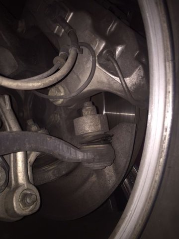

I recently bought a X350 2003 XJR. The car is from a deceased estate and stood for a few years. It has only covered 48000km to date. I had it serviced, alignment done, new tyres put on and one or two niggles sorted. It really is like new and have had offers from other Jag owners to buy at double the price because of condition and mileage....except that I discovered certain suspension rubbers are perished from age.
My Jaguar dealer feels that it is not necessary to replace any of these as they say there is no "play" on the suspension. I am thankful to not spend more at this stage but at the same time I am worried that it will not be good in the long run. Any advice would be highly appreciated?

This is a VASTLY common issue on these vehicles. Agree with your dealer, if there is no play then there is no need to replace the parts at this time.
Rear sway links, rear tie rods, and front tie rod ends are available from the OEM manufacture (Lemforder). The rear lower control arm bushings are sold aftermarket from a few sources and will save you the $500/each of the complete arms.
Search around this forum, there are many threads on this topic.

Ball joint rubber boots (as on your track rod ends), can be bought separately and replaced. There are internet suppliers for these but you have to measure up the ones that are failed to be certain of getting the right ones. Some suppliers diy kits for a range of known makes so you don't have to measure them. The rear anti-roll bar link ball joints have similar boots, but are smaller.
So get internet surfing !
The perished outer rubbers on the wishbone bushes don't affect their operation, but wear will be quicker than if they were not perished, as water and grit can get in easier.

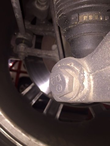

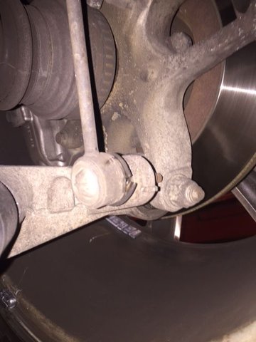

I purchased a 2096 XJR with 99,000 miles. It looked great until my mechanic showed me the rubbers.
The sway bar links are totally disintegrated. The tie rod and ball joint boots cracked.
Ordered bushings for the front lowers. The curved one looks new on both sides. The front uppers, rear upper and lower, toe links, tie rod ends, and sway bar links were all ordered from either Rock Auto or an online Ford dealer in Florida. All arms are Lemforder, whether Rock Auto or Ford dealer sourced. The big install is next week. Expect it to go a long time. Will lube the boots with Krytox before install to prevent dry rot.
The rubbers on these particular suspension parts fail faster than any others I have seen. The rubber boots on my 2005 A8 and the wife's 2007 335i look perfect. I think they are Lemforder also.

I believe your 2003 XJ is a X308. The X350 model is the one that has problems with rubber deterioration.
None of the suspension bits are interchangeable. Al least none I have looked at.
These parts were used on S types, Ford Thunderbirds, and Lincoln LS also. I think the X308 Jaguar parts are exclusive to Jaguars.
I was shocked to see every rubber boot on the ball joints, tie rod ends, toe adjusters, and sway bar links cracked and split. Seemed like the car had been soaked in gasoline. But others have had the rubber failures, just maybe not every boot and grommet. The rubber parts on my wife's 2007 BMW look new.
